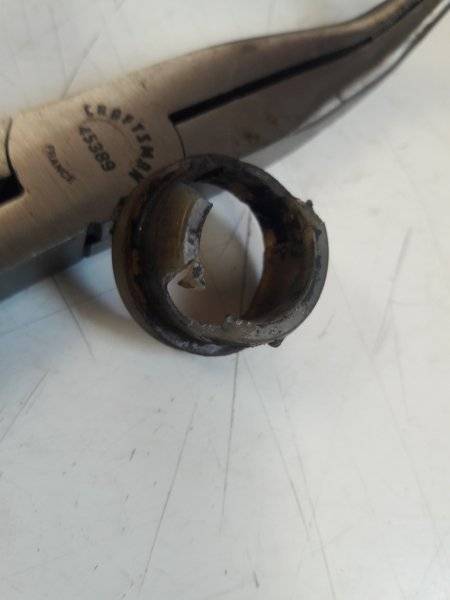

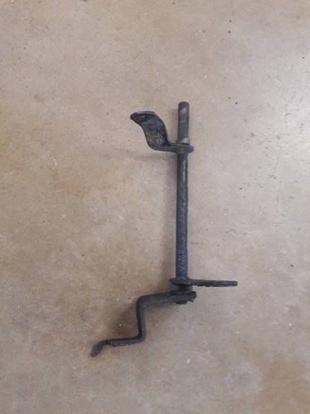

My 68 Road Runner is being temperamental with starting. Last night it would only start in neutral.
I see bits and pieces of broken shift bushings on the sill of the transmission. It looks as if the inner ring of the bushing has cracked.
Anyhow looking for help with part numbers and a source. The "Help Section" bushings at O'REILLY seem to be too small.
Thanks and have a nice day.

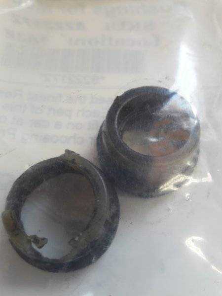

Thank you for the offer Mr Wagonman, but I already ordered from Partsmix. I needed the grill hardware kit anyhow, so it made the $10 shipping a little less painful. Appreciate your support.
Easy job. Hopefully this is the fix. Needed to be done.
