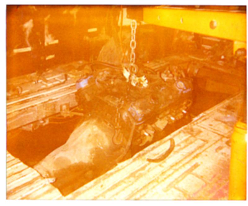

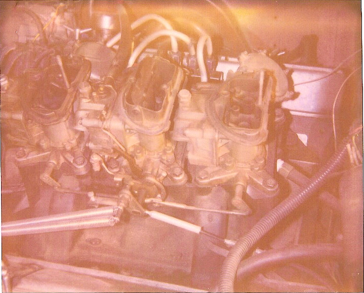

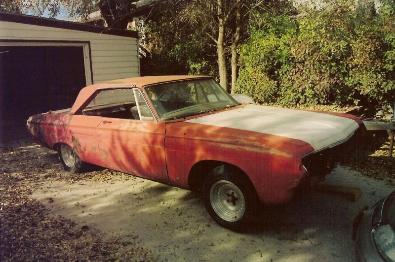

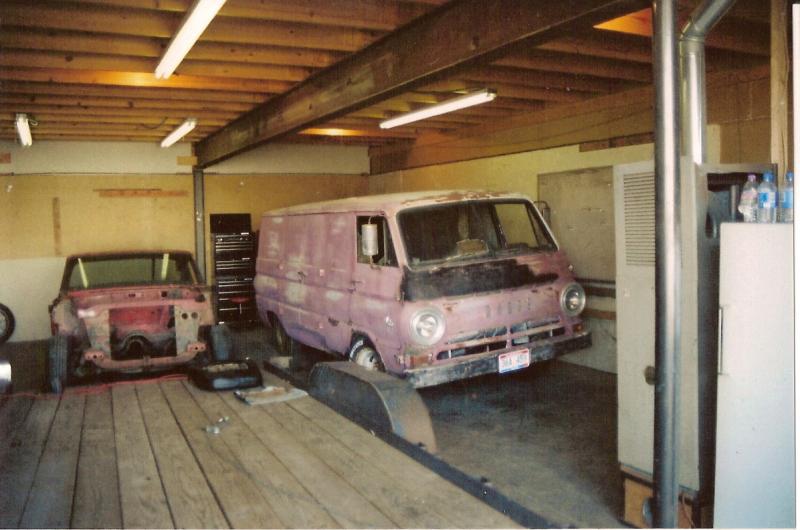

You asked for some pictures of my current drag car project so here you go. I'll try to keep this short since it isn't a B body. It is a '67 A100 van. It is being built to look like it was built in 1969. It will have a 513 cubic inch RB engine that looks like a 426 max wedge. The tranny is a 727. It has an 8-3/4 rear end with 3.91 gears and a spool mounted on leaf springs with ladder bars. I moved the front springs under the straight axle to lower the front about 4 inches. It will be candy apple green when it is done. The first picture is the mock up engine when I was just starting to build the motor mounts. The engine is moved back 18 inches and down 6 inches from where the original slant 6 was. The second picture is the van before I started on it. The last picture is the engine that I will be using to dial in the chassis. I also threw in a picture of my '64 sport fury that I hope to start on someday. It doesn't look like much now but it is a documented 426 wedge 4-speed car.
View attachment 149815View attachment 149816View attachment 149817View attachment 149818

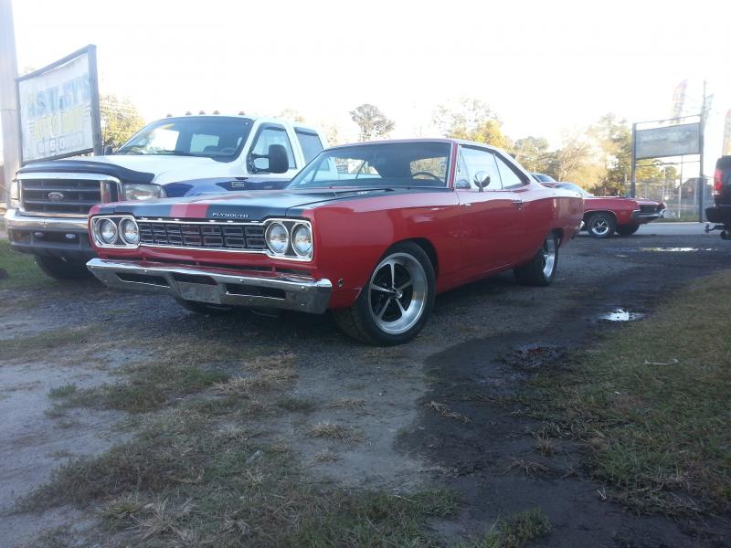

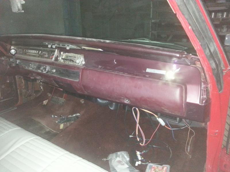

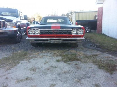

Well, I had to replace the whole rear. Got it back driving this weekend. I finished the dash tonight, installed the front bumper before the guys left. Then I installed the rt door trim. The cool thing about where I am now is everything I install looks better and better. Cant wait to get finished, patience is not my strong point. I noticed after I got the bumper on it looked even lower in the front. I also want to give a shout out to mike ferell the president of the mopar club here in savannah. He is one of the coolest car guys ive ever been around. Hes bent over backwards to help me with parts and advice. He followed me home when I bought the car and introduced himself. (Blessing in disguise) I owe him greatly.

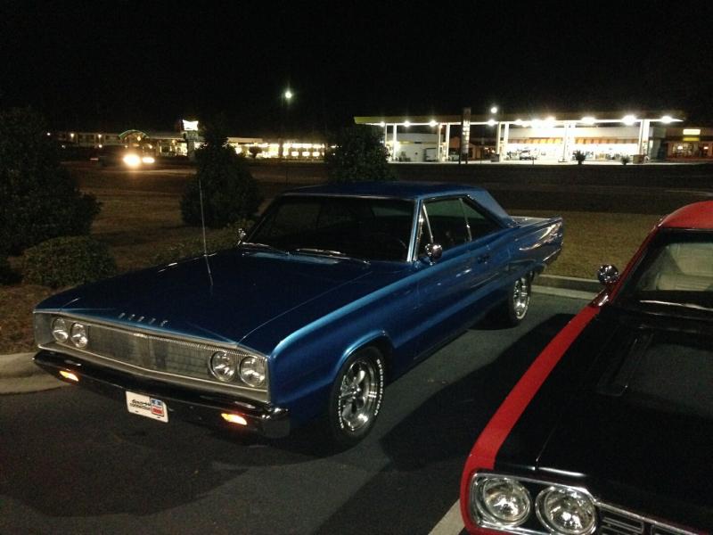

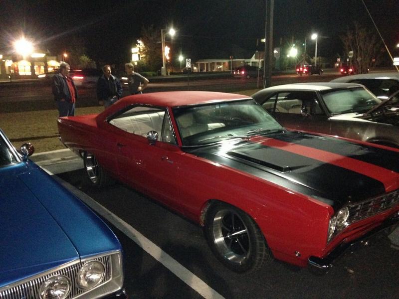

Put some miles on the car tonight, went to a cruise-in at dairy queen. Ice cream is my favorite food group by the way. The coronet next to me is mikes, the president of the mopar club. 440 with a 4speed. Really cool car.
