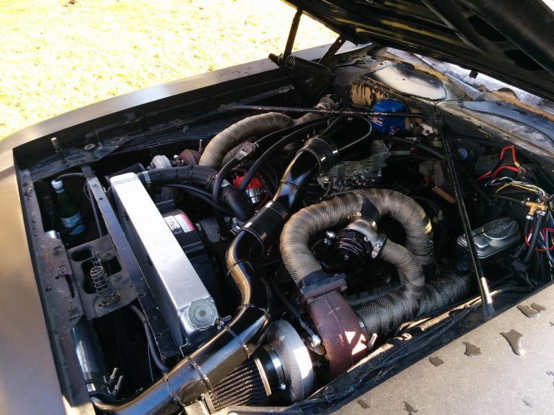

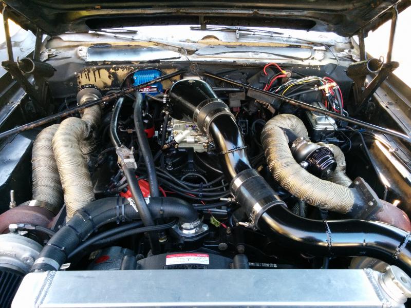

Here is where I am now, took these today,
In placing these turbs, I had a few things to consider that I wanted, your prioritys will prob differ,
1- I did not want to cut a hole in the stock hood, If I wanted to cut a hole I probably would have ended up going with a screw type supercharger or a blower.
2- Tired of working around the long tube headers I had before, wanted to be able to change my starter without pulling my engine so I could move the headers out of the way, and to be easily able to pull the headers, downpipes, and turbs out, with everything else still in place. Easier plug changes a bonus.
3- Daily drivable setup.
Dry enough out to get some traction, seems like boost starts building at about 2600'ish, Think I hit 5lbs at about 2900 but hard to look at guages when I'm driving. At this point, not sure If I would change much in turbo placement if I had to do it all over again. The 73/74 roadrunner hood has lots of room, and I made use of a lot of it. Had It so I could remove the valve covers, but after wrapping the headers they are a bit tight to slide off, I just hammered the cover a bit flatter and it went on ok. Prob would change where I put the drivers side BOV though, minor detail though.
Anyway, I will update my thread, so I don't clutter yours up. Yes, In Vancouver BC, No Prob if you wan't to meet up sometime.

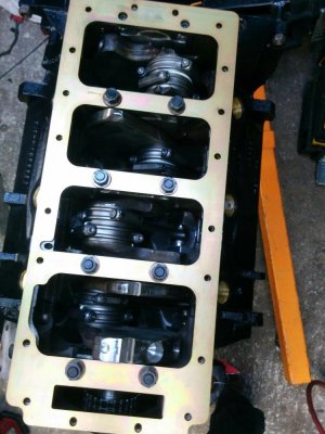

Did't mean for the last pic to get in there, but that's a 440 source girdle, on the 440 engine I am running now.

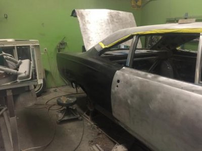

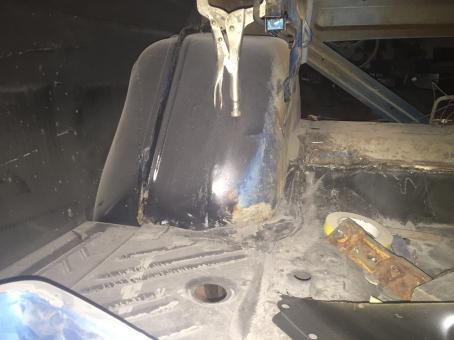

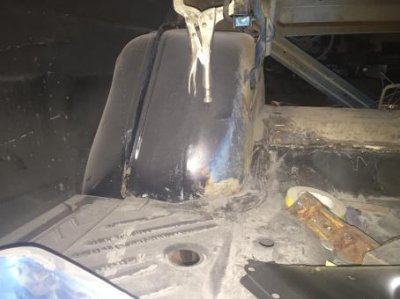

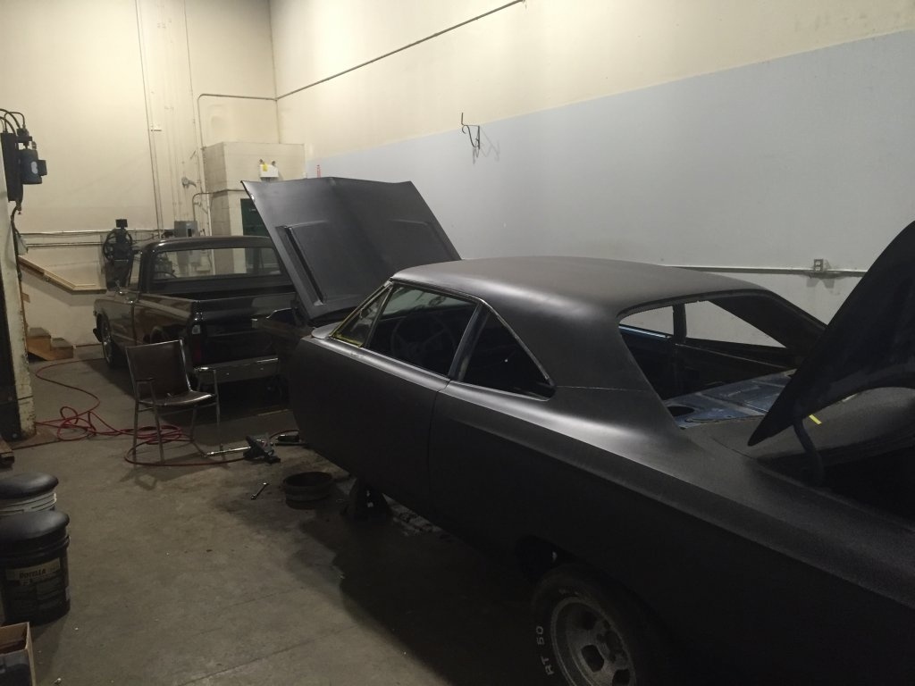

Heres the newest progress, passenger quarter is on and mini tubs are welded up.

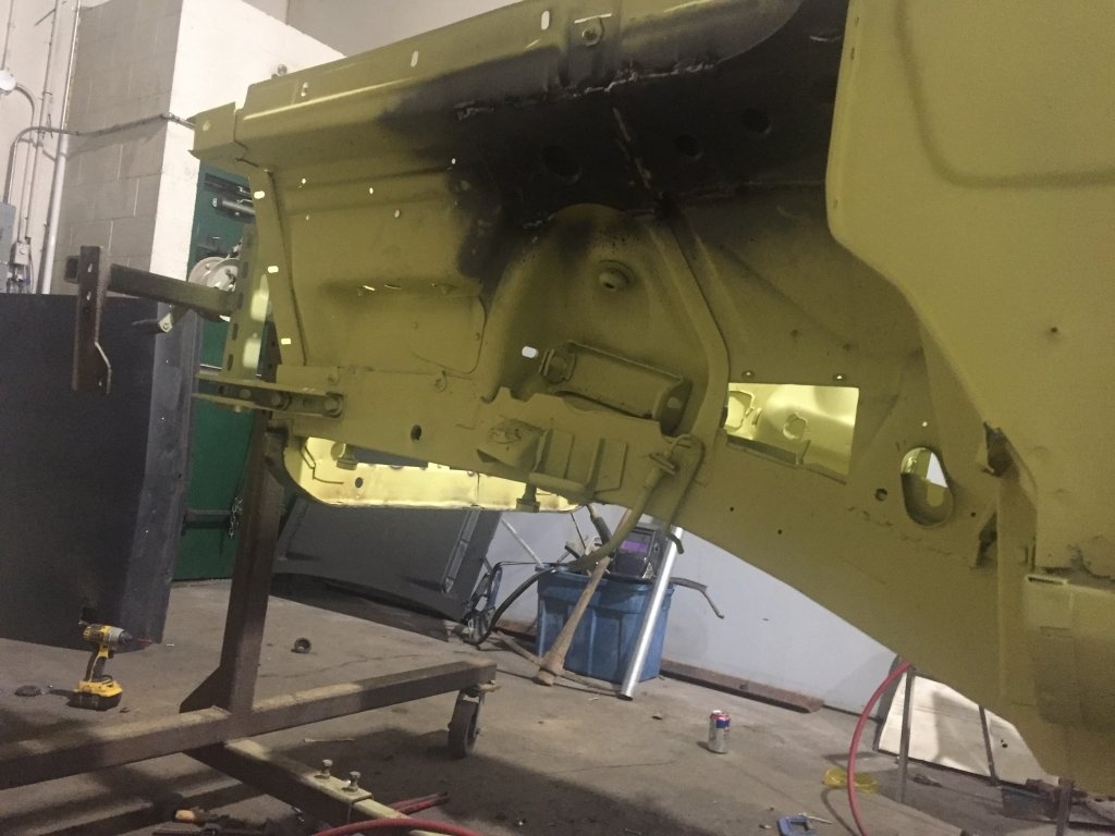

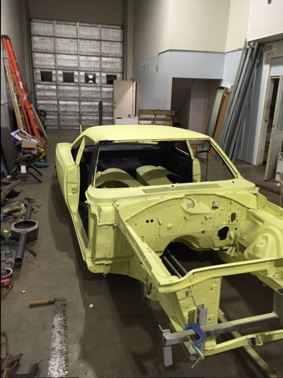

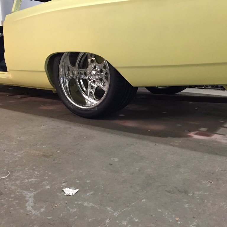

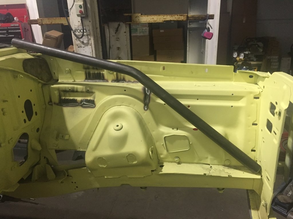

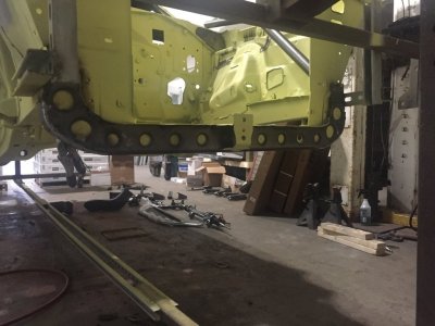

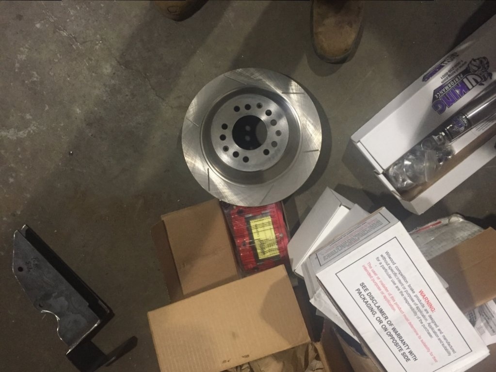

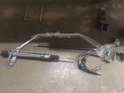

Well I am still making progress, time for it to go onto the hoist for suspension and stiffeners. Going to build my own 4 link, still havent decided what to do with the front. I would like to do a coilover/k member swap from magnum but with our dollar it would be 6k and that simply isn't in the budget.

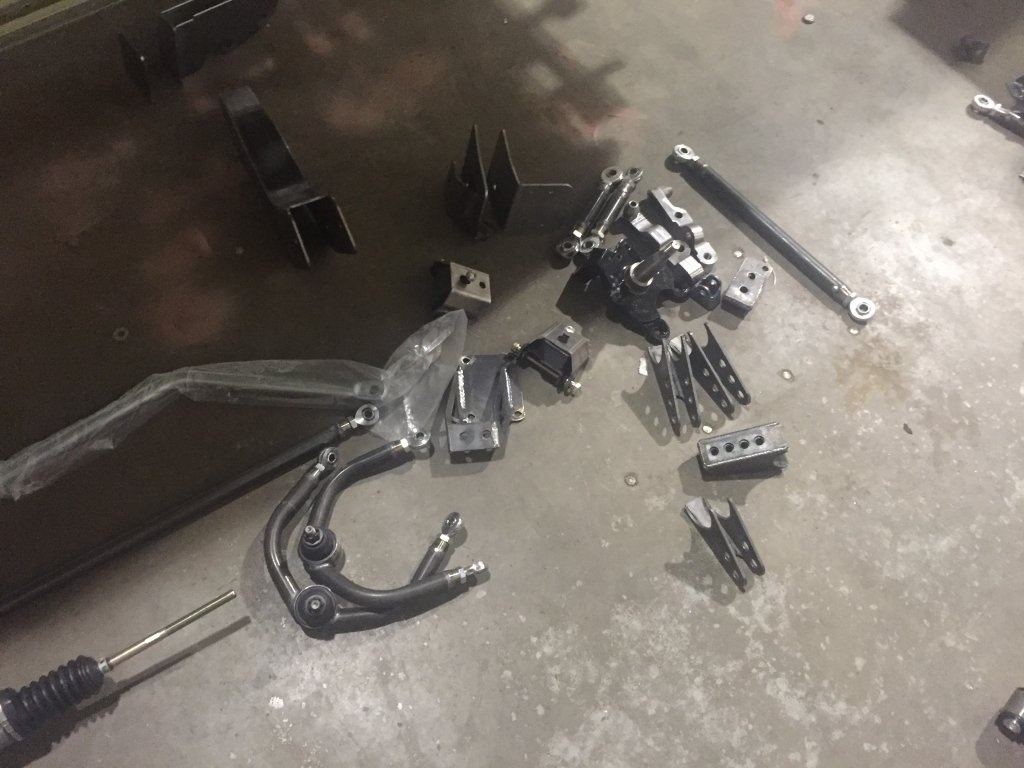

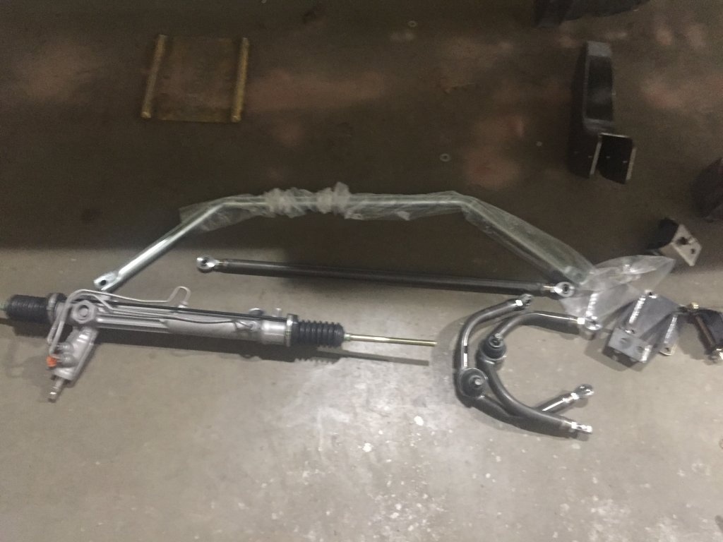

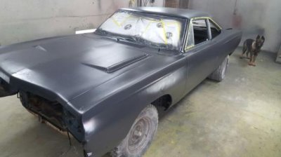

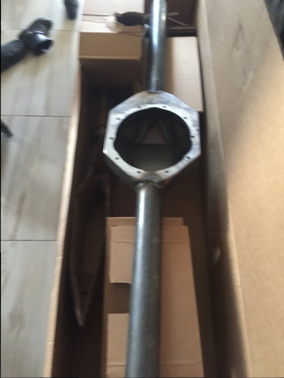

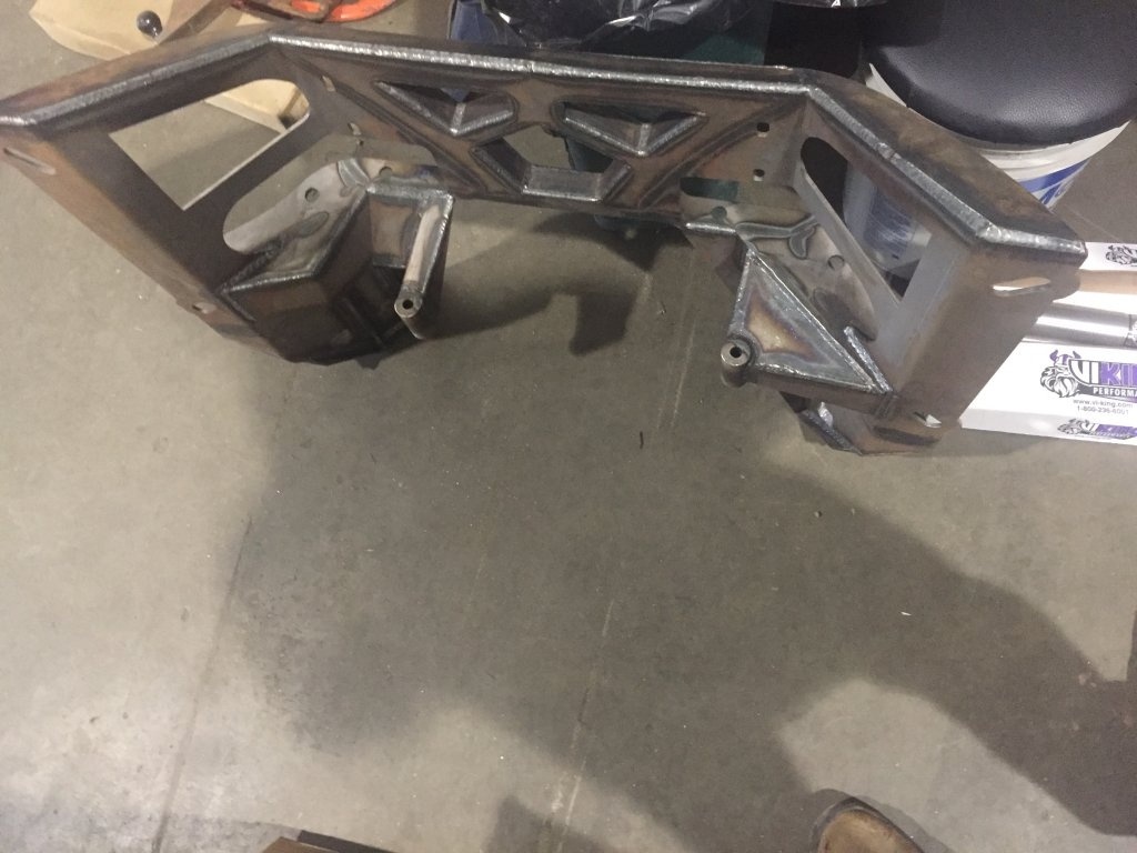

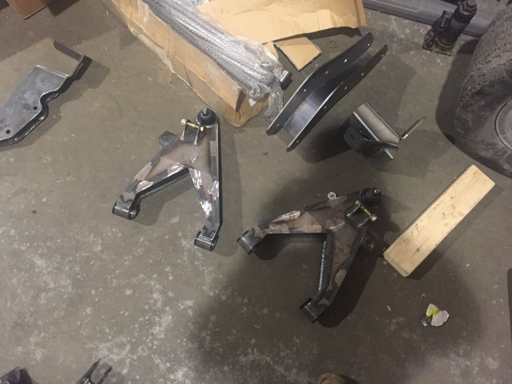

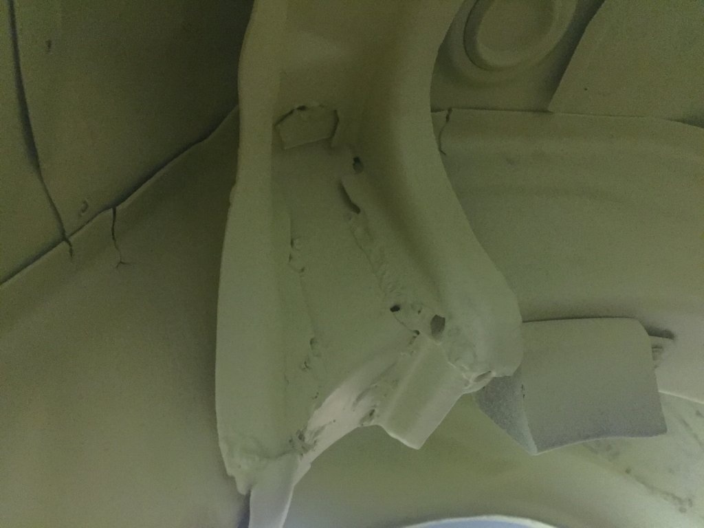

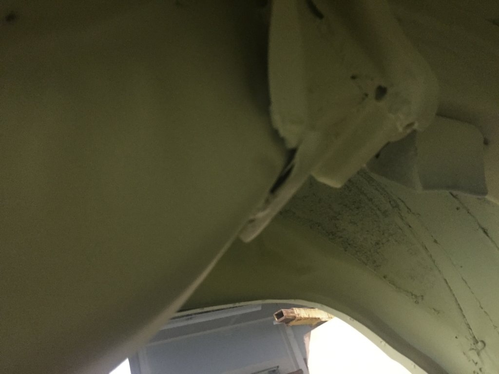

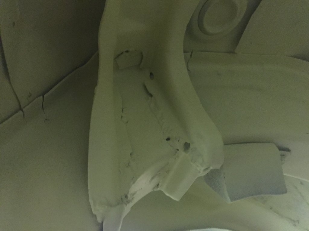

Well I have slowly been pick away at small things after all the major rust repair was done, been very busy. I have most of my drivetrain sorted out and welded in US car tools goodies. Going to start with the magnum force pieces now. For the rear coilover mounts, the magnum force kit uses the old shock mounts to locate/support the bracket but mine has seen better days. I plan on installing a piece of tubing in the cross members place to instead of replacing it. Also noticed a few stress cracks in behind it that i never noticed before. Now that I have a pile of parts I will update more frequently with progress.
