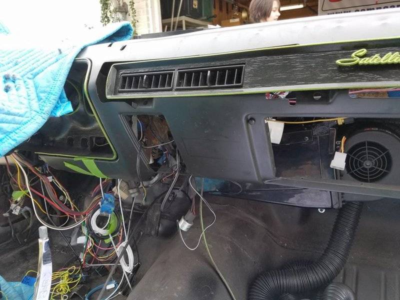

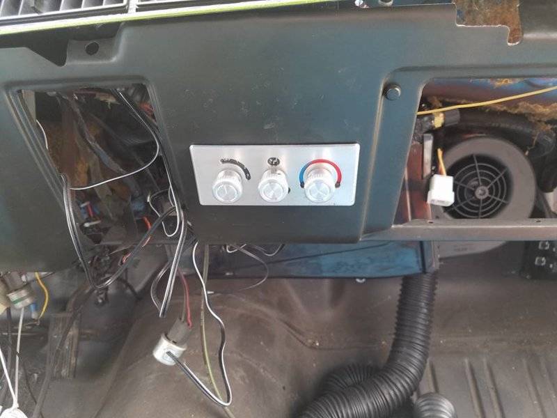

View attachment 614618 You cansee the after market A/C unit from vintage air mounted in the back. I needed a place for the A/C controls. Decided on the area between the ashtray and the glove box. This gives the passenger access to the controls and frees up the old spot for something else.

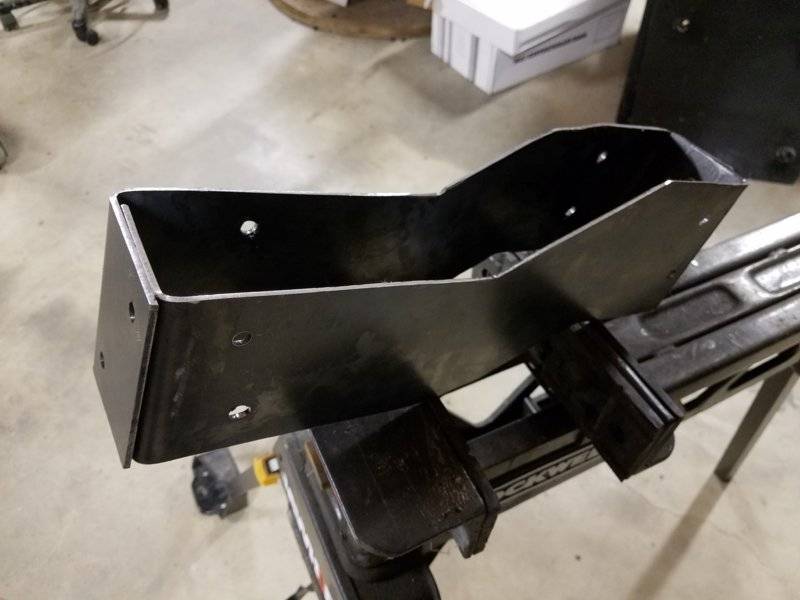

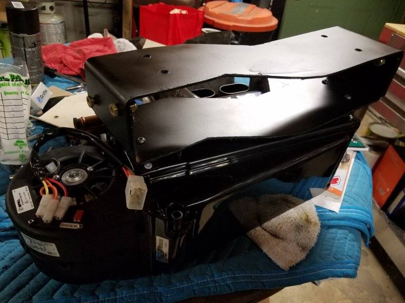

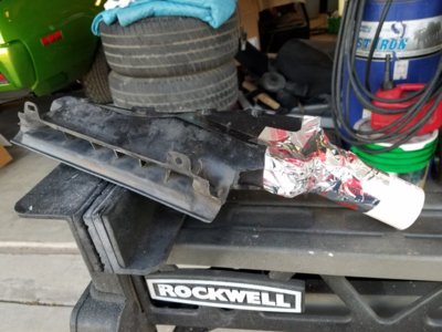

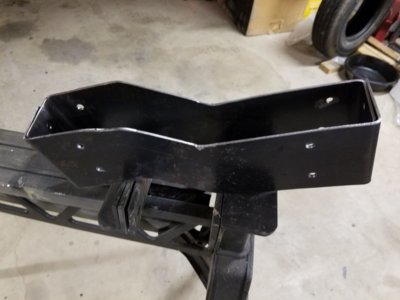

First I have to correct myself. It isn't a vintage air system, it's a classic auto air system out of coppell tx. The original box was a lot bigger unit. This unit is smaller and I was able to move it over closer to the center of the car. I needed the space the old unit took for the new wiring relay panel and fuses. I had already patched the holes in the firewall while I was working the engine bay. I made a bracket to hold the unit so I wouldn't have to attach it straight to the firewall. Figured it would be easier if I needed to service it or remove it for any reason later. I attached the bracket to the firewall, then the unit to the bracket. I used the original upper duct for the window defrost with some modification so I could attach the hose with aluminum A/C tape. Basically used the A/C tape to create a funnel down from the defrost plenum to the hose. Those are on the back. The front ones I haven't attached yet but plan on doing much the same thing. Use the A/C tape to funnel down to the hose as needed. Mine still isn't up and working as I've run into other issues with the car that are taking my focus. Very little is done, as far as the A/C goes, in the engine bay. I'll post up some pics once I get there and I'll see if I have some pics of making the defrost plenum connection or the installation in general.

Here are some pics of the bracket and how I connected the defroster.
20170905_202037.jpg 20171008_182935.jpg 20170905_202030.jpg 20170906_045506.jpg
