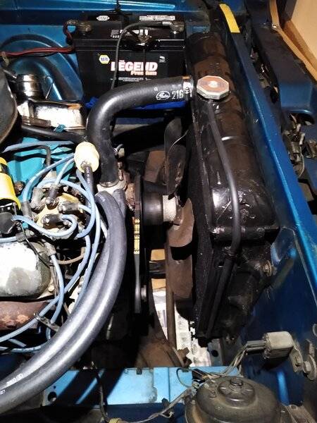

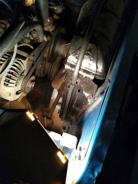

Thanks everyone, these are great suggestions! Here's a couple photos. It's a standard 7 blade fan and using a 180 degree thermostat on 22" 2-core (re-cored about 4 years ago) radiator. If I keep the radiator level too close to the top, it can boil over when shut off if I am coming in from too much low speed traffic. I haven't checked the timing in a few years. I will first get a new cap. It never did this when I first got it (one year old in 69), but has for the last 10-20 years. I should have upgraded the radiator to a 3 re-core. I really think it was marginal from the factory when new without a shroud and has deteriorated since then.
View attachment 974709 View attachment 974710
I believe the shroud attachment for that radiator uses brackets that attach to those holes in the side, neither the brackets or shroud for that are what you would call cheap but would look factory stock. Example;
http://www.brewersperformance.com/products.php?cat=160
Thanks origcharger. That's what I was thinking, that the brackets attach to those rectangular holes in the side. No, they aren't cheap! Thanks for the link.
