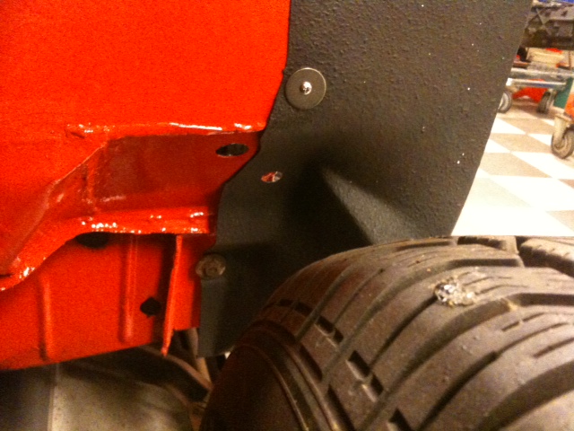

Does anyone know if there is a lower grommet in the splash shield area of the left front fender where the front em brk cable goes to the rear ? Been a while since I dissassebled this car, I have checked my literature and pics of other cars, cant tell. I have the upper grommet in place. Thanks for the help. Mitch

Yup got same grommet installed from cabin exit. There is another hole lower just inside of the splash shield that the cable must go though inorder to reach next location . Thats the hole/grommet if there is one , that im asking about.
I've never seen a B body with a grommet in that hole.
I took a picture that shows the upper and lower hole, I don´t think there was a grommet in the lower but I will put one there due to the sharp edges in the hole, mayby it is to overdo it but better safe then sorry.
Thanks Prop and Swede , Thats what I thought, I'm just trying to make it as original as possible. I might even fab my own grommet. As you said Swede it's a sharp edge.
