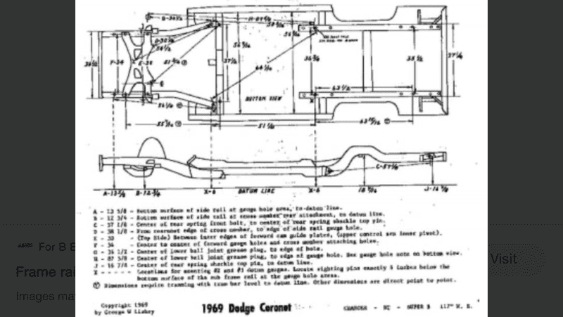

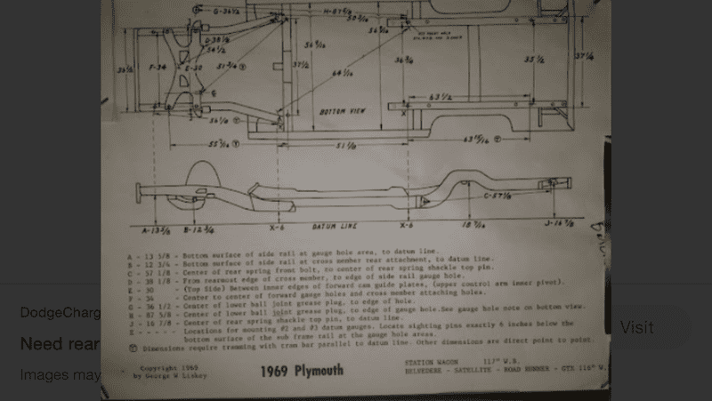

Replacing my rear crossmember mine was rusted into I'm needing some measurements to square up the back .thanks for the help
Hope this helps
When installing the AMD rear crossmember, the new part does not have the little indentations on the top flange. You will need to hammer those in, so the little tabs at the ends of the frame rails sit flush as original.
