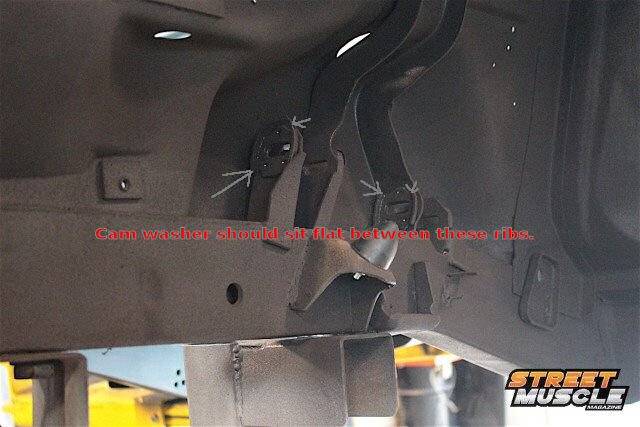

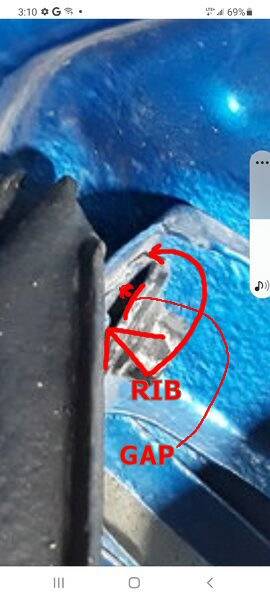

Looks to me like the cam is not sitting inside the square, should be flat against the inner portion. The cam uses those ribs I guess you can call them to adjust the control arm. The picture you posted look like the cam is outside of those ribs.
View attachment 1226853View attachment 1226857
I know it looks like that but that's a shadow. It does sit flush. Regardless of any of that, the old rubber bushings are long since worn out, dried up, hard and crumbling with chunks missing. I am going to replace with new. I like the idea of the new tubular A arms. My only actual question now is what is the best source to purchase them from?
