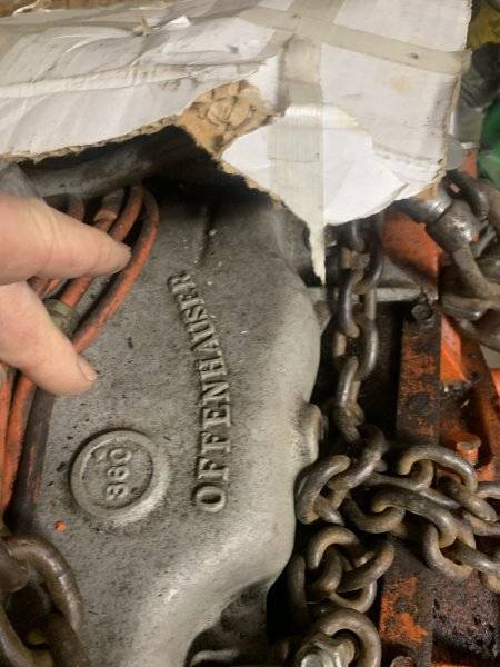

i have a choice on intake manifolds on my engine . i’m just starting to prep a 383hp to go in my car , i have a choice of available intake manifolds. there is a offy dual port (380) or a cast iron oem , might be original to engine , to be verified. probably lookiyto put a 650 carb on a mostly stock engine. is one better then the other ?
not concerned w match or original, just a good running engine …
Do not use the offy. No good.
What is the casting # of the iron one.
i’ll have a look but can’t see it today …
Agree with above. Offy belongs on the wall, above the Moose head.....
The 301 is the 68 roadrunner intake. It's a good choice
