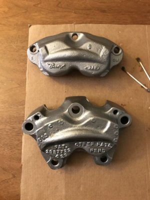

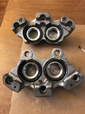

rebuilt mine, Centric pistion (part#146.51010). bought the rubber from parts geek. can also get return springs there also.
Sorry it took so long to get back with pictures but I couldn’t do it from my home computer.
D6767487-5175-45E0-BA7A-775AF0986250.jpeg 36C7A75B-C579-4C86-8699-0E77C0B90B8E.jpeg
Nice job! - I'm about to do the same rebuild, had stainless sleeves installed already now just need to get them back together. Did you replace the return springs? I cant find a listing for them anywhere including PartsGeek, any chance you have a link to them?
