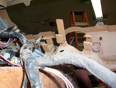

Hi,
Is there a mount for the Key Timer Switch?
On the top of Ashtray of is it taped in to the harness.
I know this is an option and have it wired up but don't recall if there was a retainer clip on the ashtray like the hazzard switches
Thanks!
If you look to the left you can see where mine was. Car was never apart. Most of the time the heat that timer generates destroys the tape. No mount and its just to the left lower area below the ash tray.
