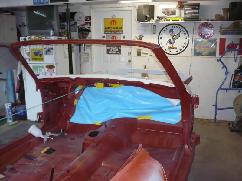

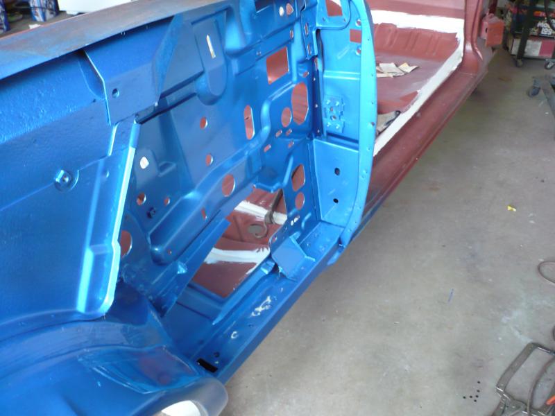

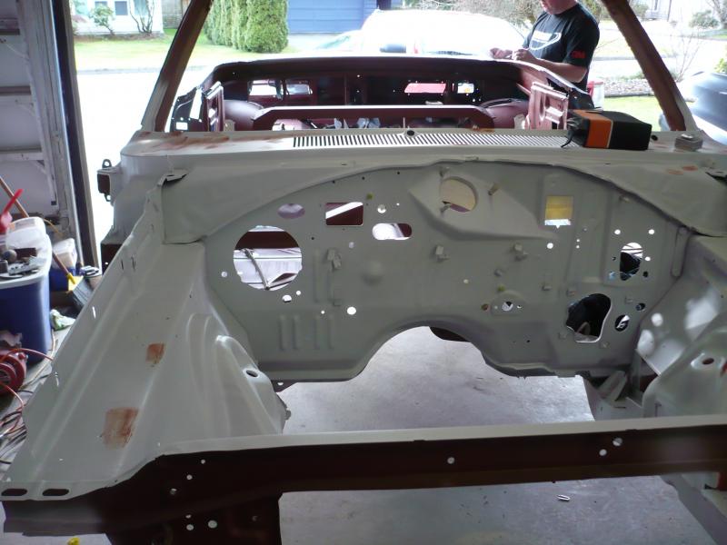

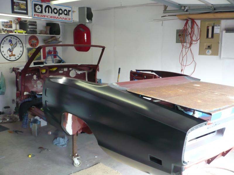

Just some pics of my car finally getting started. Factory 4 speed with air. Blue with blue and white interior..

That is going to be a sweet ride! Great project, Good luck with it.. Looks like good weather where your at, sorry just sulking over this bone chilling cold here lol :)
I can't wait to see more of this one.. love those big ole B Body convertibles :headbang:
Car looks like it will be fantastic. Good to see another one in B.C. I'm in Victoria, 69 Coronet 500 with air... Now R/T clone with 440 6 pack... I will send you a P M Peter.
"Very nice" that should be a real head turner when it's done. What all did Mopar do different to the convertibles to compensate for there being no roof? Sorry, never got to look at one and am just curious. Congrats "it looks great".

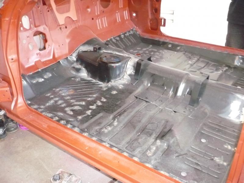

Frame connectors like Hemi cars and massive steel angle iron in the rocker panels .. probably other stuff too but that's the main diff.
That 4th picture! Sweet. Muscle. Coke-Bottle. Stuff of Legend.

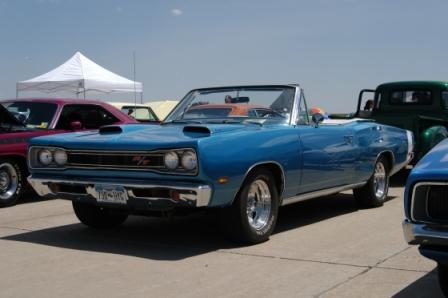

My '69 Vert is a R/T 440 4-speed car, but not numbers matching when I bought it, so now it has a 505" stroker and 5-speed OD transmission.

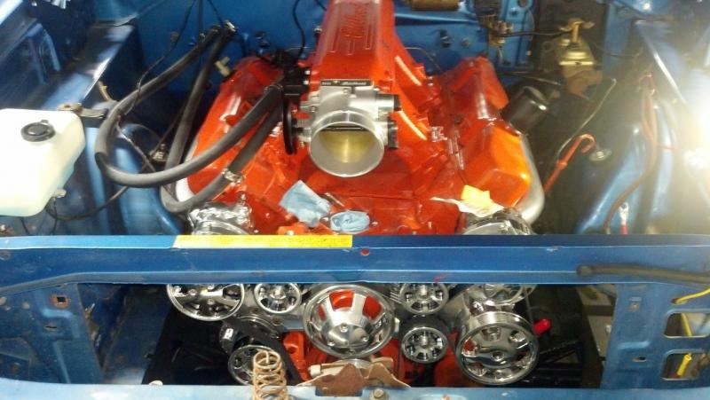

The body of my car is OK, it's the same as when I bought the car, but some rust is starting to show in the lower door and floor pan. Also, some old bodywork is looking rough in a few places. When I bought the car it had electrical issues and the fuel tank and lines had rust in them. As I mentioned, it was not numbers matching, it did have a 1970 440 HP2 engine (stock), with a partial VIN# 0A193407. The transmission was an A-833 from a Road Runner (I think), the transmission VIN # on it was RS23L9G157135.
The Engine in the car now is a 1969 Block stroked to 505", ant the transmission is the new Keisler SS700 5-speed. This summer I had to send the trans back to have it fixed, and when waiting for that, started installing the EFI and Tru-Track system with A/C. I still need to put together the rest of the A/C system, most likely a Vintage Air setup. Then I may need to get rid of the 4-wheel manual brakes :)

They all have front and rear torque boxes and the rockers are reinforced.

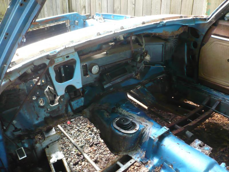

Car was in ruff shape before these pics.

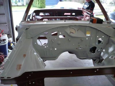

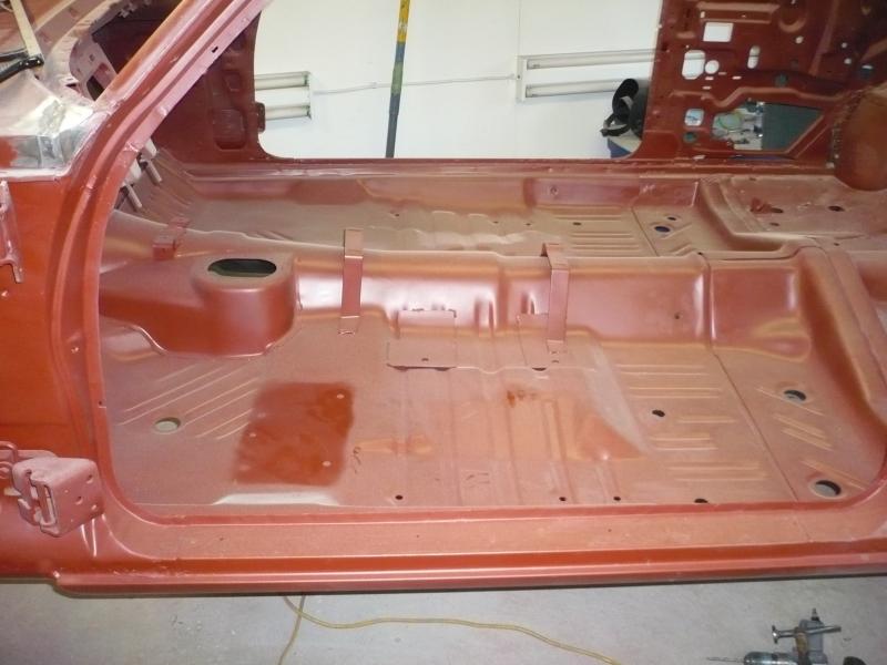

My car was in need of complete floor pan, trunk pan, outer wheel wells, trunk extensions,full quarters.
Frame rail were great,front clip was great,rear seat area and part of the upper trunk area was good.

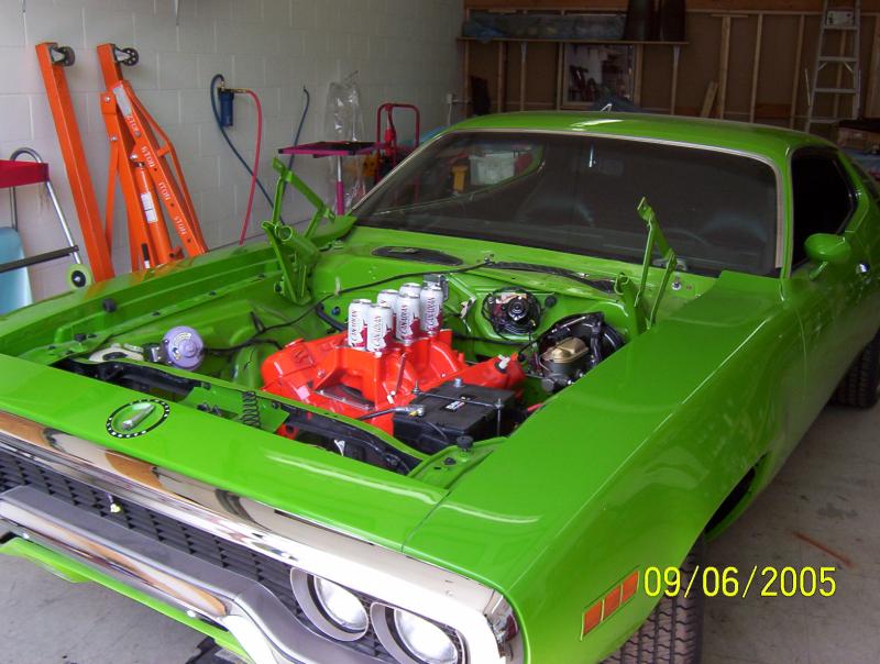

Had fun with friends car i did with 1 of 1 440 six pack roadrunners. Runs on 5.0 alcohol.
That looks nice. The passenger side floor pan on my car has a few small rust holes, and the trunk had been replaced with a two piece trunk floor some time before I bought the car. I am planning on doing all the body work after getting all the mechanical upgrades installed/working, so I am not cutting and modifying on new paint
