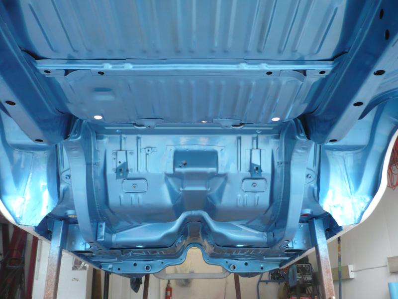

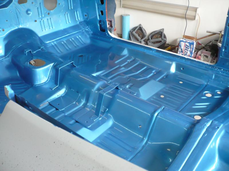

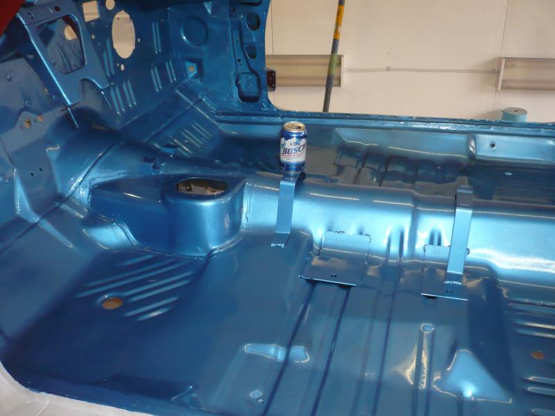

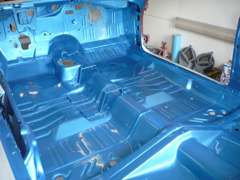

Frame connectors like Hemi cars and massive steel angle iron in the rocker panels .. probably other stuff too but that's the main diff.

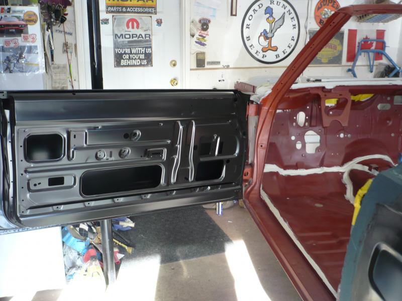

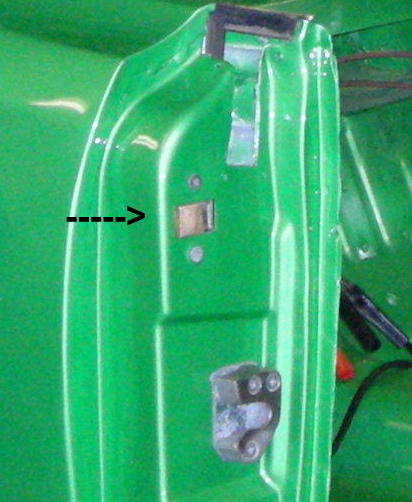

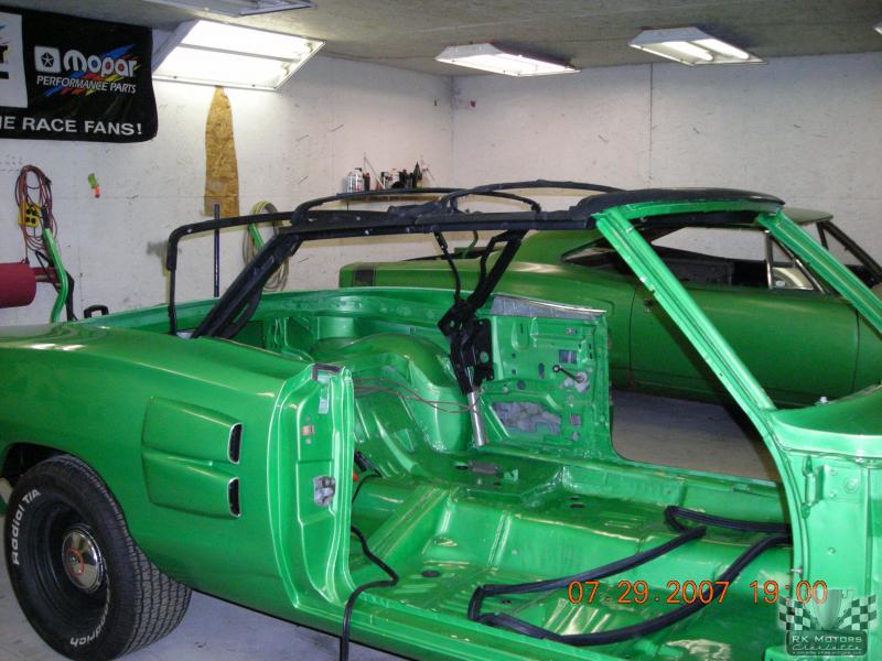

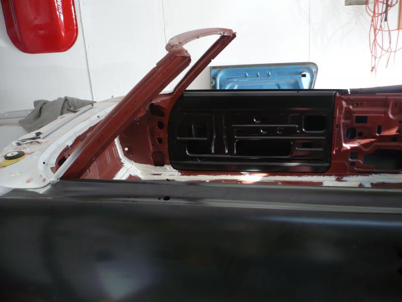

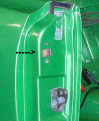

Where the door meets the quarter panel was different in the rag tops making a more solid connection with the quarter panel than the hard tops. Look just above the door latch.
Photo from RK Motors:
