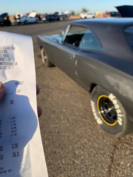

Slip was as follows
60' 2.121
330' 5.749
660' 8.698
1000' 11.184
E.T 13.291 @106mph

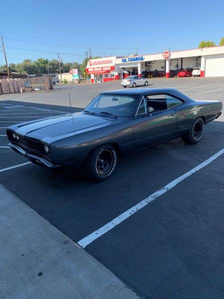

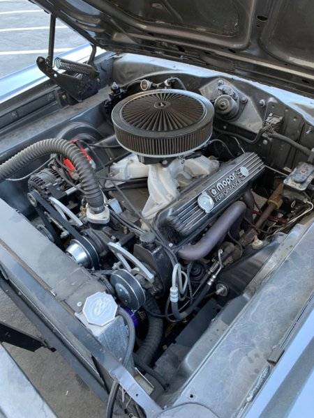

And some photos since everyone loves those

Slip was as follows
60' 2.121
330' 5.749
660' 8.698
1000' 11.184
E.T 13.291 @106mph
View attachment 840775 View attachment 840776 View attachment 840777
