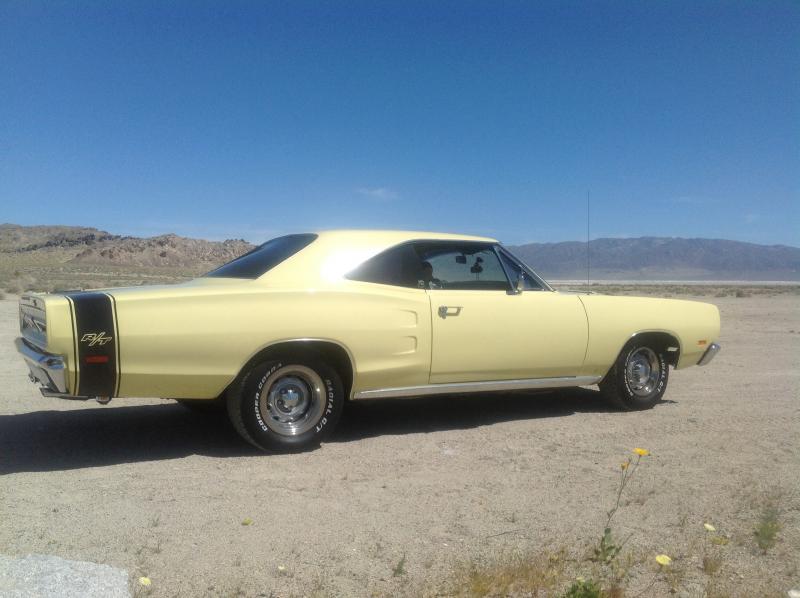

No idea. For street, 225-70 R14's front, 295-50 R15's rear. Stock springs. 8 inch rear rims. image.jpg
