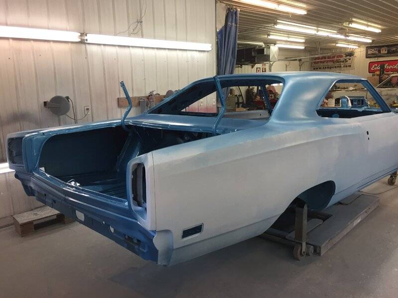

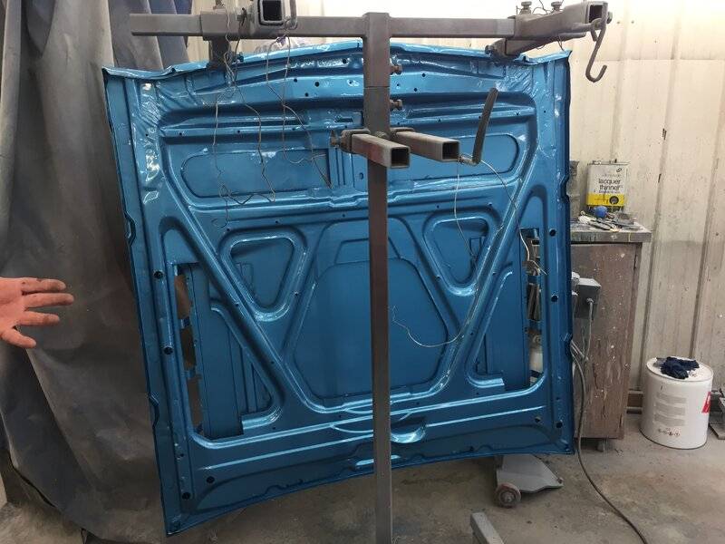

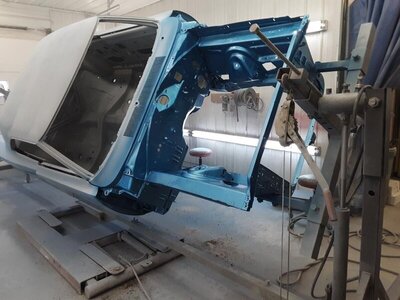

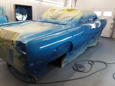

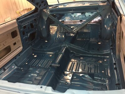

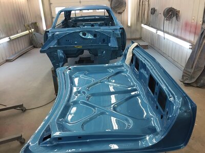

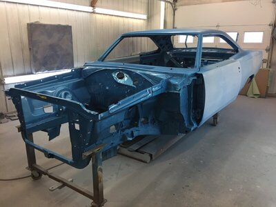

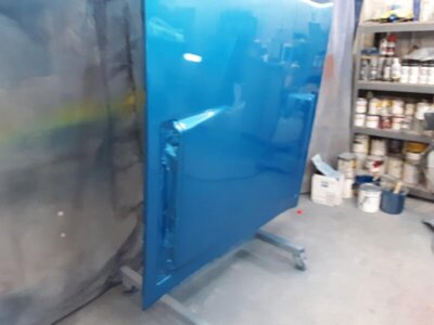

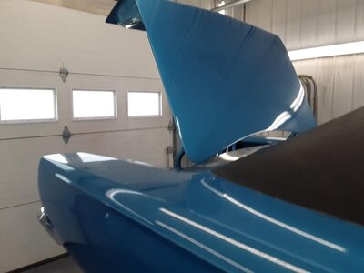

Here are some pics for an update on the body work. B5 blue paint is starting. very exciting.

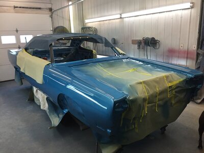

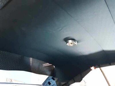

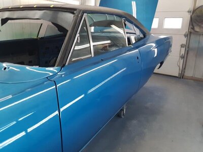

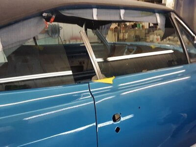

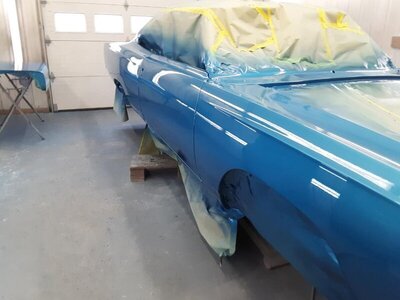

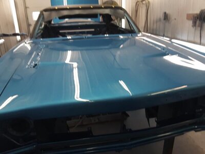

All B5 paint work is done. The lower black is left to apply. Vinyl top is on and headliner is in.

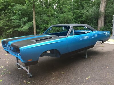

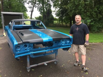

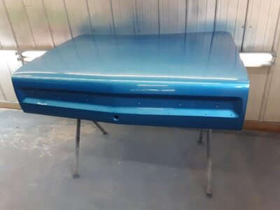

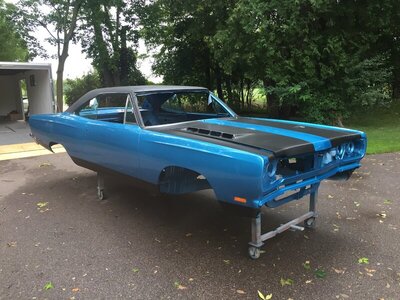

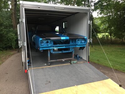

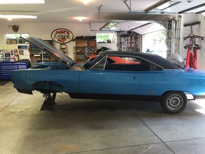

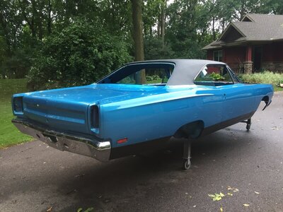

Thanks for the props gents. Yesterday I hauled the GTX home from paint and body.

Wow that looks nice!! I did my 69 GTX in my garage too.
I'm diggin the paint scheme and color. That would be my dream gtx

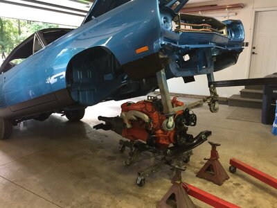

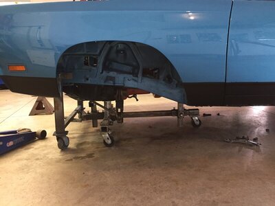

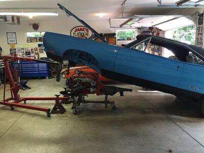

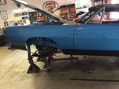

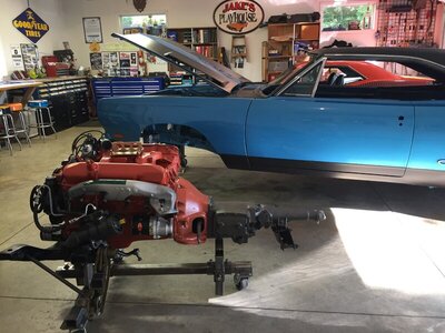

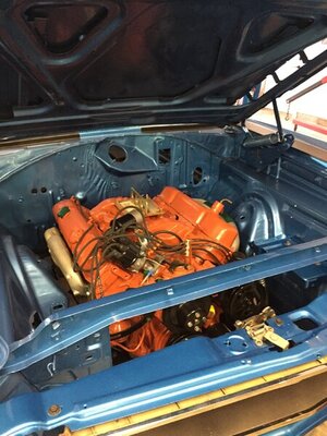

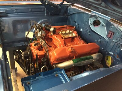

Made some progress this past weekend- Installed the driveline: Engine, Trans and the Dana 60/Springs etc. The car is now sitting on rear tires. For the engine trans install I lifted up the front of the car with an engine hoist (Cherry Picker). Rolling the engine and trans under the car, then lowered the car onto the engine/trans. The engine landed right where is should and the height of the cart put the frame rails and K-Frame within 2 inches. The k frame bolts actually reached in the frame rails and started. No big shop, no big car hoist, just ground pounding floor jacks and jack stands. It took me a day of recovery in between the Dana 60 install and the engine install. I had to reload my daily “bend” allotment. Score one for the littles guys working in their garages.
