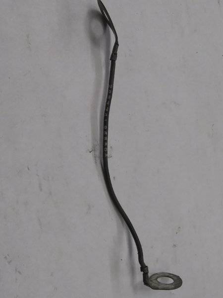

So grabbed a hand full of hardware to blast last night while trying to figure out the window. I came across the ground wire that goes from dash to steering column. It looks good but I made a new one and soldered the terminals to make sure I have good connections. Anyone looking for a good OEM for their restoration? # on the original is 2857741 96555A.

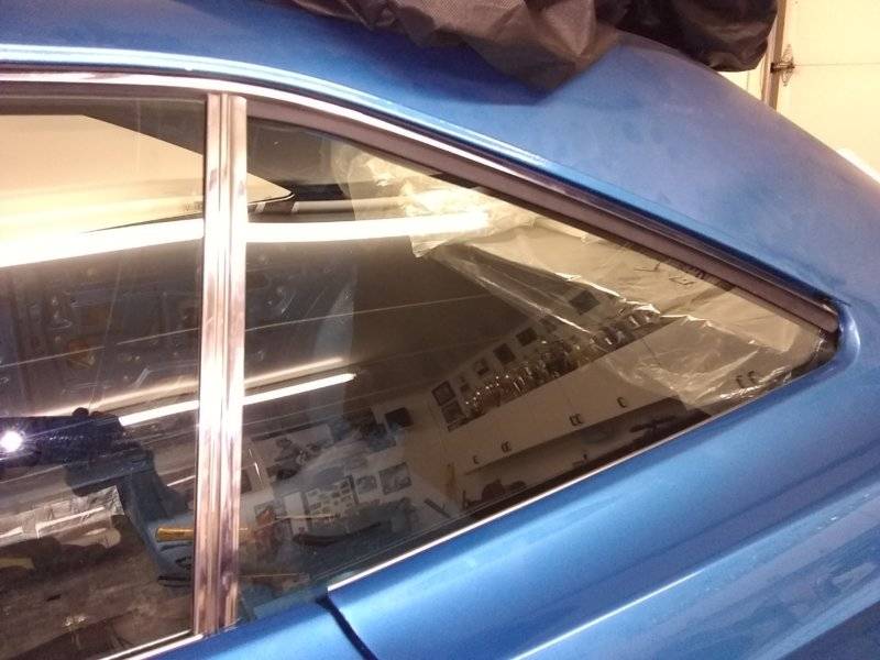

Tim, are saying that the quarter glass is not going any more forward toward the door glass seal as you crank the window?
yes, hits top before getting forward. I think I may have the glass in the seal, instead of on the outside of the seal so going to try that tonight. I bought aftermarket AMD glass so not sure if it's the glass or something I'm missing at this point. I dug out my old glass last night so I can compare it tonight.
BTW how's yours been running?

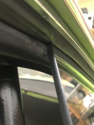

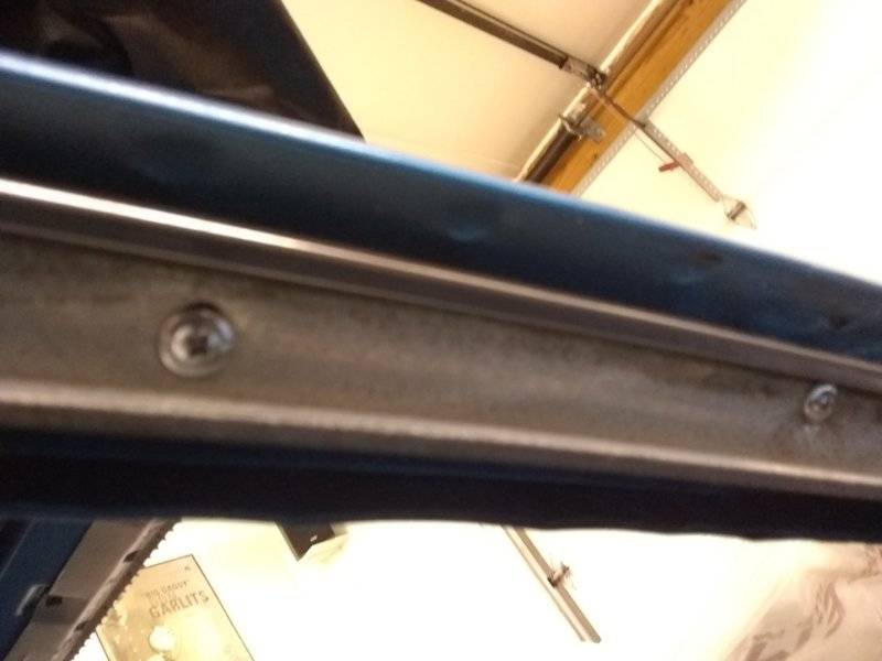

Sooo I tried again tonight with the quarter glass. First I pulled the seal out of the roof trim, turns out there's some adjustments there so I slid the bracket all the way towards the inside.
The very last screw on this didn't have any adjustment so I left it out for now. This moved the seal inboard allowing it to start on the out side of the seal. This in turn let the window go up farther. So then I started working on the adjustments. SUCCESS!
Sorry for the double pictures. I'm so relieved to have one side done! The other side should go much quicker and easier. Thanks everyone for your help!

The seal has a channel formed in it that the windows go into. When installed, it is at an angle so the inside of the channel hangs lower than the outside. The quarter glass only goes about 3/16” into it. You can move the stainless roof rail in and out so it all lines up. There are also track adjusters to move the window in and out.

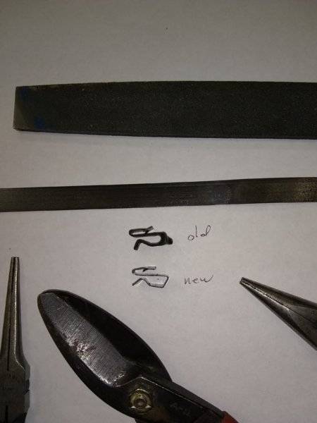

What you do when you're a clip short.... some steel banding and wha la!

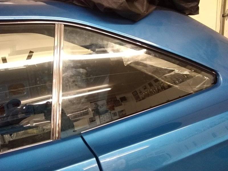

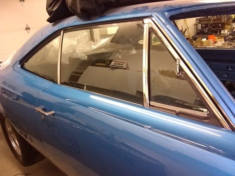

So, did a little more tweaking on the window and I think I have it finally where I want it. Got it in the seal and mated with the door window. I had to tweak the door glass also but feel I'm close enough for now. I'll let the seals
take a set from the windows for a couple months, then revisit them.

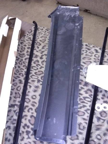

So it seems as if Murphy's law is tormenting Joel (hunt2elk) and me. I think he's seeing who will crack first. Over the weekend I found my painter didn't do the backside of the panels that go on the inside for the 1/4 glass. So last night I stopped by the store and had them mix me a pint. So first thing tomorrow when I get home I will be doing a little painting.

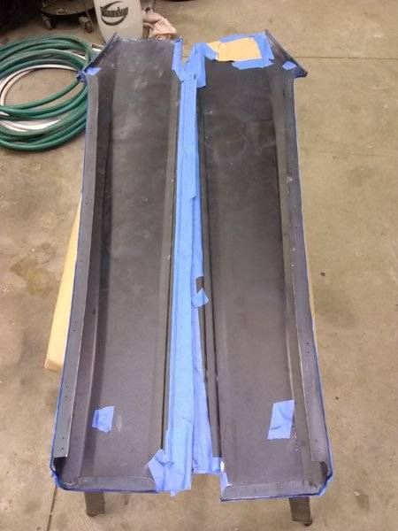

All scuffed, washed and ready to mask. Hopefully I get these painted with out any grief. Then I will start on the passenger side glass. I hope to get this all wrapped up by Sunday night.
Is that leopard skin print for another project?:D

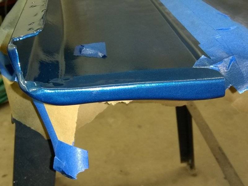

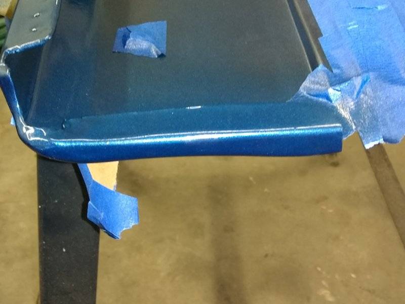

So first on the list for the weekend went well. Painted the inside upper panels for the quarter windows. Painter didn't get the backside lips for fuzzys and door jam.
made sure I taped off screw holes. If you look close you can see the edge of the tape where the new and old paint meet isn't pressed all the way down. My good friend taught me this trick. It's help reduce the hard edge between the 2.
I reduced the single stage paint about 33% with medium reducer. Put a light tack coat on, 65 degrees in garage. Waited 15 minutes and put the final coat on, then immediately remove tape at edges. Turn out pretty good, no seam and it even matched!
