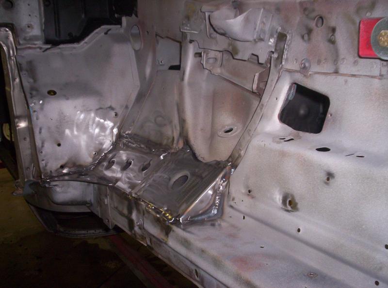

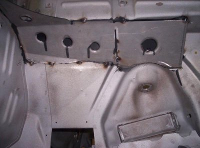

Got the front firewal/fenderwell stiffners fitted and painted on the back side to dry, ready to weld in next. Pictures coming soon.

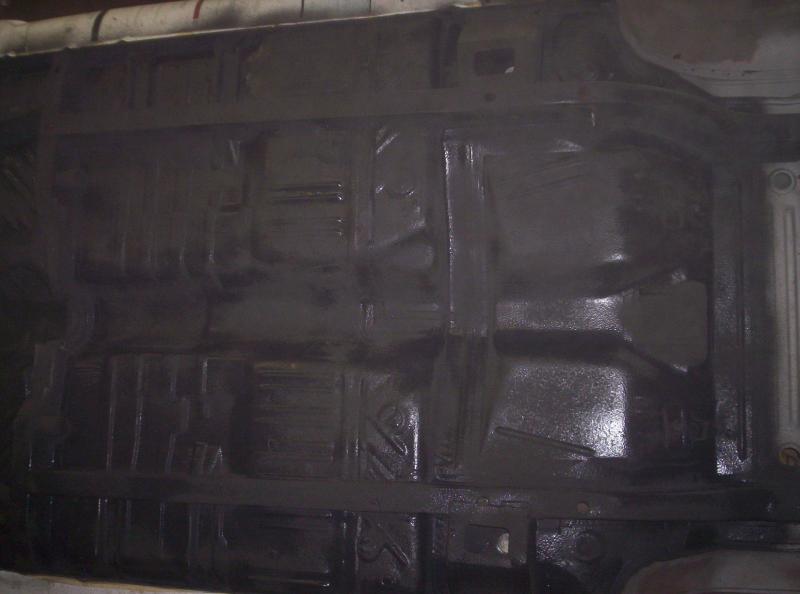

Well had a good weekend. I got the US car tool front fenderwell braces instaled. B on fit just a little tweaking here and there and welded right in. Got the POR 15 on. Then I sprayed the underneath wit the ceramic Lizard skin coating. Went on well after getting the gun set. I went for a finish similar to a bedliner look. Got 2 coats on. I ordered2 gallons and it will be about right as I plan on using it in the passenger compartment side of the firewall. Also got the sound deadner product for the passenger floor. Should get that on next weekend. Then I can get started on sheet metal!!!! BTW the Lizard skin was great to work with. Water soluable clean up makes this stuff a snap.

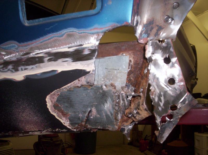

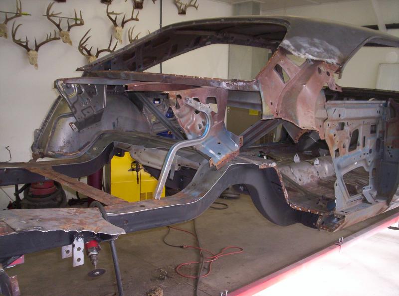

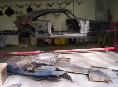

Yes indeed they are SS springs Budniks. I took a week of last week and got all the sheet metal removed. Pictures later tonight. Glad I did there was some morbid bondo work I found. The 1/4's weighed twice as much as the should have with all the tiger hair, galvinized tin, & bondo!!!

isn't it awesome some of the work the body shops do? or other peoples ideas of how it could be done cheaper. I have a 70 GTX and will be watching your car come together. I grew up in the north west corner of IA.

sounds great, keep up the progress.... waiting for the photos, you know we love our car **** around here...LOL...

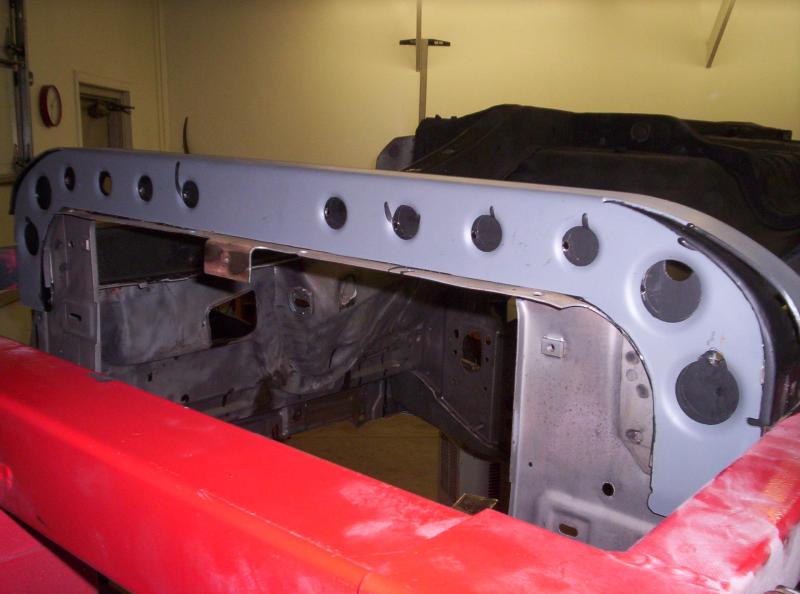

Got the US car tool lower rad. support in. Liked it alot, fit very nice.

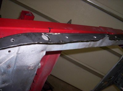

As you can see the rear quarters had some shadetree body work. Now its all stripped and ready to start back the other way!!!
New quarters, trunk floor, and deck filler. Got my dolly cart made so next I will be putting the doors on with the rebuilt hinges so I can line up the quarters. Bought cleco pins and rivets to put everything together to assure propper fit and lines, gaps before I start welding.
