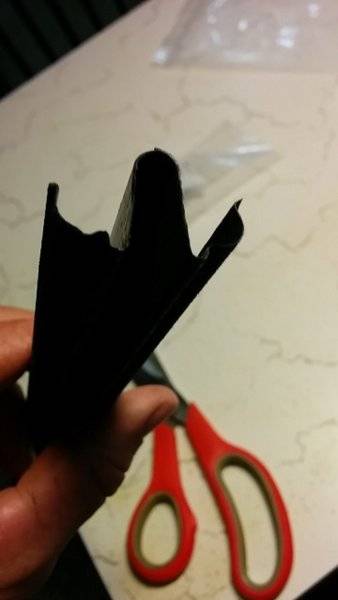

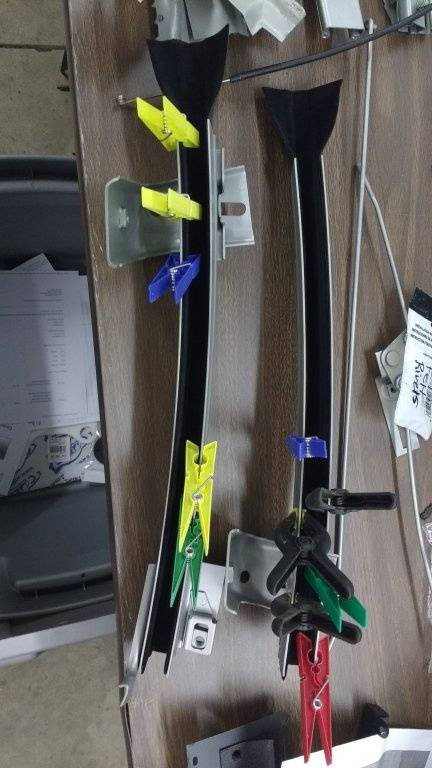

Did my first window work. I laid in the felt for the window tracks. There is a correct way to install them. One side has a relief on it near the bottom. I'll rivet them in after they've had a chance to relax.

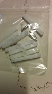

It's not felt but a thin mylar that attaches to the leading edge of the windows with plastic guides that lock into the vent window frame. They are expensive for what they are.

On the front leading edge of the door glass is the mylar inserts. The inserts are attached to the glass with the nylon "H" pins. The mylar gasket works as a gasket to seal the glass to the vent window frame and serves to keep the glass from rattling within the frame work. If everything is working properly, there is not that much movement in the glass. But after 50 or so years of use and abuse, items get worn and thus more movement of the glass.
I will have to get a picture of the lockstrip run. It is a heavy rubber extrusion with a flocking so that the glass will not bind on the extrusion.

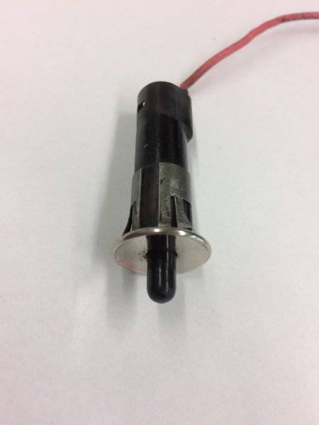

Tim, Thanks much for the glove box light. A little cleaning and it cleaned right up.

Showard, looks great! The bulb was junk but I left it there for reference. I wasn't sure what the terminal was supposed to be. If you need anything else just yell.
