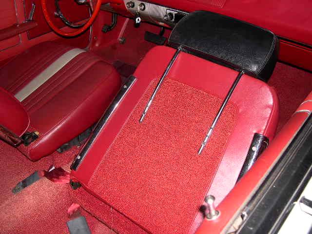

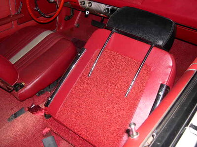

Not sure if the bench had rests; but seem to think they did. Could be hardware within the seat back for rests. I had rests installed on my ’63 buckets using later 60’s rests that wasn’t a big effort attaching loops to affix the bars to the frame. Only thing is they’re not fully adjustable; but do the job I needed having a partial neck fusion where a whiplash could do me in.

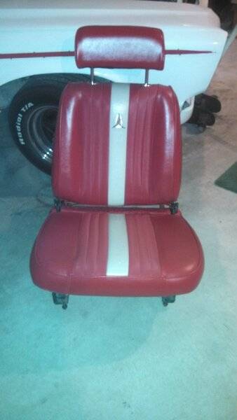

Hope all this is helpful for the OP. I got a fantastic deal on my headrests off of flea-bay for 25 bucks and looked brand new as the photo shows. Had to have them recovered though for the red insides.
