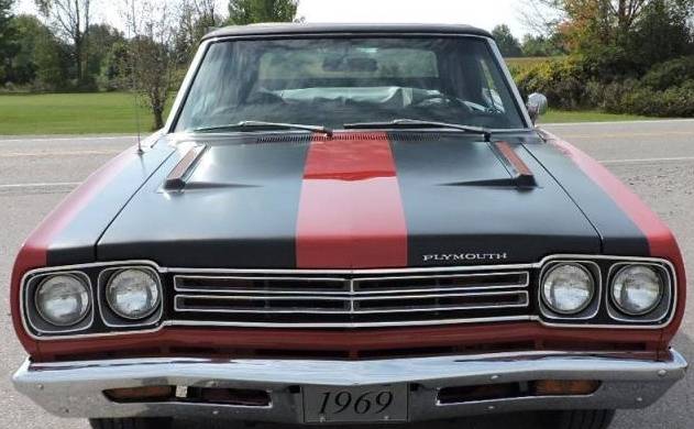

Is this an Air Grabber hood.. missing the air box assembly??? or were all RR hoods open this way?? Thanks!

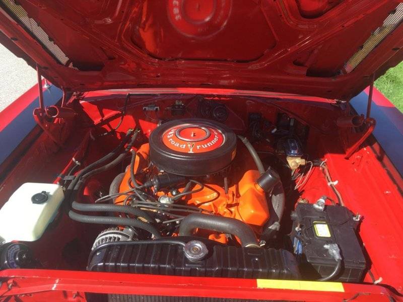

At least I have an Air Grabber box... :D.. and a cleaner assembly. Real question is.. is the hood correct to the car!?

There is no reason why it wouldn't be correct........the only exception are the screens......There is NO hole in the firewall for the "carb air" cable...

Other than simple things to change to make the bay more correct.....It looks nice in the pic you provided...

If it is a factory N96 car, then someone has swapped out the three speed wiper motor with a two speed unit.
Thanks Richard, something I should have seen right off the bat. What stuck out was seeing sky through the "grills" when I would have thought they'd be shut for a non air grabber unit. I need to go see it... it's a few hours away.

I bet its not black and doesnt have AC with the N96 option...lol....

LOL Roger.. I know V21's not on the fender tag so the outer black treatment isn't "OE".. as for the hood I'm not versed in '69 Road Runners as to what would have come stock on a Vert. Do you know the "truth" in it before I go for a day long drive??!!
If not on the FT then NO....
