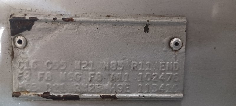

My fender tag # matching dash engine & trans has a A11 code on it why ? A11 code comes up as - special model xx29 charger daytona or 500
In that position it is the scheduled build date. SPD
October 11, 1968

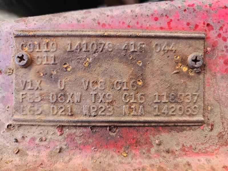

C16 is floor console, so does this red car have 2 of them? No it is the SPD
