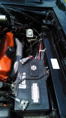

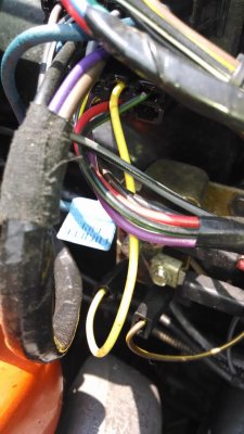

Thanks, I will start with the meter and see what I find. Plus I'll grab some pics of wiring under hood just so you can see if anything obvious pops out.
Check and double check all the wireing and grounds but UN hook the battery first. If what ever made it dead comes completely off then you may have a really bad fire or at least more problems you don't need.... could also be a bad ignition switch.... Or fuse link.... don't be in a hurry to fix it you may have many problems it's rarely just one thing...
From their pics it looks like the original wires.... I would get a complete engine and body harness made or bought from a company and 're wire the entire car.... a car that nice deserves some new wires.... so it doesn't torch over a few hundred in wires it well over due for headlights to tail lights.
I Think from here on out its wire by wire, connection by connection and look for the obvious. Anything marginal will get replaced. Want the car not a check from insurance company. Will update after some research. Thanks for everyone's help.

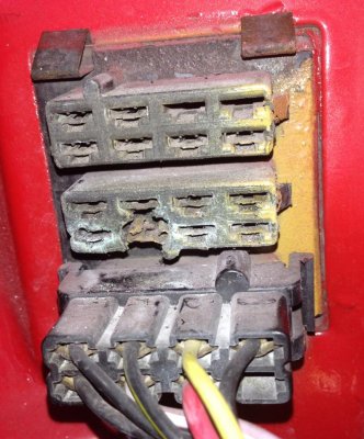

Look at the black connectors, if they are shorted, they will be melted. Headlight switch, Ignition, alternator gauge. Unplug the three connectors on the firewall, and Inspect the junction coming from the Dash harness plugged into the firewall. The point where the three plug into the junction can also show signs a short.
Has the same issues with my 69RR 440 6Pk, traced it back to the wiring block at the firewall, right back to the ignition switch, wiring just old, and tired.... we bypassed the really bad one, and are good to go. I will def do a wiring harness in the winter. Gives me an excuse to play with my bird...... wait.... the doesn't sound right.... Cheers, good luck!photo-5.jpg

I had the same thing on my 69 RR. I found it to be the Hot main lead going into the fireWall bulk head jungtion. It was loseing contact when it got hot. then rehook ? It was green and melted alittle on the inside. This wire feeds ALL of the inside of the car and will shut you down in your tracks ! Sounds just like mine and your at the start of it so at least it didn't melt out real bad YET. Also you can unhook you (-) batt terminal and put a test lite from the Batt to you cable . Turn the key on and you will see the lite on. Wiggle the conections at the fire wall and it the lite go's out BINGGO ! This way you won't get a dead short or fire !
