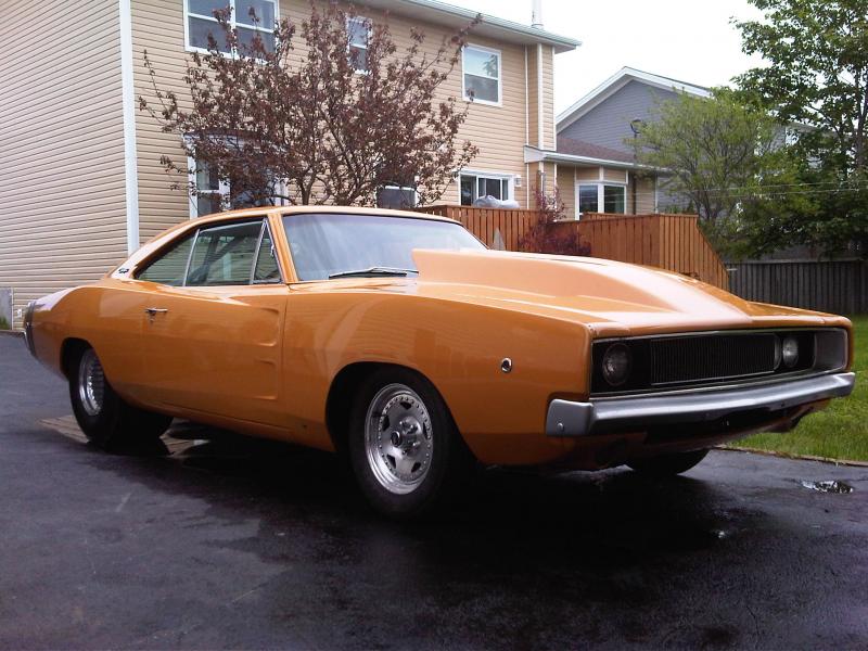

Same here on the body side of things,I don't believe they compare to the usual junk! A friend of mine was down to their spot at sema last year,and had a good look.I'm sure lots of guys here can comment on the fit.I have turned out a few cars over the years,I have a '68 Charger,I don't know if they're ever finished? LOL. IMG00065-20110630-1308.jpg

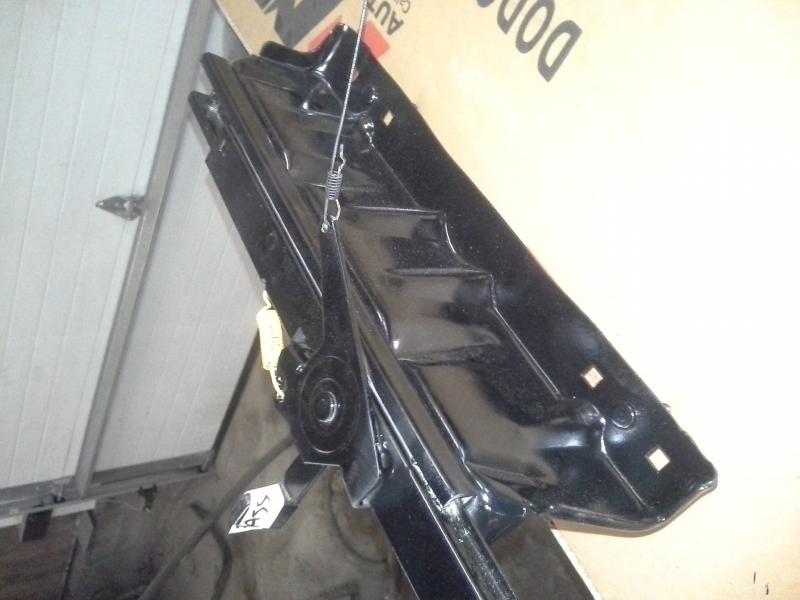

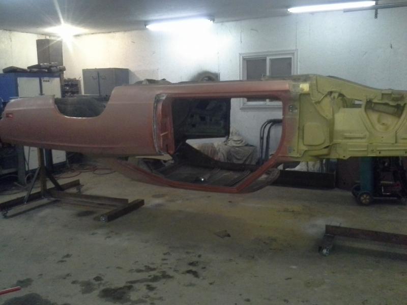

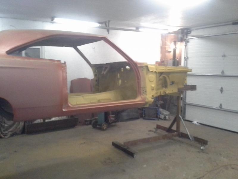

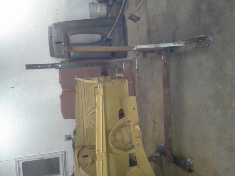

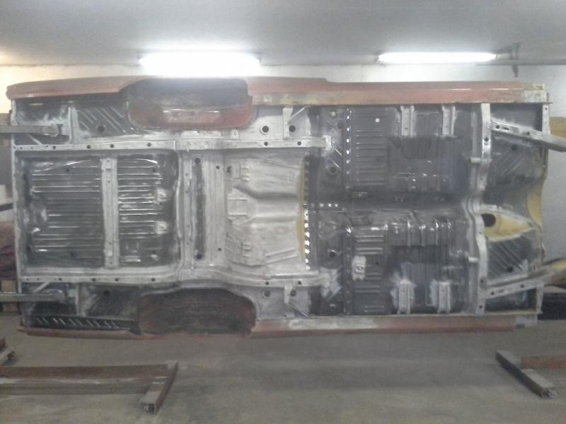

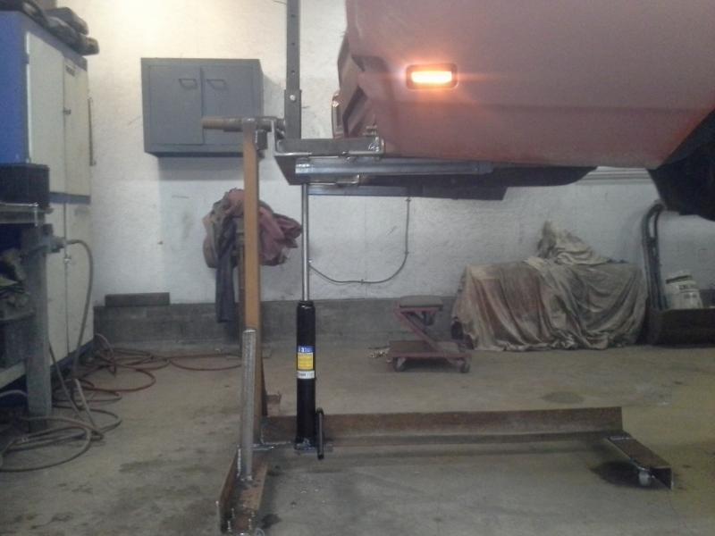

I got a little more time in at the car, or actually I guess the rotisserie. I built a rotisserie and now I should be able to clean up the bottom a little easier.

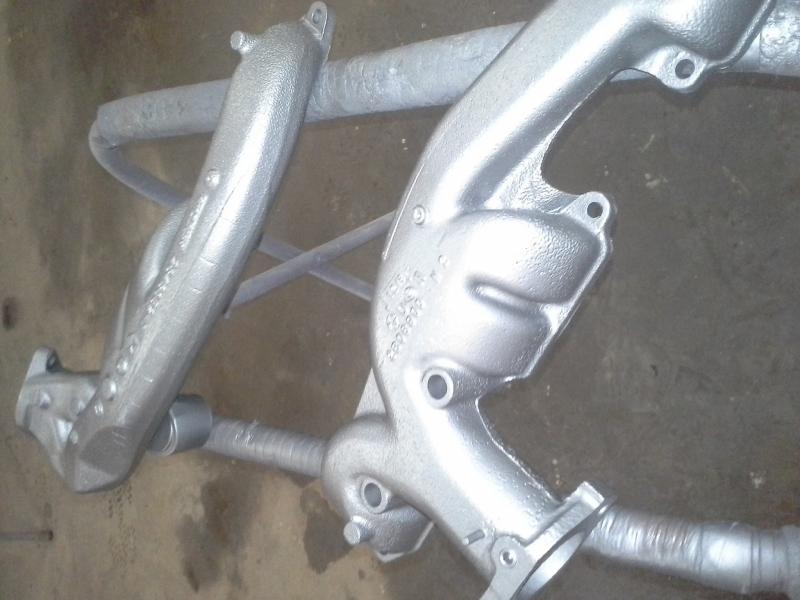

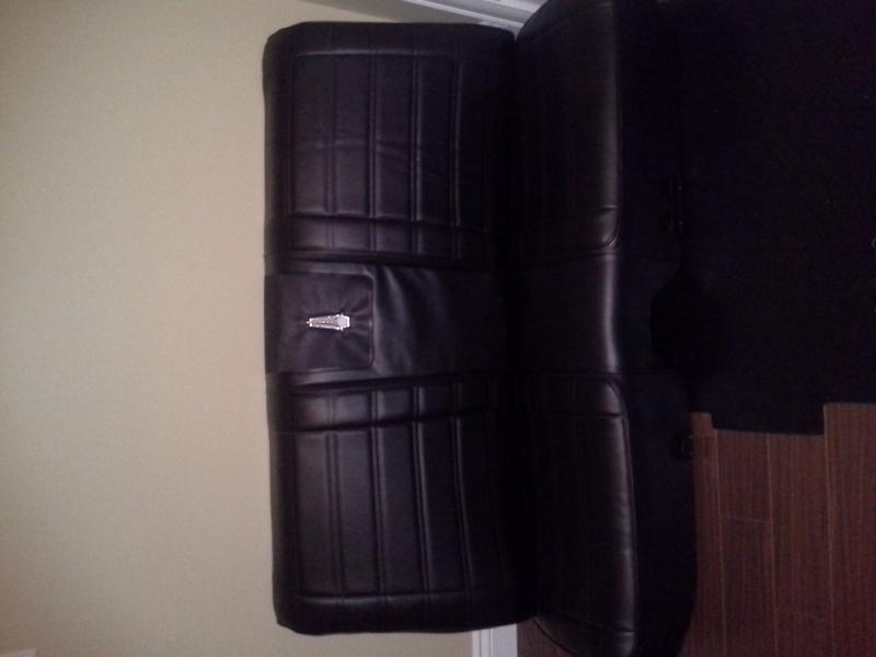

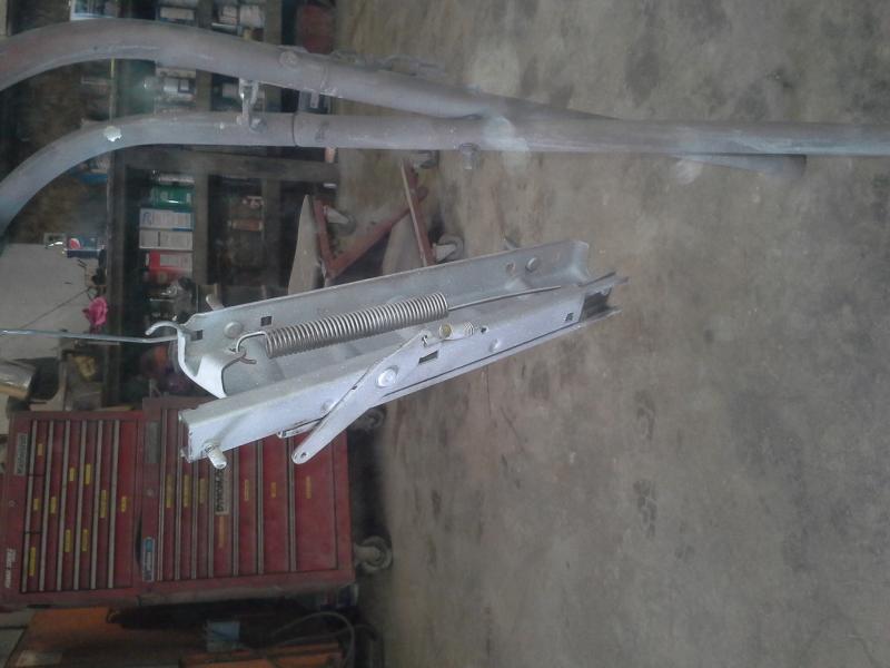

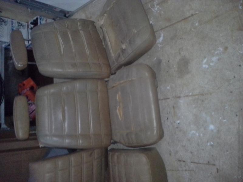

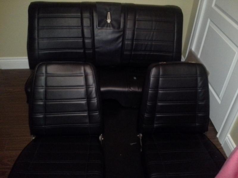

Spent a little more time at the roadrunner, I got my hp manifolds blasted and painted, the seats re cushioned and re covered.

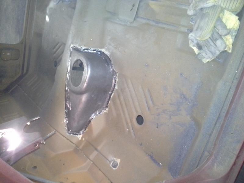

I also installed the 4 speed hump and console brackets, hopefully I will get the underside of the floors epoxy primed within the next couple of days

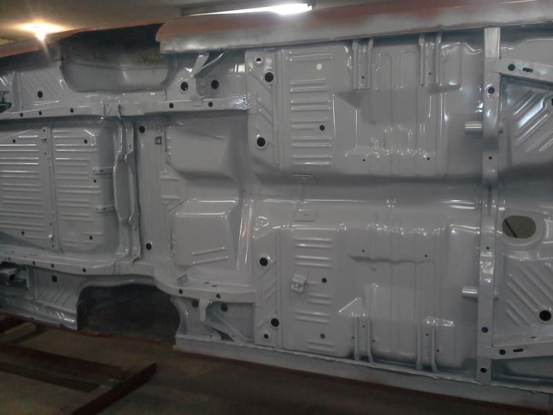

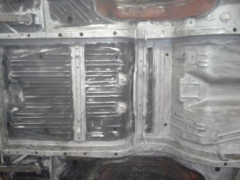

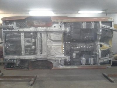

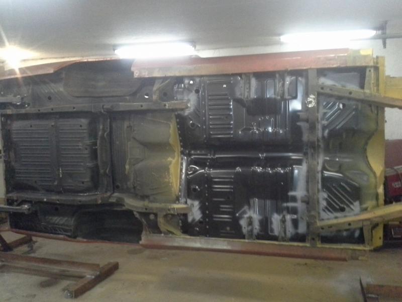

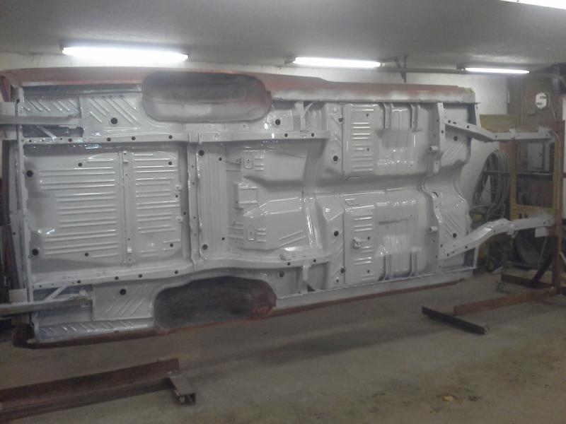

Floor bottom in epoxy

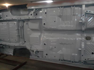

Got the frame rails and all other areas of original metal underneath the car media blasted and sanded out the new floor pans. Then I sprayed epoxy. I still have to do work on the wheel houses.

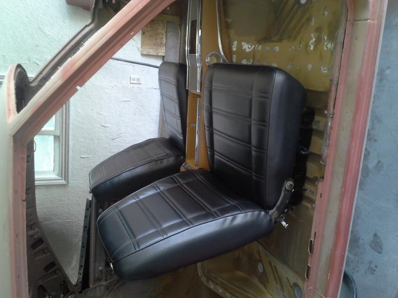

Seat brackets blasted and painted, console and seats fitted
Got the seat brackets blasted and painted, then I test fit the seats and console to make sure the console brackets are in the right spot, so far so good.

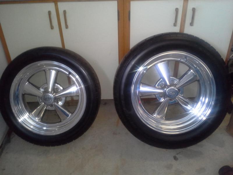

I decided to polish up my wheel and tires before they are out away, they had a lot of overspray from the previous owner.
295 45 18 in the rear and 235 45 17 up from , cragar ss wheels
