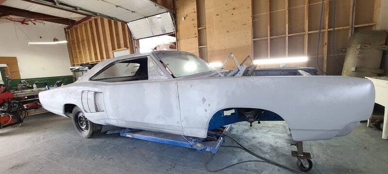

Rotisserie free. Kinda looks like a car now

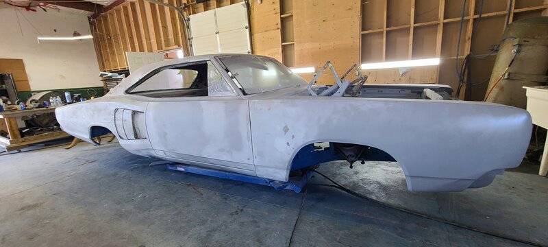

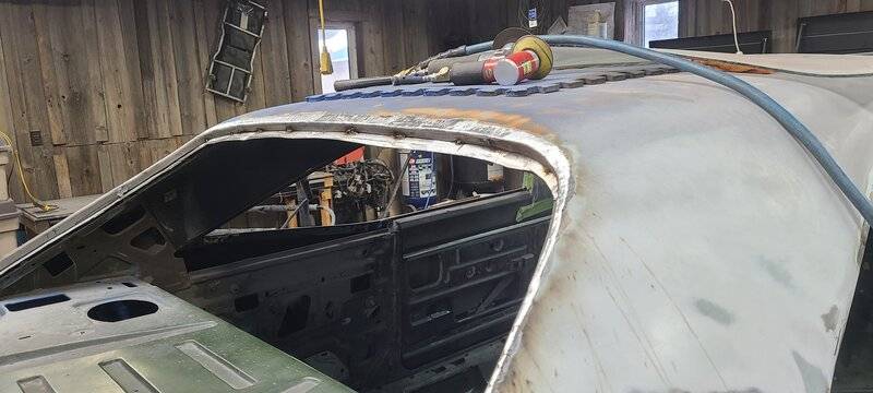

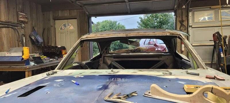

It's been a long time since I posted. I've been working on other stuff but still picking away on the bee. I flush-mounted my windows and now I'm putting my bumper on a diet so that I can add a valance

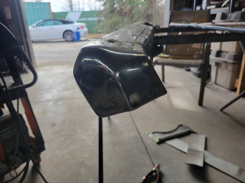

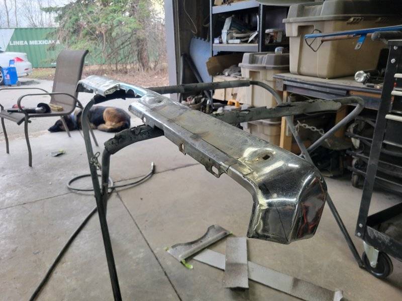

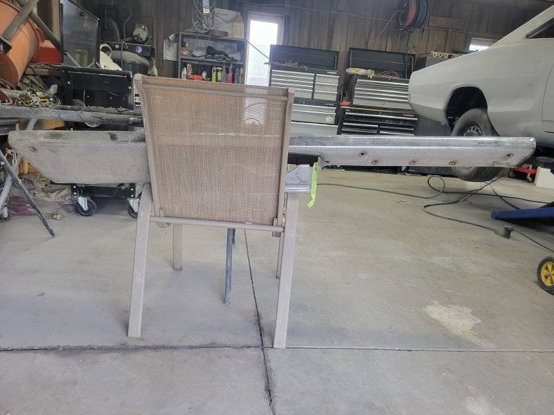

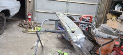

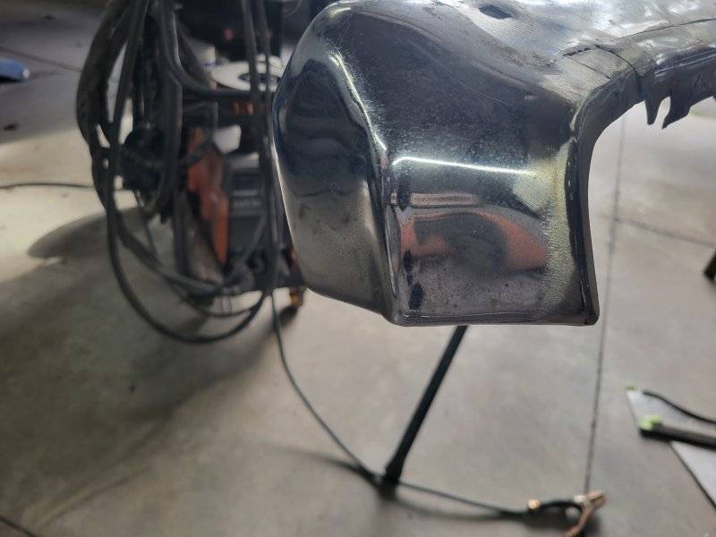

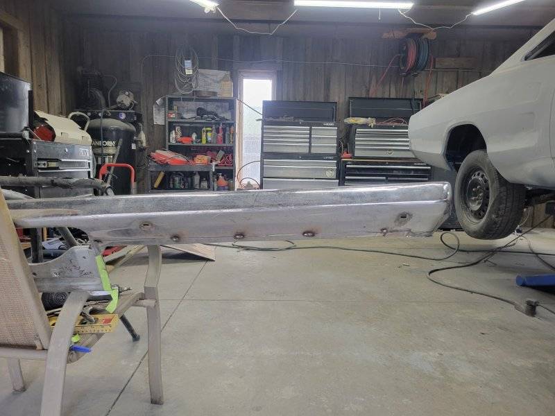

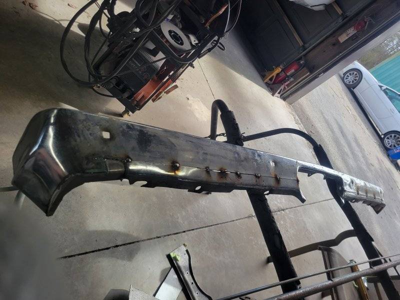

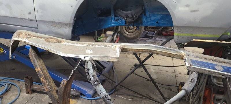

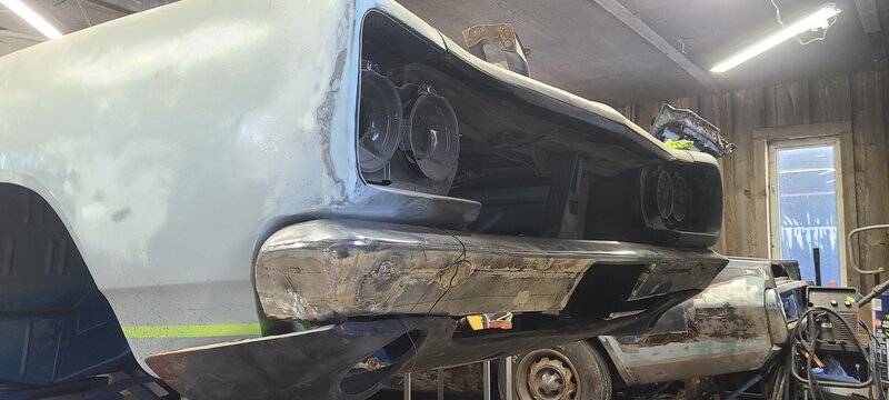

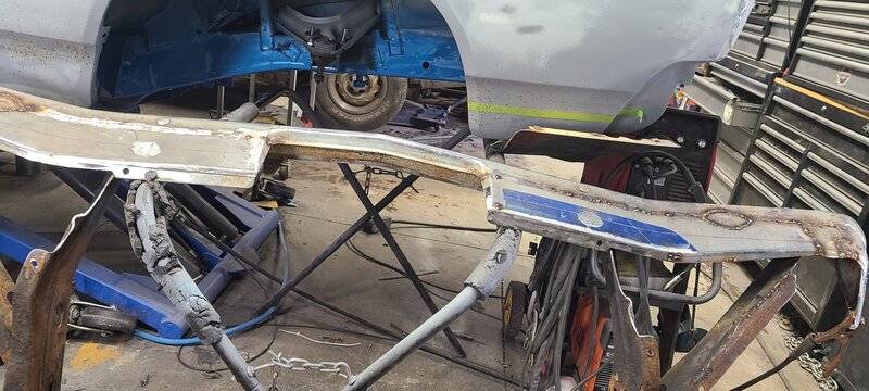

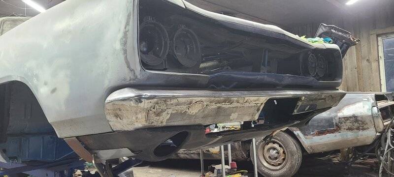

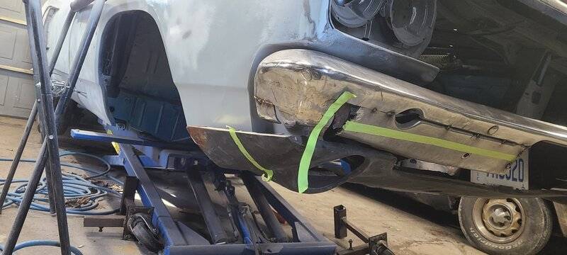

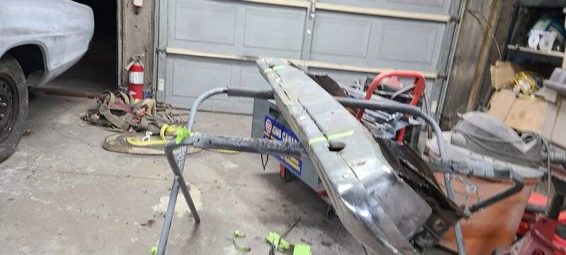

I need the rear bumper to match the front bumper. I was going to put a roll pan on the back of the car but I don't really like how it's going to look in the end so I'm going to turn the roll pan into a lower Valance and put this bumper on a diet. I'm cutting 5 inches out of the bumper. In the pictures you can see the original size and the new size

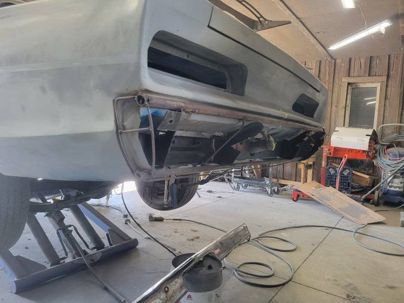

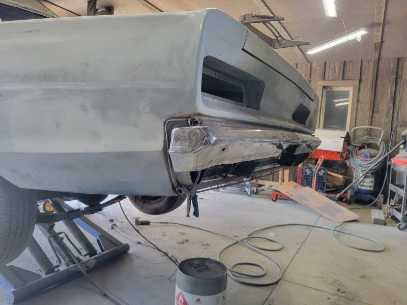

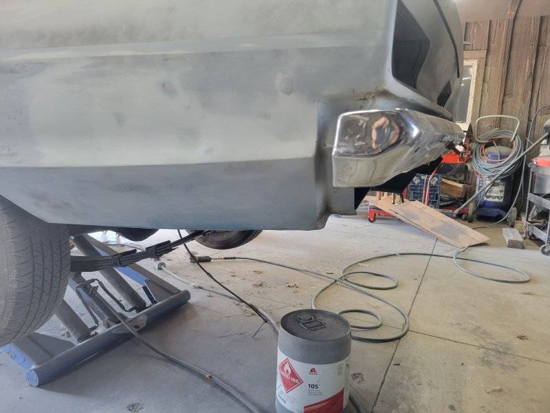

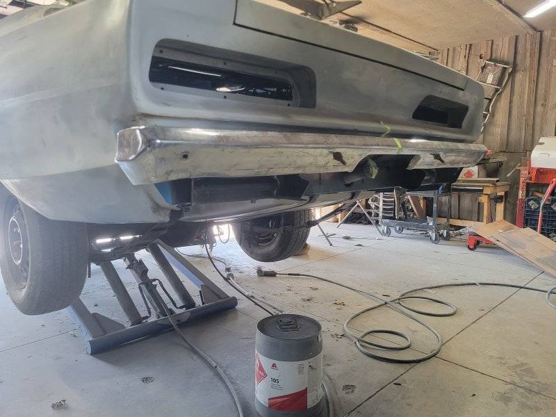

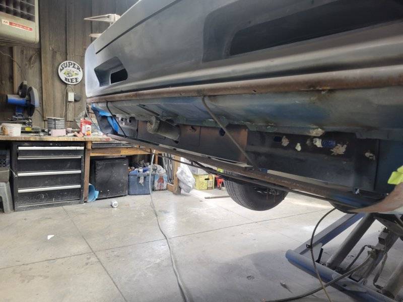

Looking at the way the bumper fits there's not really a way to move it forward and up to put it tight to the body because it will throw off the body line in the side of the bumper so what I'm going to do is use my original roll pan that I made and I'm going to make a filler panel something like a 69 Charger where the bumper is embedded into it so it fits nice and has nice clean lines with no Gap
I had no intention to put the back bumper brackets or the back bumper on the car with the piece that I made. But for some reason it fits perfectly and snug and I didn't have to modify it at all to make it fit with the bumper and brackets
Leave the body line in the bumper but cut and add to the top. That move it closer in and closer to the top.

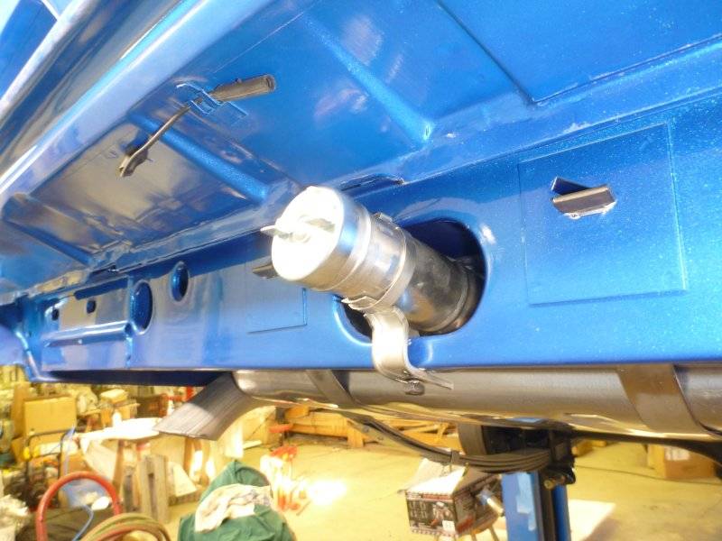

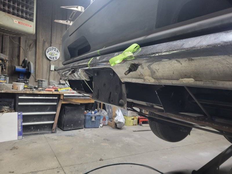

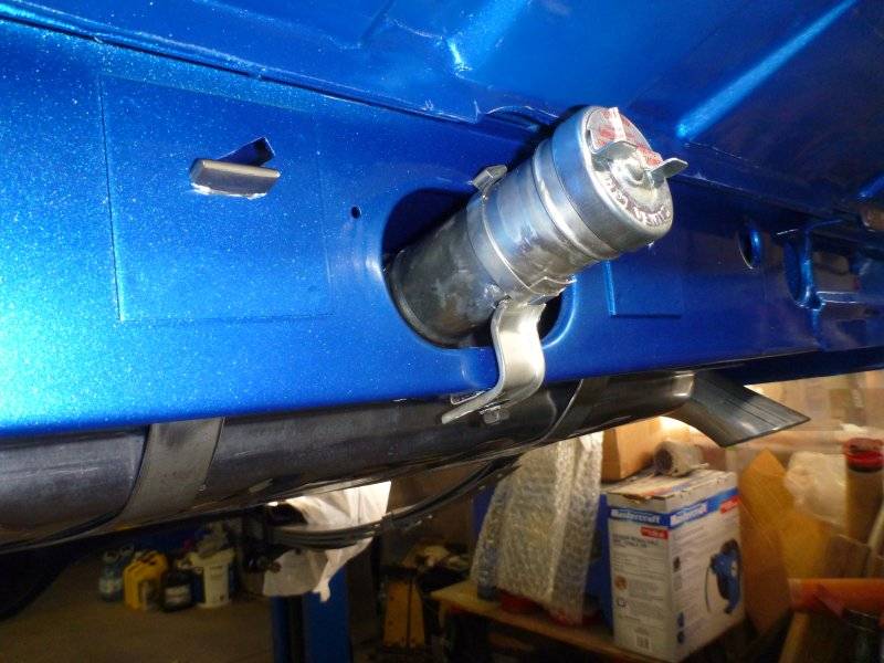

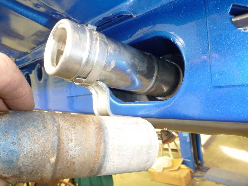

Trying to figure out my license plate Mount. If somebody reads this and has the same design car if they could post a picture of how far the gas filler next sticks out past the crossmember I would appreciate it. I know I can put it in further but I just don't know what will work at the pump.

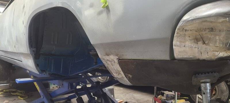

This is not the final position but I just wanted to attach it temporarily to visualize it
