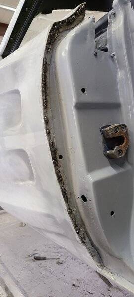

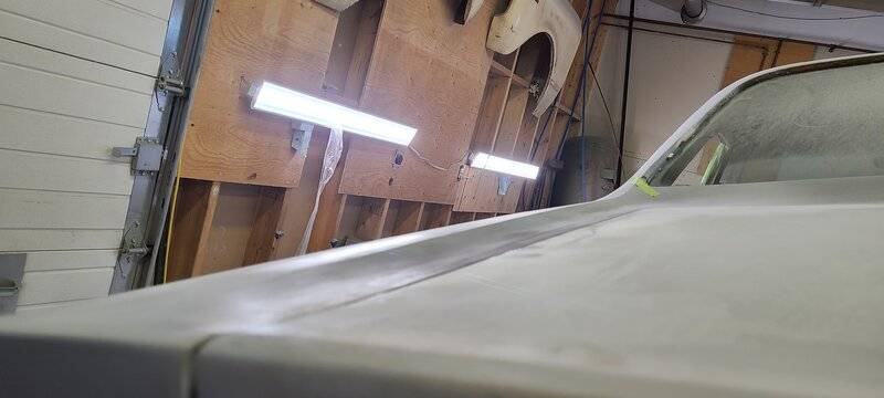

I did get it mostly done. I still have yet to fix it at the front where it meets the door because there is a big gap where the factory drip rail overlapped the area. once I get my doors fitted then I can finish that part.
Its on my list of want to do jobs, just not sure on how to do it. Looks like youve nailed it!

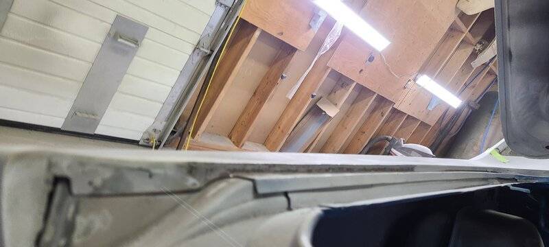

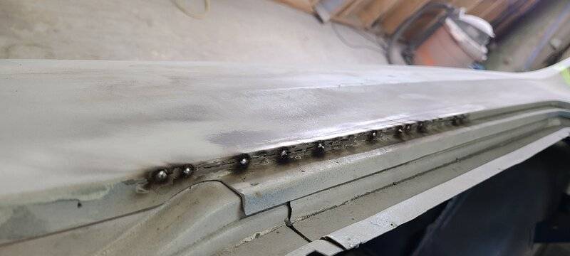

Well I cut off the drip rail very close to the outer edge. Then I took 1/2 inch flat stock and shaped it to match the contour of the piece I just cut off, tack welded that to the bottom of the pinch weld then ground down the pinch weld to make it flush to the flat stock. After that I finished welding the full length jumping around to make sure not to create too much heat. then made a strip to bridge from the roof to the edge I created.
I hope all of that makes sense. If you need me to elaborate feel free to ask

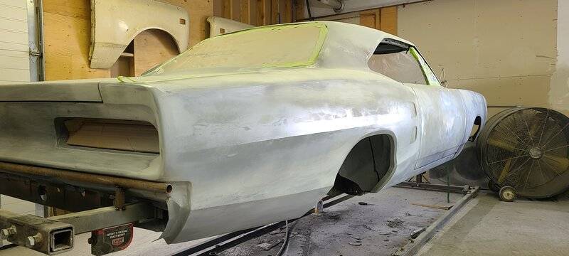

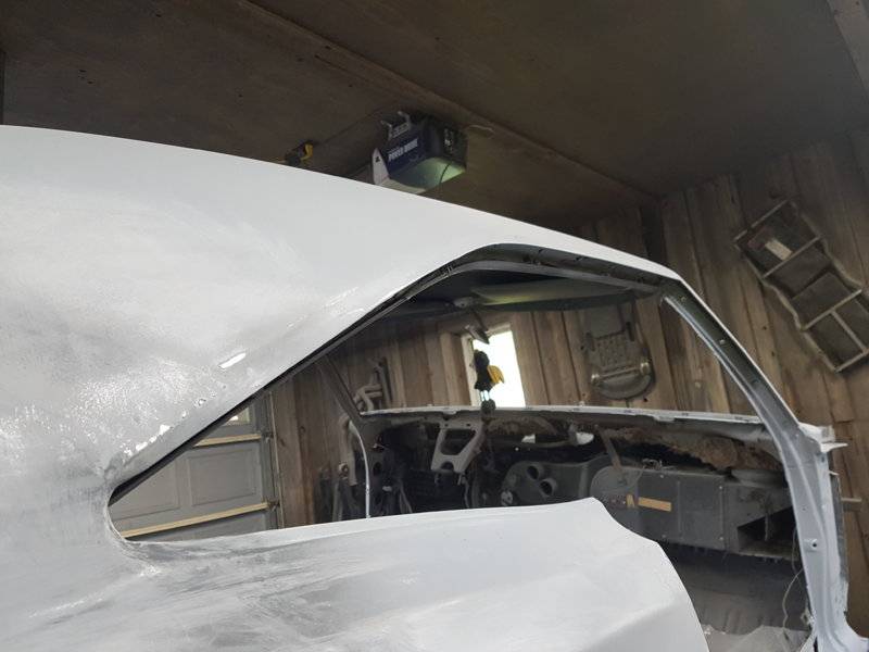

Just thought I would update my old thread. I'm still working on the Beast and I'm hoping to have it off the rotisserie in about a month once I get the bottom of the car painted and all my body work done. I still have to rework the front and rear window openings so I can flush mount my windshield and back window.

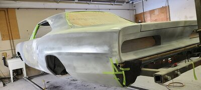

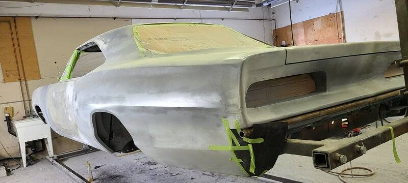

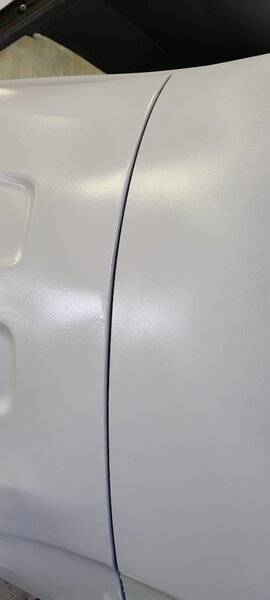

all this work because the quarter panel was a 16th of an inch higher than the trunk lid. I wish I could just settle sometimes for something not quite perfect
I applaud you for your ability to make that specific of a adjustment. While building mine I had to keep reminding myself that it does not have to be perfect. It just kept stressing me out thinking about having to make everything absolutely perfect. I mean these cars did not come from the factory in perfect condition. I was trying to live up to a standard that’s been exaggerated by all of these TV car shows. I built mine as a daily driver not a trailer queen. I am more of a rust valley restoration level guy. Great work!!!
I like that show as well. I have OCD which will make me see every flaw when the car is done and I would not be satisfied with it. I applaud people that can leave certain things as they are.

Here is the quarter panel I was aligning to the door the other day
Being as picky as I have been it feels like there is no finish line in sight. Hopefully some day I will run out of things that I feel I need to correct.

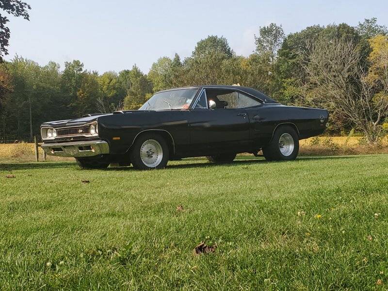

Love the car, man. I was looking for a B5 Bee with a white stripe and no vinyl when I found my Triple X9 Bee. Is yours a 727 or 833? It looks like it will be badass when done.
It's a 727. Thanks for the support.

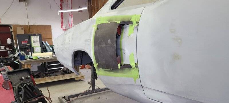

Things are about to pick up the pace as I now am on this car full time, even though I spent the last 3 days building a new workbench. Time sure flies when you have so much to do.
Template made up for custom side scoops. I thought about going with the stock Scoops but I don't really like them so I'm going to design my own

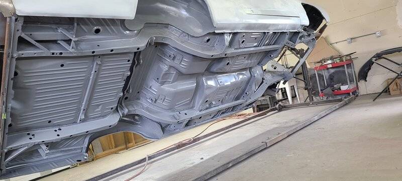

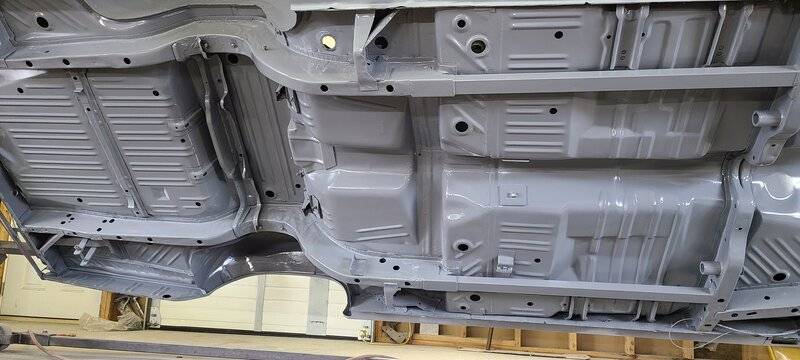

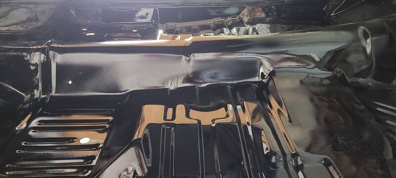

I decided after Chasing several problem spots in the floor pan to just replace it. I cut the old one out and butt welded the new one in for a cleaner look

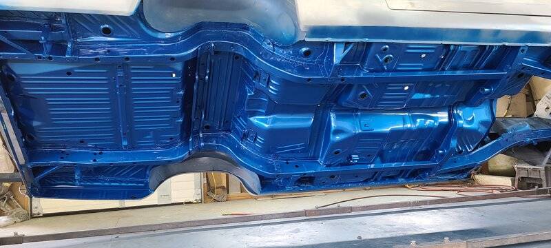

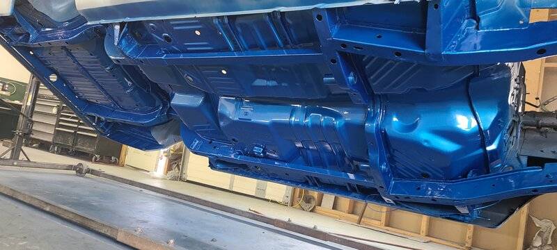

Today I got the epoxy on the bottom of the car. Now it's ready for paint
