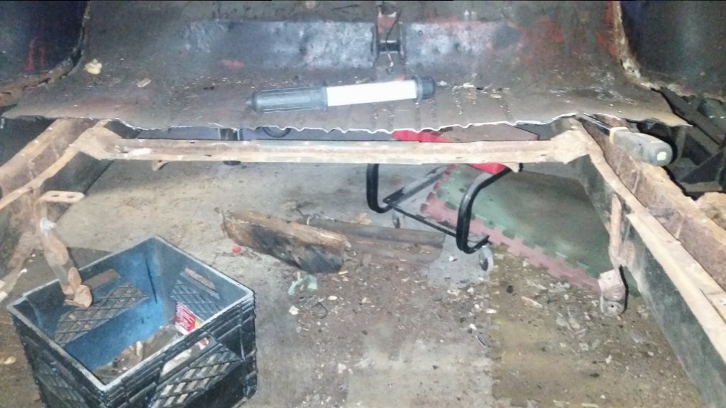

Now if I can only find the rest of the spot welds if anyone has a picture of a trunk pan that has already been removed, feel free to post that picture

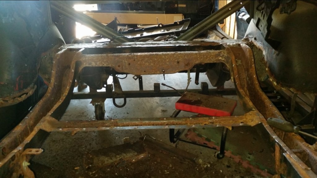

So while I was getting out the old trunk pan tonight, I noticed the trunk pan has been painted red by what looks like the factory as well as the wheel tubs but the car was Green from the factory this doesn't make any sense to me....update. turns out someone painted a trunk red on a green car....very Christmas like.

I hate this trunk pan. Been trying to remove it since this morning
Trust me Bro, ain' NUTHIN more painful than passing a kidney stone, however, the hit in your wallet might come close;-) !
Keep pressing on,it is going to be worth it!
been there done that don't want to do it again LOL.

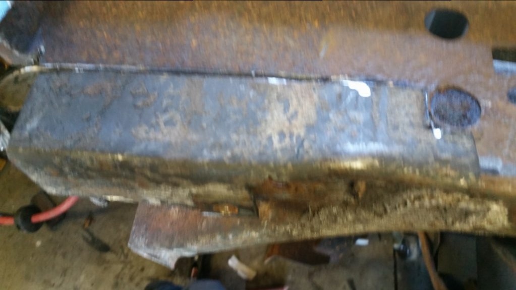

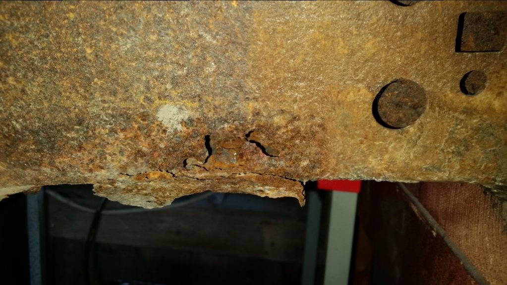

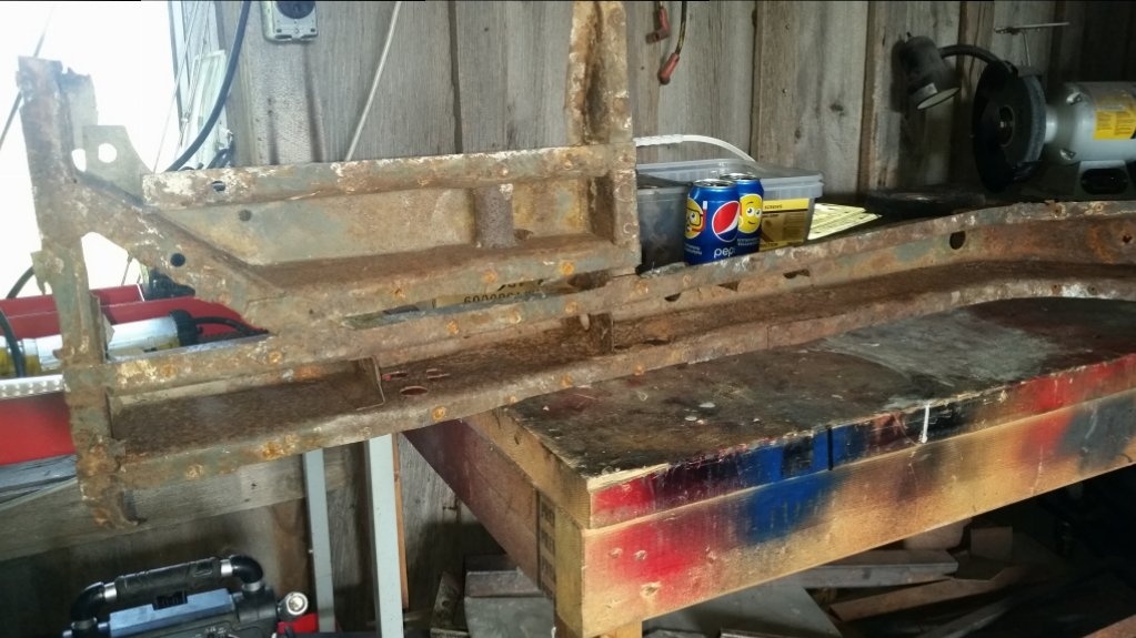

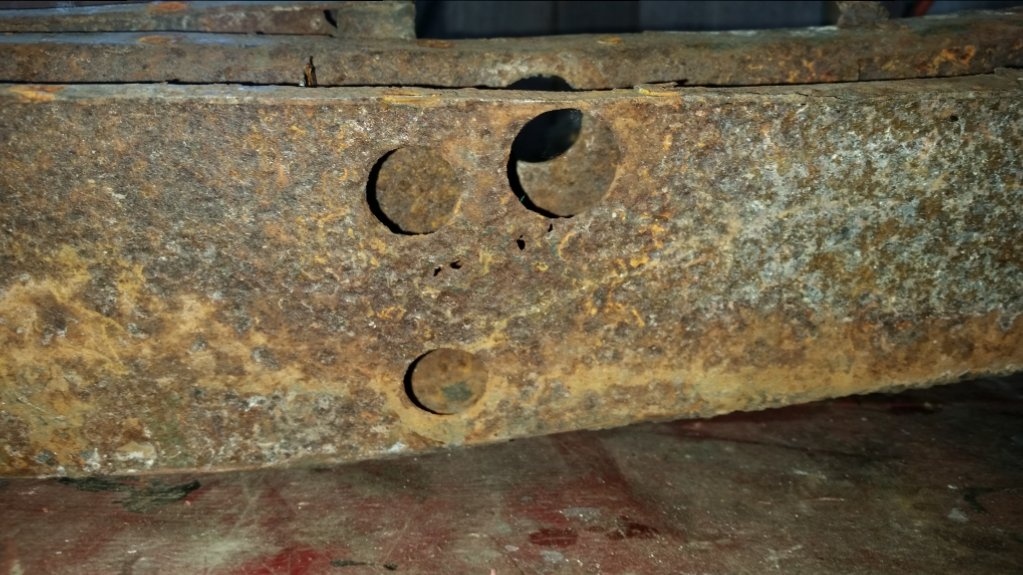

Okay on to the next project turn one ugly frame rail into a sexy frame rail
Break time watch the puppies play for a while

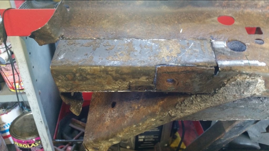

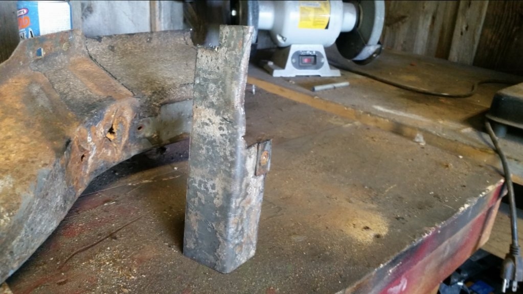

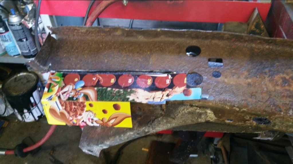

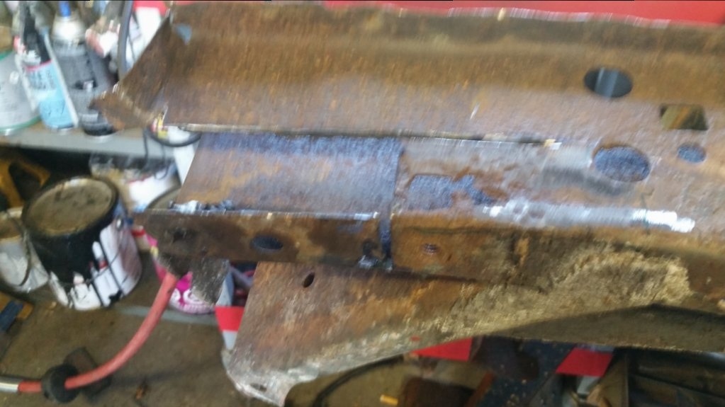

Okay so how to fix the frame. First I made a template of where I needed to replace metal then I cut it out of a cereal box then I transferred that pattern to the other end of the frame I'm not using and cut it up a little bigger than I needed it. then, I am cutting the bad area out of the old frame bit by bit and test fitting the new piece until it fits perfectly and then it will get welded in
There's one nice fitting patch now it just needs to be welded in
WTF??, I was cutting out the old trunk pan today and I found a piece I don't have to replace!! The gas tank brace is beautiful. Things are really going to change for me now in life.View attachment 340771
