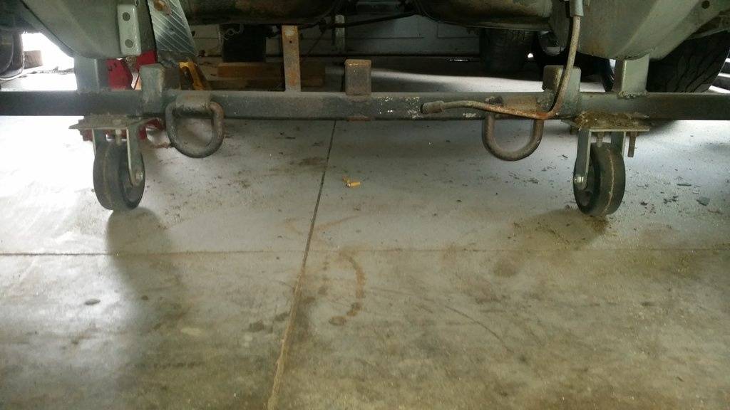

  4. yalpngulp
    yalpngulp Well-Known Member
    Messages:
    169
    Likes Received:
    95
    Joined:
    Nov 18, 2011
    Location:
    ontario
    Local Time:
    5:32 AM
    this is my homemade dolly I was talking about

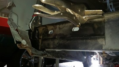

    I've been trying to find information on the holes in the frame rails at the back but I'm not having any luck. does anyone have any idea where I can find what bolts up to what hole?
  7. moparnation74
    moparnation74 FBBO Gold Member FBBO Gold Member
    Messages:
    9,965
    Likes Received:
    16769
    Joined:
    Mar 27, 2014
    Location:
    OHIO
    Local Time:
    5:32 AM
    Can you take pics and point out what your talking about?
  8. yalpngulp
    Messages:
    169
    Likes Received:
    95
    Joined:
    Nov 18, 2011
    Location:
    ontario
    Local Time:
    5:32 AM
    View attachment 436771 the holes in the side of the frame shown in this picture

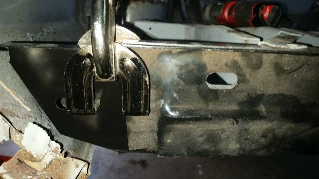

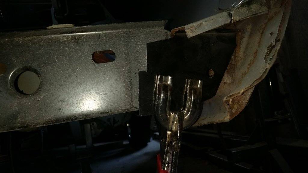

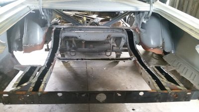

    I realized I have no idea how to assemble the rear cross brace with the bumper reinforcements and end pieces. since mine were rotted when I dismantled the car, I never saw how it is supposed to look. Also, When I clamped it to the rear of the frame rails, my trunk extension was resting on the edge of it, is this normal?
  10. yalpngulp
    Messages:
    169
    Likes Received:
    95
    Joined:
    Nov 18, 2011
    Location:
    ontario
    Local Time:
    5:32 AM
    I don't know if this is correct or not. I have the end piece sandwiched between the cross brace and the bumper reinforcement. and is that ebd piece supposed to be touching the quarter panel? can I just go ahead and weld this up like this?

  12. Super Rob
    Super Rob Well-Known Member
    Messages:
    197
    Likes Received:
    113
    Joined:
    Jan 23, 2012
    Location:
    Hamburg - Germany
    Local Time:
    5:32 AM
    That end piece should be connected to the trunk extension, not to the quarter panel.
  13. yalpngulp
    Messages:
    169
    Likes Received:
    95
    Joined:
    Nov 18, 2011
    Location:
    ontario
    Local Time:
    5:32 AM
    So does the end piece get sandwiched between the cross brace and the bumper reinforcement?

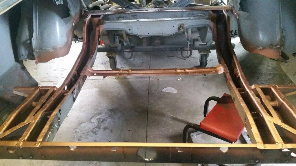

  16. yalpngulp
    Messages:
    169
    Likes Received:
    95
    Joined:
    Nov 18, 2011
    Location:
    ontario
    Local Time:
    5:32 AM

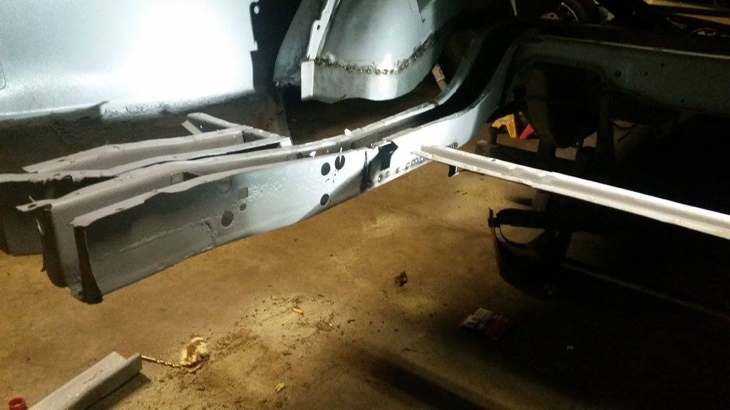

    the rear cross brace is on and I coated the inside of the frame rails with por-15. hopefully the next picture I post will be of the trunk pan installed.
    Before I can attach it, I need to determine if I need all three holes that are in the bumper mounting area as I only have nuts welded on the first and third hole.
    tmp_17450-20170723_133221-1104930868.jpg and copper weld through primer on frame and pan tmp_27312-20170723_182628-1104930868.jpg

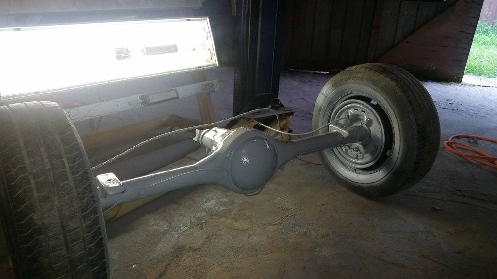

  17. yalpngulp
    Messages:
    169
    Likes Received:
    95
    Joined:
    Nov 18, 2011
    Location:
    ontario
    Local Time:
    5:32 AM
    got the rear differential blasted and primed
