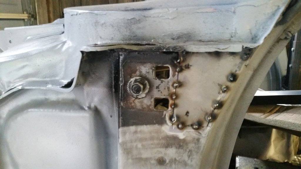

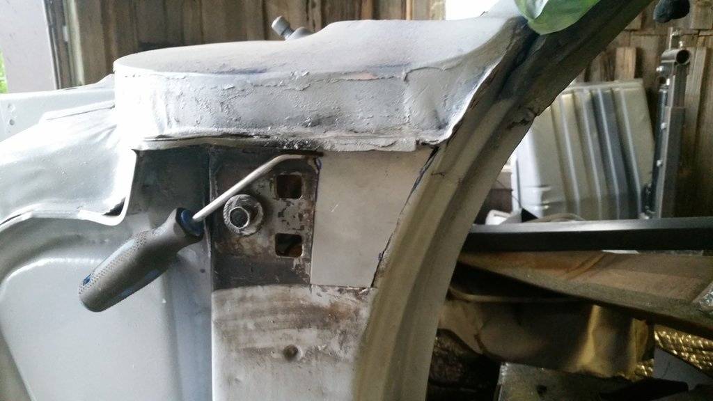

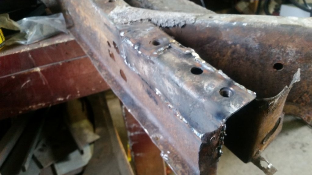

      Haven't worked on the car for a few days because I've been busy. I got the piece welded in to the frame. holes drilled in stock location and nut welded in. Now just some grinding and blasting and it's ready to be installed 20160607_174207.jpg

      20160607_205716.jpg Done. On to the next chapter

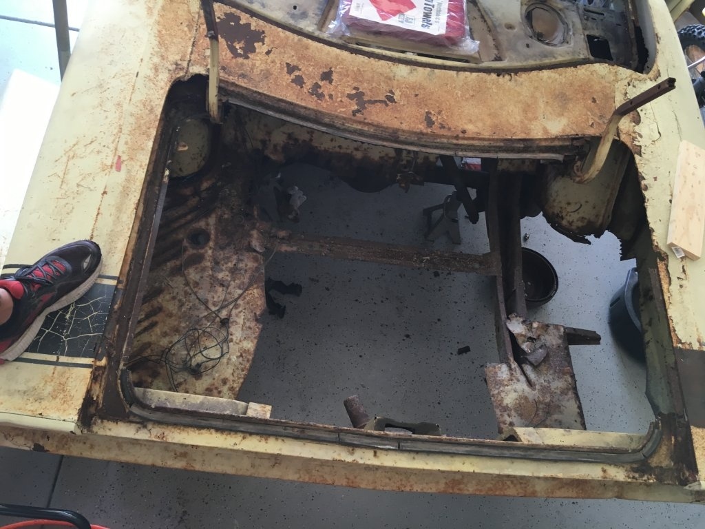

      image.jpeg image.jpeg image.jpeg Great post! So good to see another 69 Bee restoration. I have almost exactly the same process ahead of me. Mine is yellow and black. All numbers matching.

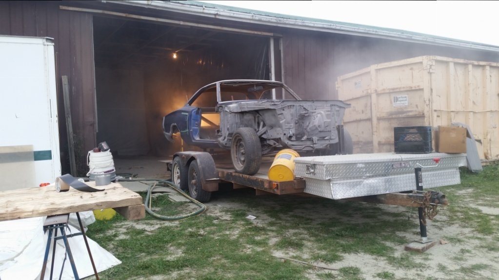

        Finally some progress. We blasted most of the car today to expose all its hidden secrets. I'm going to finish the epoxy primer tomorrow and get some up close pics to post. Here it is after blasting.

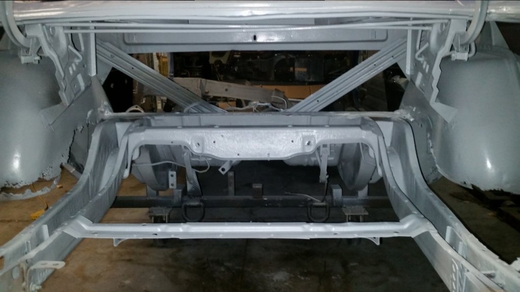

        Back section primed.

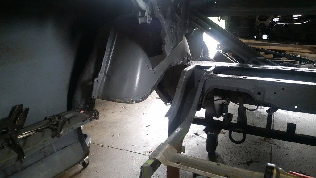

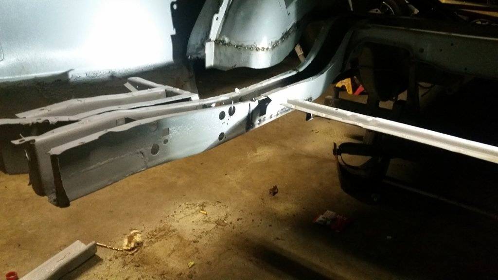

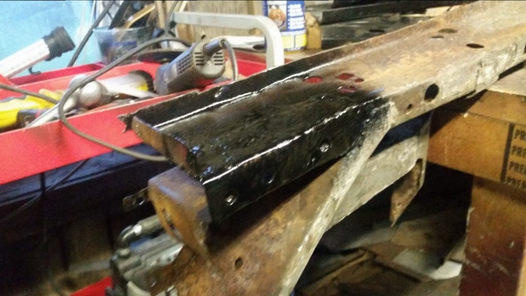

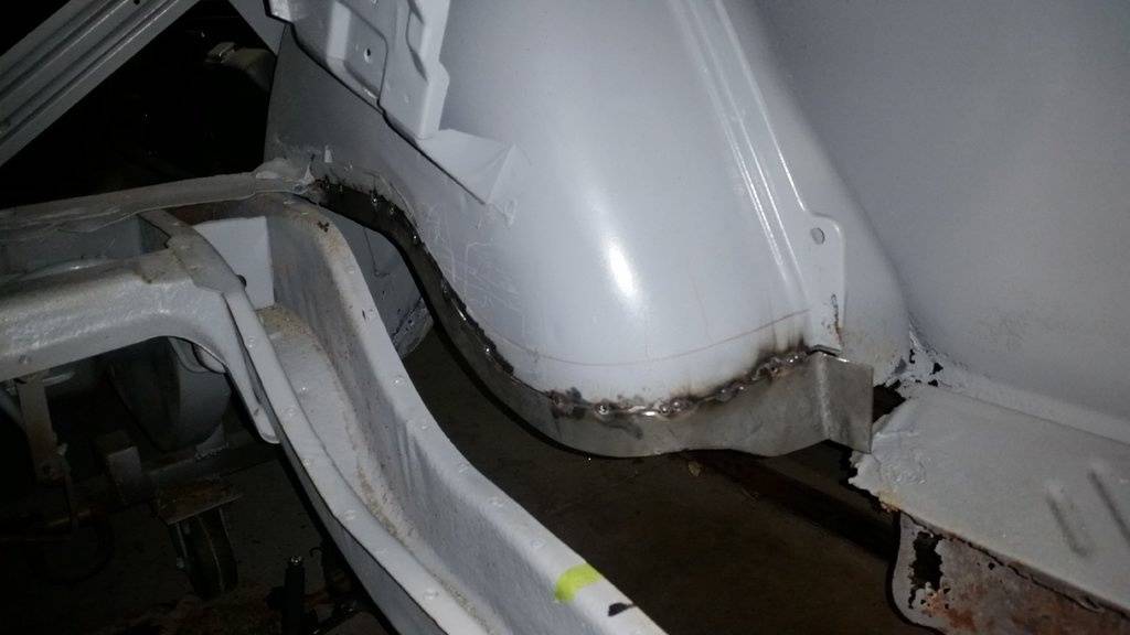

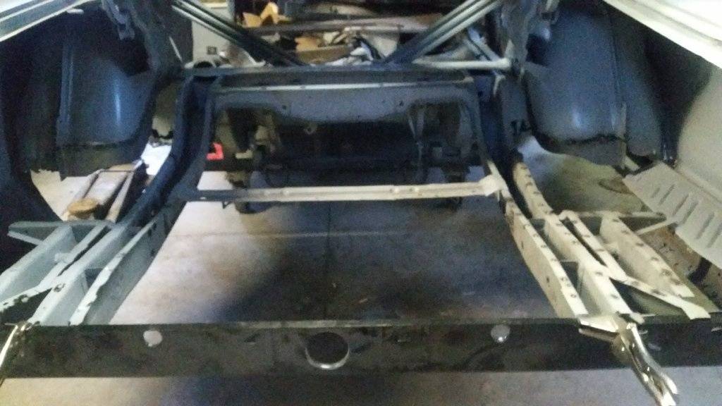

          Made some headway in the last couple days. 1 wheel tub patched and 1 frame rail tacked into place.
          tmp_16539-20170617_141245-2104116783.jpg tmp_16539-20170617_1737561593670088.jpg tmp_16539-20170617_2314181184303014.jpg

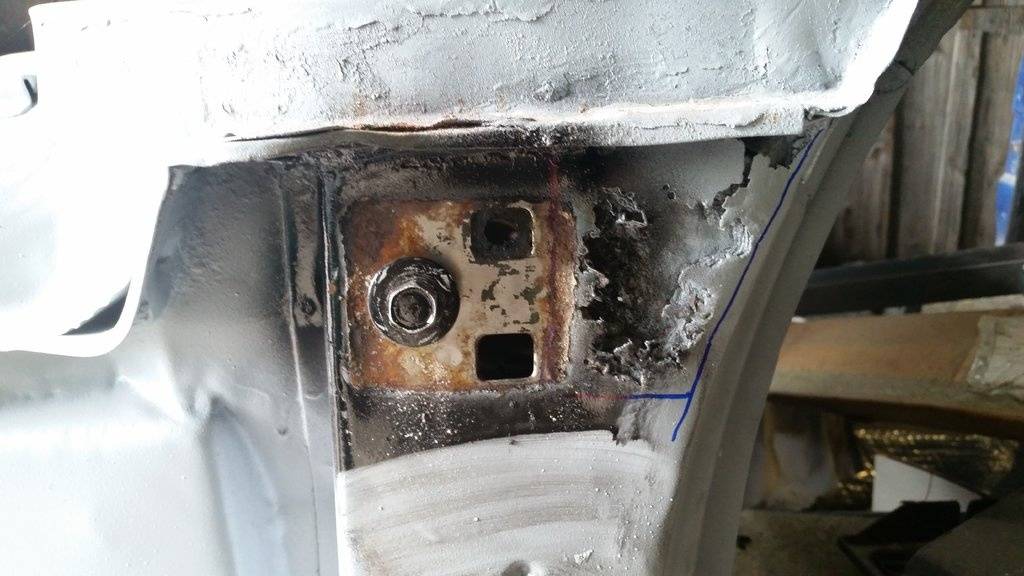

            Door post patched
            tmp_27859-20170618_171050-2104116783.jpg tmp_27859-20170618_1824161593670088.jpg tmp_27859-20170618_1834351184303014.jpg

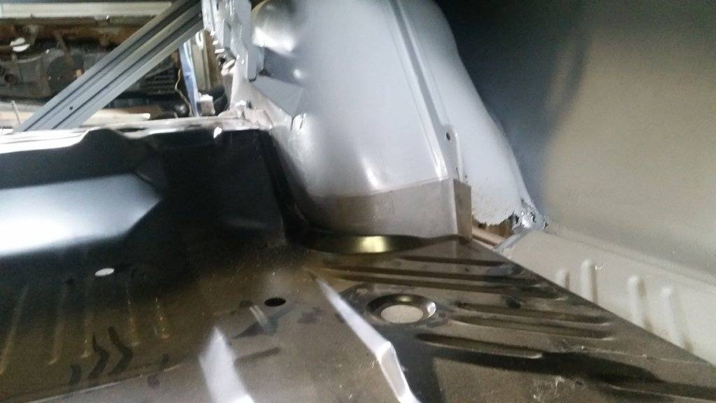

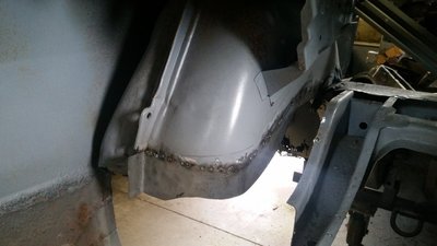

                Test fit and patched passenger wheel tub
                tmp_4247-20170707_134818522915389.jpg tmp_4247-20170707_213548-2083886454.jpg

                  2nd frame rail is attached. now to clean up some stuff with the grinder, a little more welding then SPI primer and then ready to put the trunk pan in. once that is done I'm hoping the car has enough structure to put the differential back in so that we can roll it back up to my other shop and finish media blasting. does anyone have an opinion as to whether it will be wise to put the rear end back in and the car back on its Wheels without a tail panel?

                  All the weight on the springs from the differential is more forward. So the most weight is near the front shackles were your bracing is intact. That is why we do not need traction bars! lol....
                  Your issue is not when it is on the ground it is getting it to the ground. So install it in a way that puts the rear end in without stressing the body by its weight. Basically, jack it from the pumpkin....
                  Or you can get the caster setup from US car tool. For your restoration they would be ideal...If you were closer I would let you borrow mine...
