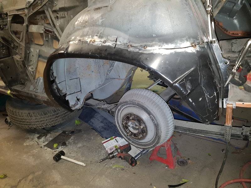

      Progress...i guess lol

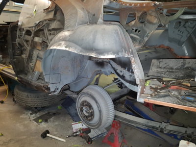

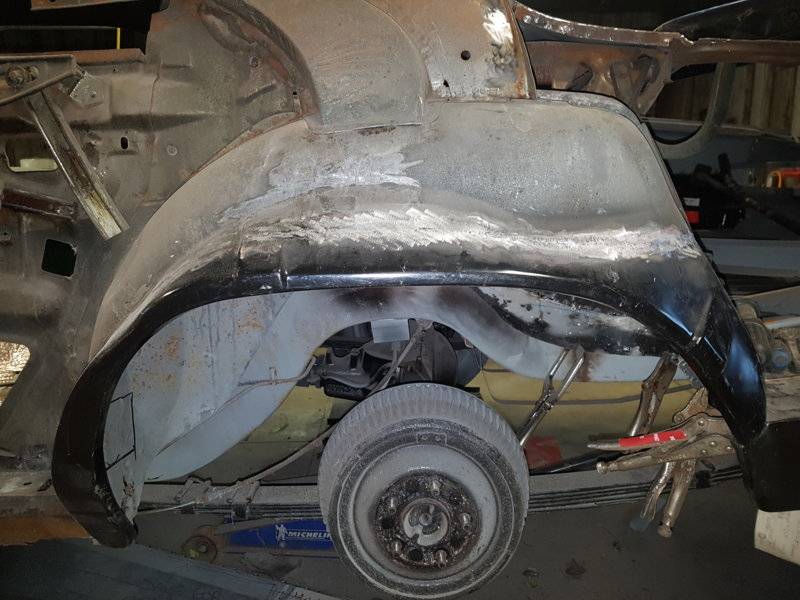

        Done butt welding both pieces. That was painful!

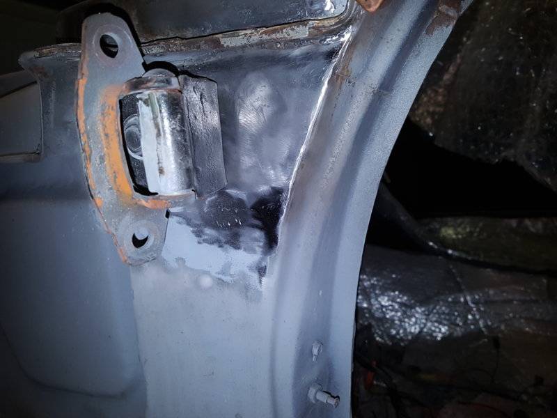

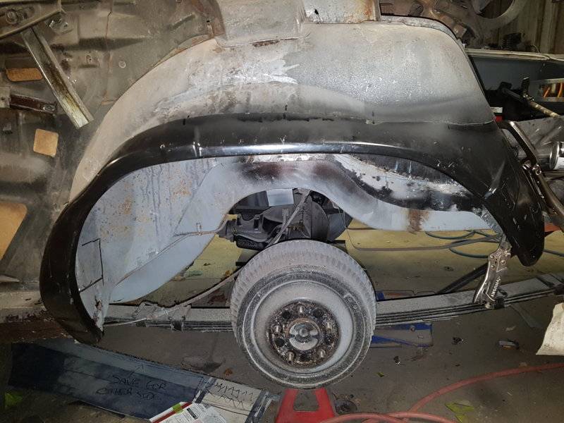

          Door post and inner fender area repaired

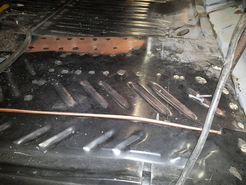

            Day 22.... taking out self tapping screws and Welding trunk pan in permanently

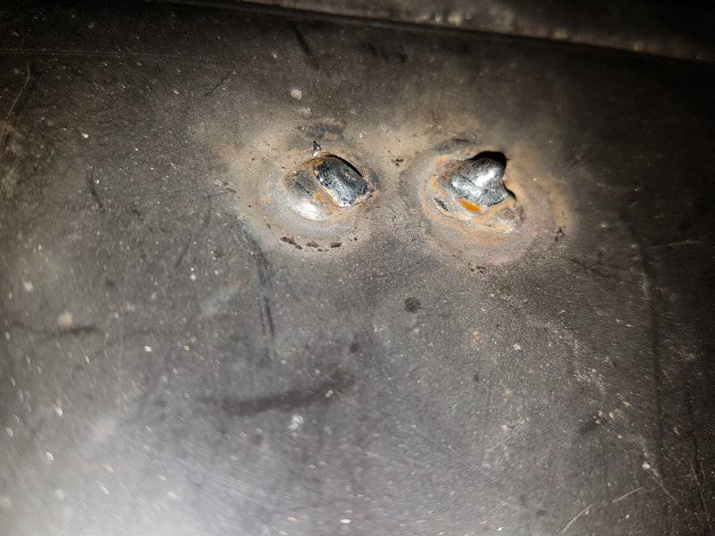

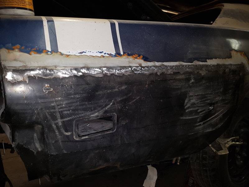

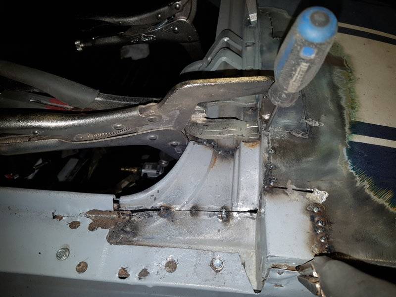

              Why is it that some of my welds lay flat and look so beautiful and then the other ones look like a five-year-old did it?
              This is the second day of laying in the trunk. I've been in there so long I feel like I'm homeless

              Looks like your welding through the edm and not cleaning it off prior to welding.
            • yalpngulp
              yalpngulp Well-Known Member
              Messages:
              169
              Likes Received:
              95
              Joined:
              Nov 18, 2011
              Location:
              ontario
              Local Time:
              2:54 AM
              I thought it would make enough contact just by drilling it out, should I be grinding it off first?
            • 5.7 hemi
              5.7 hemi FBBO Gold Member FBBO Gold Member
              Messages:
              11,661
              Likes Received:
              7936
              Joined:
              Dec 21, 2008
              Location:
              ca
              Local Time:
              2:54 AM
              I would do it just on the spots your gonna weld.

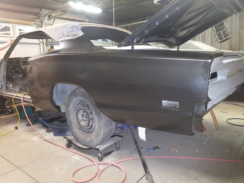

              24... fixing the mess at the top of the quarter panel

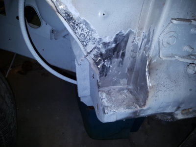

                Trying to make a patch for the front wheel Arch. it is not working out so good. I wish I could just buy a patch for this. Any suggestions would be appreciated

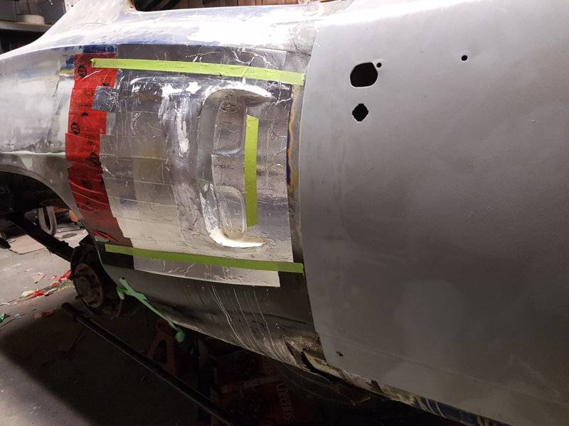

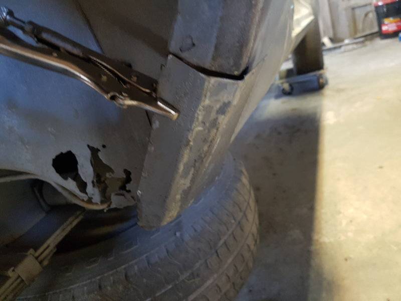

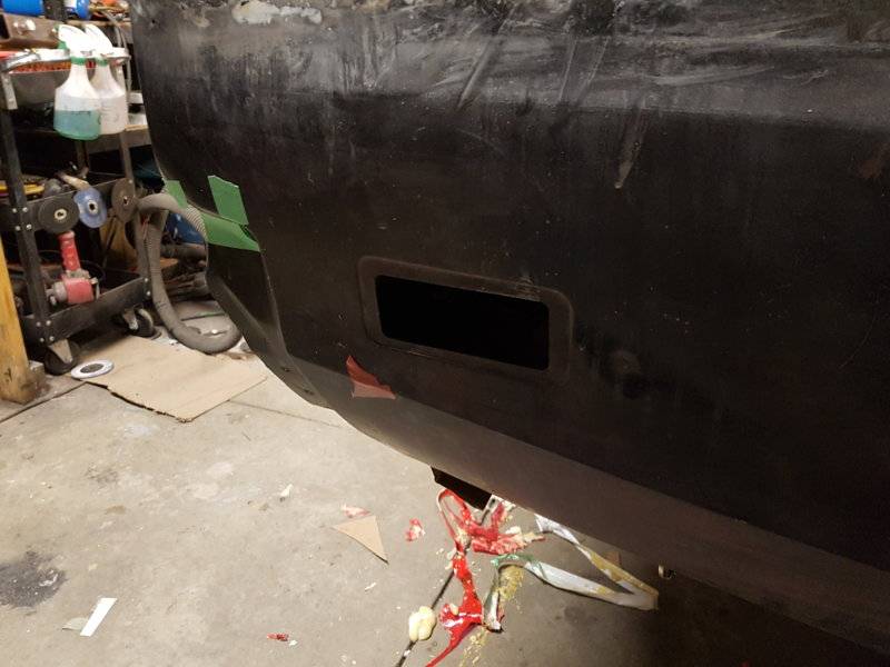

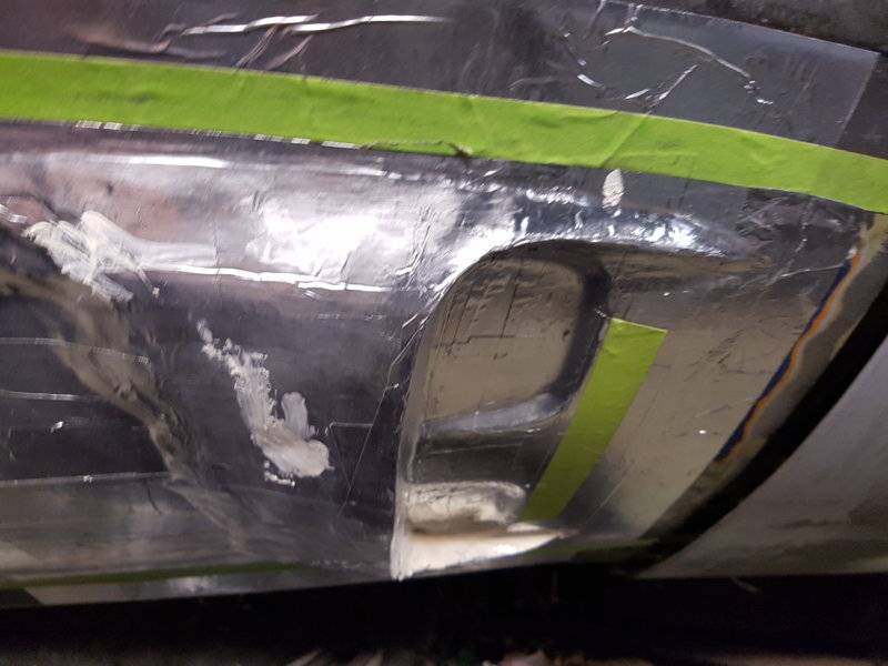

                  Day 29 -been working away. Lots of little things done just not much to show pics of. pic 1 and 2 is the shaved side marker and 3-4 is the beginning of making a mold for a custom side scoop
                  20190131_203442.jpg 20190202_001910.jpg 20190131_203547.jpg 20190131_203513.jpg

                      What I noticed is that if the molten puddle contacts the edm it will burn it away but if the arc directly contacts the edm, it blows a big hole and creates an erratic arc. I started cleaning the edm off of everything and the welds are much nicer.
                    • yalpngulp
                      Messages:
                      169
                      Likes Received:
                      95
                      Joined:
                      Nov 18, 2011
                      Location:
                      ontario
                      Local Time:
                      2:54 AM
                      Since 5.7 hemi suggested it, i have been grinding it, i still get random results so i blame it on the guy operating the torch lol. I just do alot more grinding in some places.

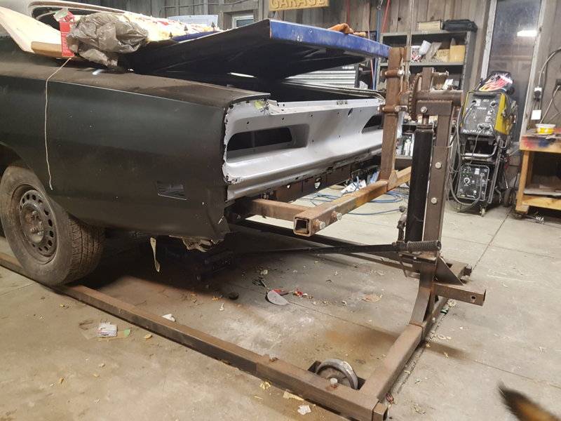

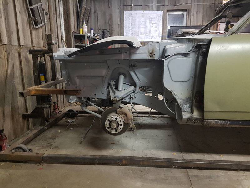

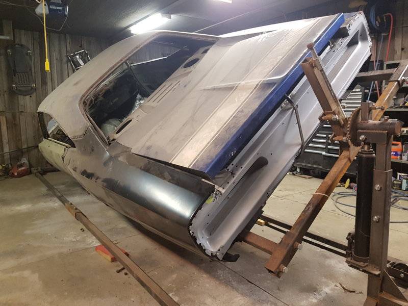

                      it's rotisserie time!! now I just have to wait until I have help to drop the K member and rear differential

                      I have waited 4 years for this moment :)
