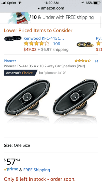

The 4x10 was used in the dash.

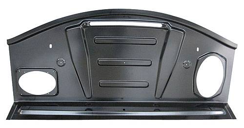

I assume some of the rear package trays came with 2 6x9 holes. Some with a 6x9 and a 6x4 Is that correct?

Here is an AMD repop package tray. Speaker on left is 4x6 and the one on the right is 6x9 I didnt think they had 2 6x9 holes.

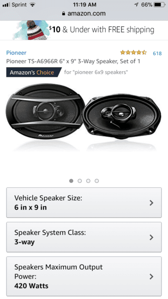

I have pioneer 6x9-3 ways in my 70 GTX. I mounted them BEFORE I put the rear glass in and the cover over the tray. I put 1 1/2" machine screws thru the tray from the top and lock nutted them in. I have actually changed them as the first set were cheap *** speakers. The lock nut set up made it easy to change from underneath. The 3 ways sound about a million times better, added some bass and midrange the cheap *** single cone jobs had.
I never remember Pioneer being the “Cheap” speaker but low priced would be accurate in my book. To me, they fit the need for the money, an inexpensive entry level decent sounding speaker. I don’t know how they have become in recent years.
