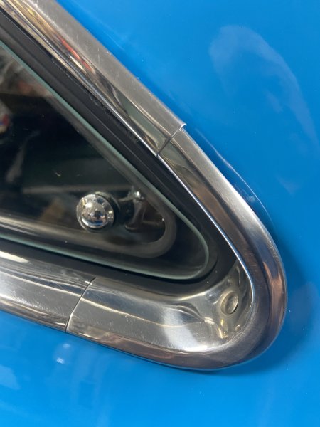

Does anybody have pics of the position of the ends of the drip moldings when they are installed? In particular the lower end of the windshield post and at the end the trim above the door where it meets the curved piece in back. Does the rail trim above the door overlap the curved piece in the back corner? Or reversed. With the new set I have, those seem to be about the same profile. Neither overlaps the other. My guess is that the short curved piece fits inside the longer piece above the door.

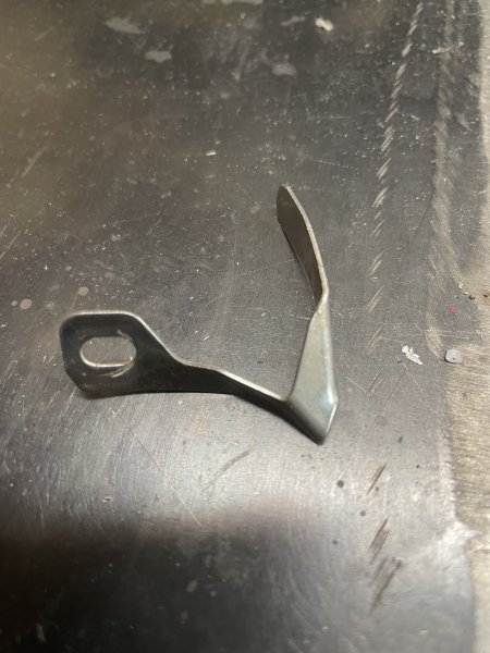

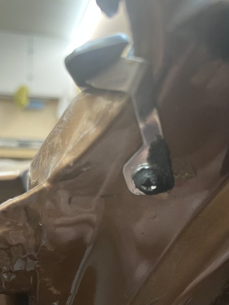

Sorry, one last request. Pics of the clip that secures the lower windshield trim as it wraps around the windshield post.

What kind of car? Pictures would help.
Here you go.
Thanks Mike that is prefect. Looks like the rear corner piece does fit into the longer drip rail piece. I will have to bend mine to fit. I can probably figure it out, but a pic of the clip that secures the lower windshield molding and where it attaches to the body would be nice. Looks like it screws in to the body.

Moulding snaps into clips that are screwed into the body.

I will get you picture this morning. I know what you’re for now.
