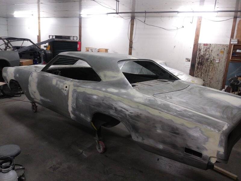

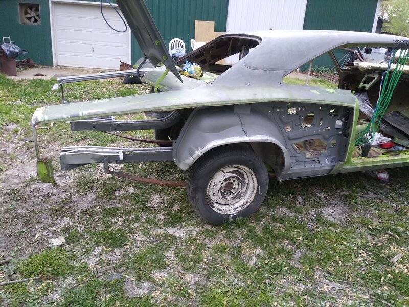

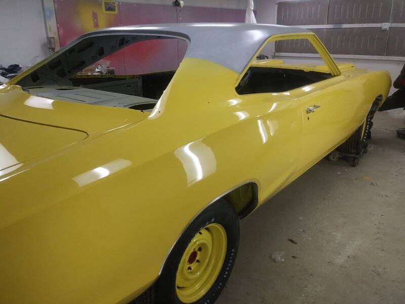

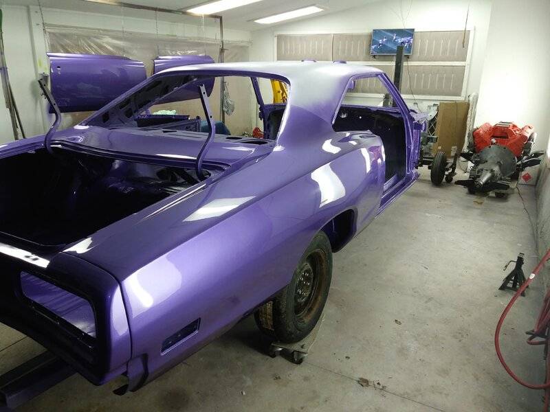

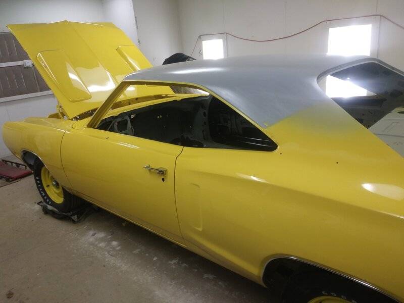

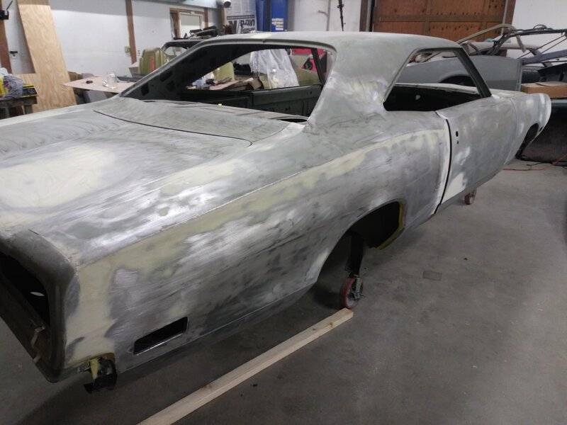

I've installed 3 sets of 70 skins over the past couple years, not sure where they came from.
I'm just used to working with what I have....... I like to keep the original "wrap around" areas into the door jamb and rear extensions; even the bumper recesses if possible
Eldubb, Thxs for the reply. You do nice work, cars look great. I've heard others say the same thing about butt welding them at the front and rear. Any opinions on the best paint brand/manufacturer, with the most accurate FC7 Plum Crazy paint? See a lot of bad matches out there.
