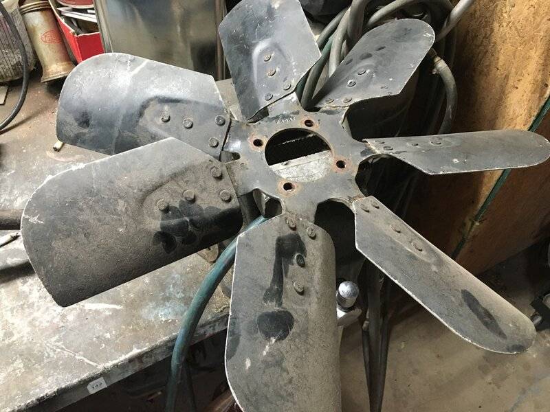

Got a 7 blade 19 inch not sure if it is GM or Mopar no numbers on it. If you can use it it’s yoursView attachment 1007553
Thanks for the offer, seriously, but I am hoping the electric fan works on the Roadrunner, and I have a couple of options for the GOAT.

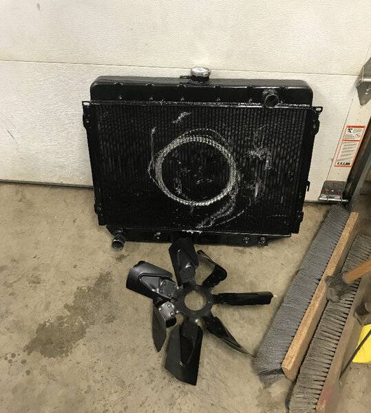

I can relate. See the photo. Those flex fans are junk, by the way. Save your money. As for the electrics, most of those don’t move anywhere near the air they’re supposedly rated for. I have yet to meet an engine that can’t be cooled with a factory HD 26” radiator, belt driven water pump, HD 7 blade fan and stock shroud.
Well, that is quite a mess.

Mine lacked clearance between the fan and the lower tank. You can see where the fan blades hit the lower tank, dug in and bent, tearing into the core. I clearanced the tip Of the new fan blades to clear that area.

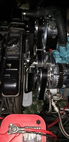

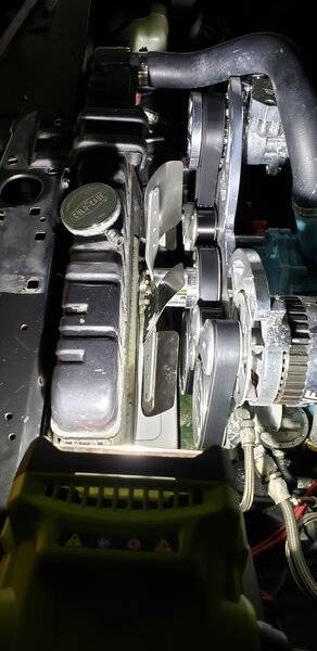

I had a buddy who owns an engine machine shop, that rebuilt our 421 in the GTO cut down the aluminum fan spacer to still clear the Wraptor pulleys and tensioner, but get it away from the radiator, because the factory radiator is all I have left.

I doubt I'll get the Cold Case radiator repaired, just because I don't want to be reminded of that tragic impact with the clutch of the other fan. The 17" flex fan fits fine, with 1¼" between the furthest forward part and the radiator. I got on it and did a dead stop launch or 2 and no contact with anything. I will check the clearance to the Cold Case radiator and if I get at least 1" clearance, I'll probably order another one and sell the one I have and the factory radiator too.
