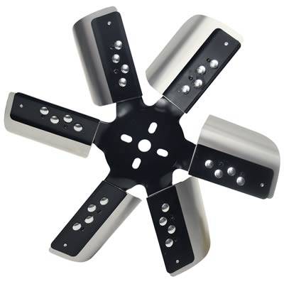

Now I'm looking for TWO 17" FLEX FANS because I have serious doubts about the 17" electric fan on my Roadrunner, and I only have 3" of space between the radiator and the Wraptor pulleys.

I am going to line up a 17" (or 18" whatever the largest diameter will fit) flex fan for the Roadrunner, in case I have problems with high temp cooling system issues.

Flex fans move a lot of air and cool well when properly setup in a shroud. They are dangerous however and love to break at high rpm. Mine sees 7400 all the time, but it pretty much flattens out at that speed.

If I can find 2 full bladed flex fans, I'm going to order 2, one for each car.
Like this: (blade position not necessarily correct, just for appearance and blade style)
The GTO has a polished aluminum Wraptor, so:
And the Roadrunner has a Black Diamond Wraptor finish, so:
BUT I'm not sure I can get them, anywhere, by Wednesday.

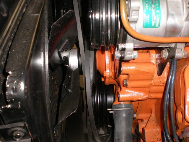

In my case, I wound up not having the desired 3/4" clear from fan to radiator even using the shorty
clutch, so I'm direct drive with only a small spacer. Fan half in/half out of shroud lip.
I used the fan from Summit that @coloradodave recommended (I want to say it's 18"?) and probably
could have gotten away with a 19" (shroud opening is 20").

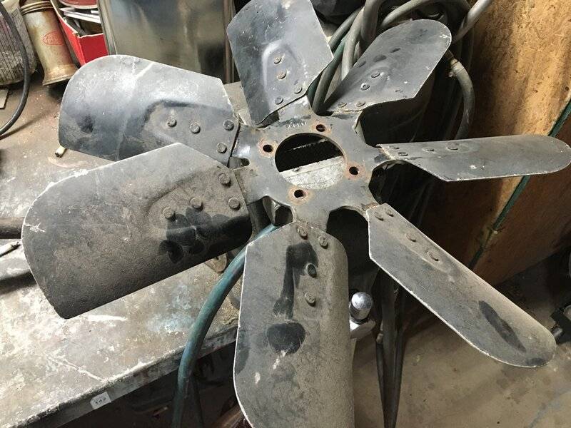

How about 62, three core, 7 blade,half way in the shroud,1" spacer.

*Install the 17" flex fan the guy had, and just gave me. It's the EXACT fan I wanted and can't find available immediately!

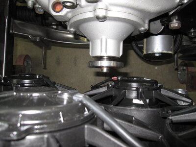

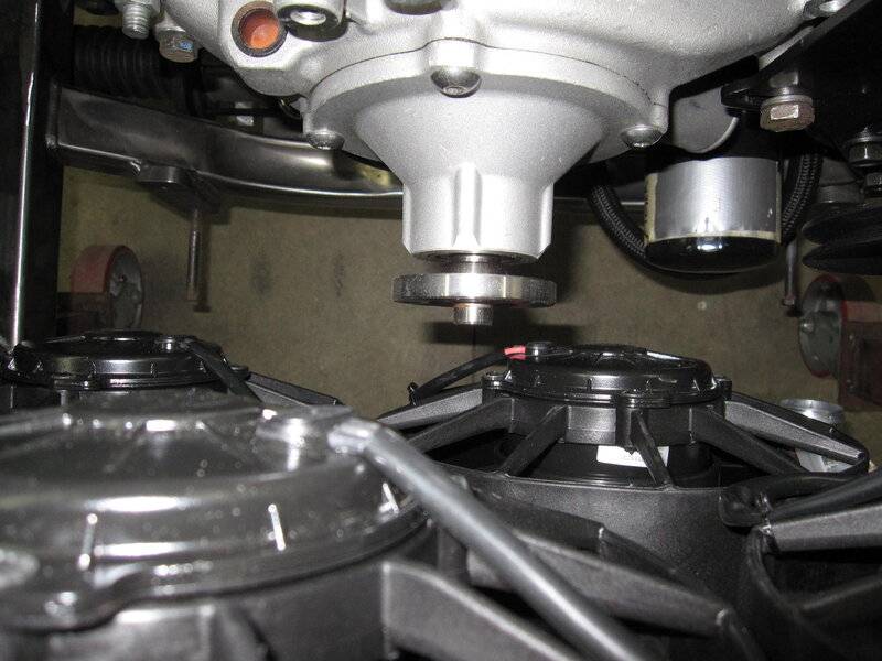

I got the 2 gaskets today to take the water pump apart to check that gap.
IF that is the problem, it's going to take a lot to get to it, but then I should be able to use the electric fan.
I won't know if the same style electric fan, but 17" vs 16" with 2,600 CFM vs 2,500 AND a bigger opening because of the shape is going to work on my Roadrunner until the middle or end of the week. IF it works fine for the Roadrunner, then I really suspect it's something else (like the gap in the water pump) on the GTO.
