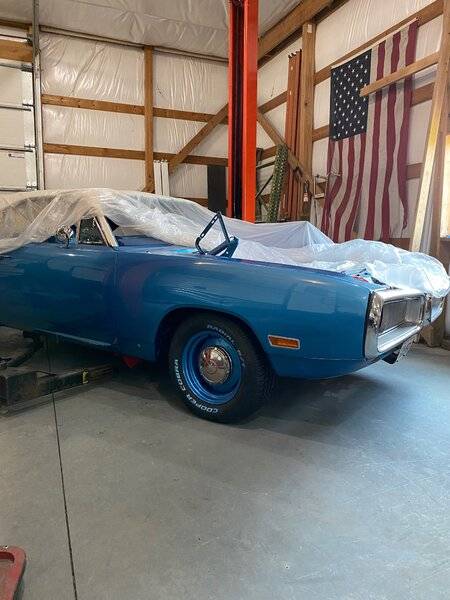

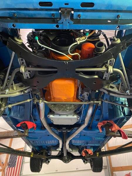

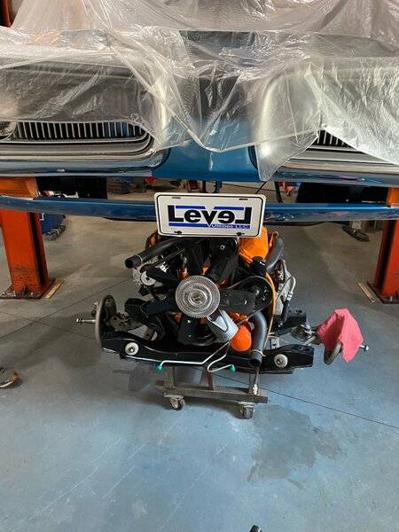

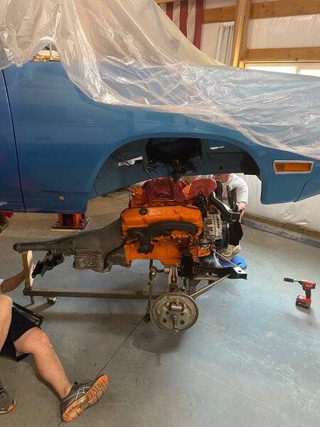

We were able to get engine and tranny installed tonight.

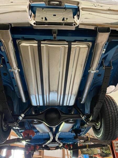

With the exception of driveshaft and exhaust, everything on the underside of the car is installed and torqued. Just waiting on driveshaft to show up before finishing those items.
She’s on her own wheels for the first time in 7 years.
The goal is to have it done and on the road by September 1st.
Driveshaft finally arrived so we were able to get that and exhaust installed today.

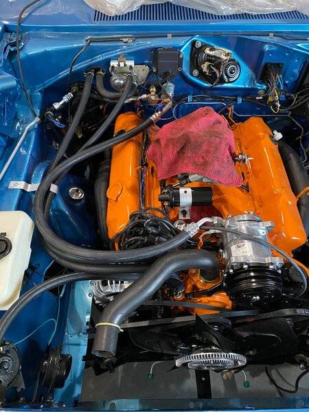

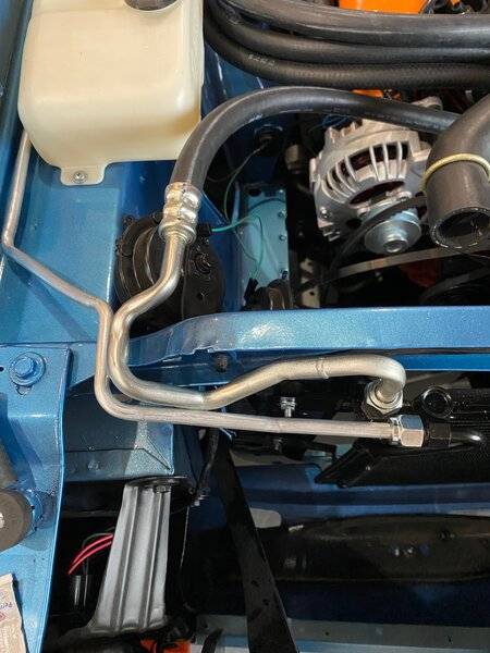

We also started installing classic auto air a/c system lines & hoses in engine bay. The instructions aren’t very good in my opinion. The hard line coming off the condenser wasn’t even close to sitting on top of radiator support like it should. We ended up cutting it and removing like 3/4” of it to get it to look like an OE line would. Still need to weld line back together, but it should be a lot nicer. I’ll post pictures of the lines and hoses once finished.
Here’s pics of ac lines cut to length, crimped and installed. We also found that the pictures that came with the instructions were wrong in regards to how the compressor is installed. Pics show it with hose fittings on top when it really needed to be on side otherwise the hoses would hit the hood when closed. Got everything sorted out and we should be good to go.

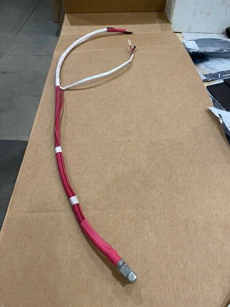

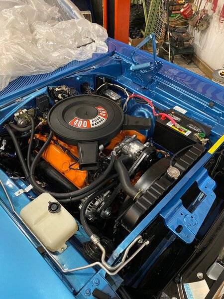

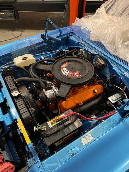

Everything in engine bay is nearly buttoned up. Finished making my own positive battery cable. Took the tips posted by other members here and bought the materials to make it. I think it turned out good and should hold up better than most of those repop ones out there.
I also got the air cleaner blasted and painted with the krinkle paint. Found a 400 sticker to put on it as well. I know the air cleaner isn’t correct for 70 Coronet, but it works.
Now we need to get steering column installed. Getting close to firing it up and making sure everything works properly before installing windshield. We’re in the home stretch, the hometown car show is just over 5 weeks away so time to go to the whip!!

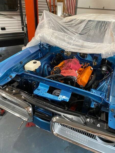

So my brother and I added fluids to tranny, power steering pump and radiator on Friday night. Put some gas in the tank and filled bowls on carb. Turned key and she fired right up. After a few seconds it started to idle smoothly. Found a small fuel leak where we forgot to tighten fitting on carb. Fixed that and started back up again and let it idle for a minute or so. I was pretty stoked about how well this initial run went.
That’s right up to when we saw a rather large puddle of fluid under the engine. Raised car up on lift to find it was antifreeze. WTF? Tracked it down to find it was coming out of drain tube through firewall just under the blower fan motor.

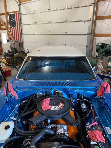

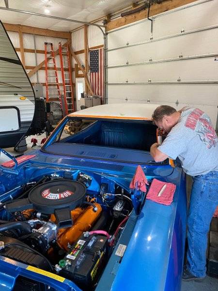

My brother came over today and helped me get the windshield installed.
One week to finish everything else before big local cruise and car show. The pressure is on now.
