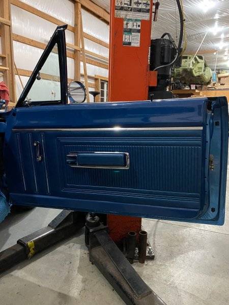

Spent some time yesterday after golfing to get some interior trim pieces installed. Got A pillar trim, rear view mirror, kick panels and door panels put in. Need to clean and paint sun visor mounting brackets before assembling to new vinyl visors.

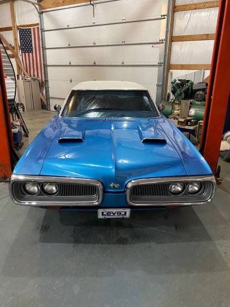

My brother helped me big time again tonight to get hood put on and adjusted. All the gaps look good thankfully.

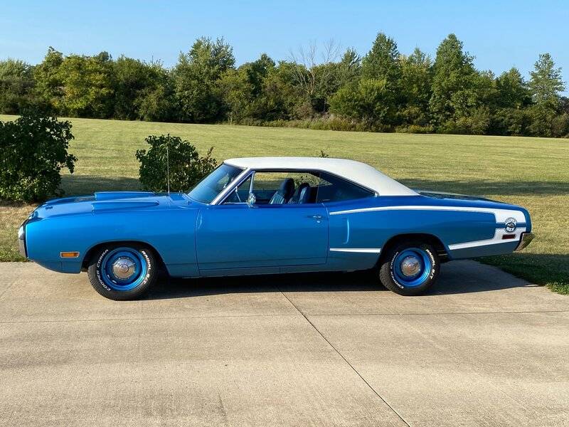

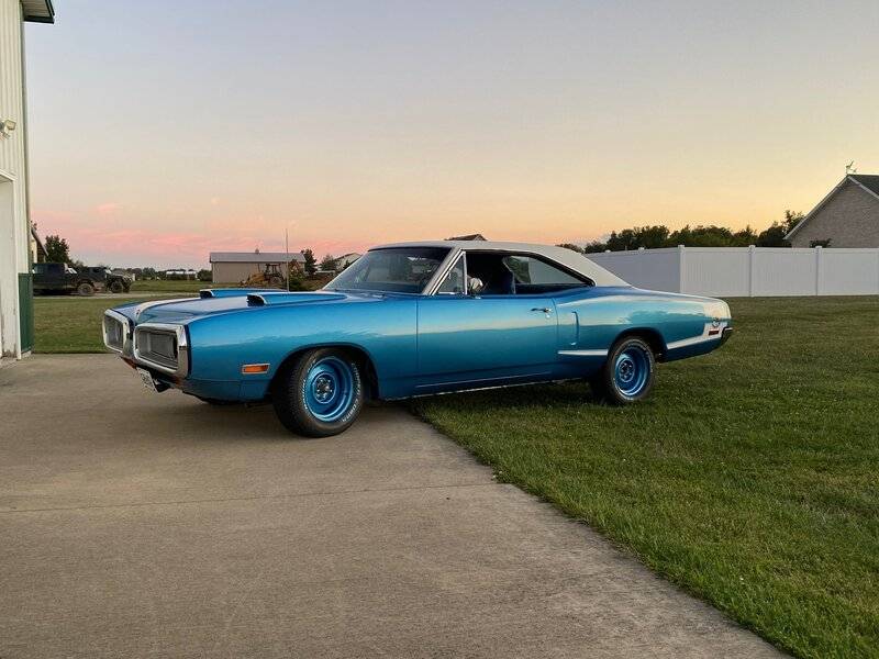

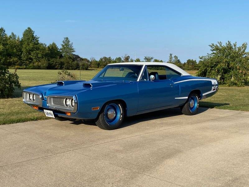

Here’s a fresh full body pic I took before I put it away for the evening.
Looks really nice in this early evening light.
Man! That's one good looking car!! :thumbsup:

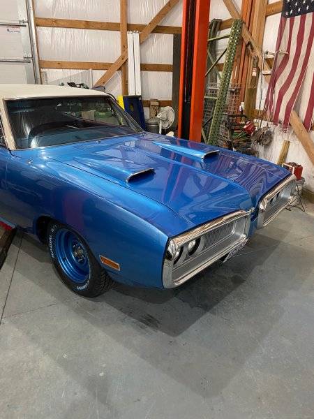

Sweet! I've always thought the 70 looked best with the double hood scoop set up, just looks right on that body.
Thanks Virg. I’m really happy with how it turned out. I did pick up a power bulge hood that needs some work as it has its share of dents, but can be repaired and used as a swap out down the road if I wanted.
Yup, the power bulge does look good...the scoops look aggressive, and they kind of remind of the air intakes for the superchargers on a P-38 (WWII aircraft). Anyhoo, one hell of a car!
