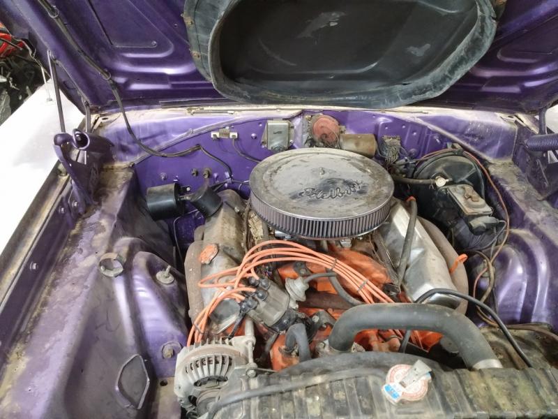

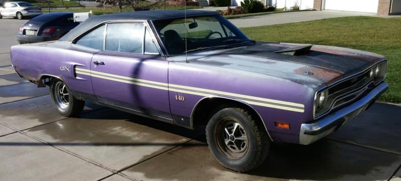

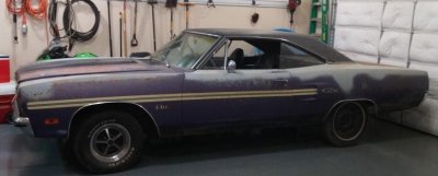

New Project Started here, fresh out of the barn and ready for a 5.7 Hemi Swap......

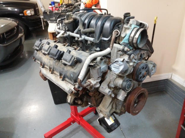

It will be a work in progress for a while, but I'm hoping by next summer it'll be going strong. For now the plan is to keep the Hemi more or less stock, Possibly cam, headers and MegaSquirt Controller. Need to source a smallblock 727. 5.7L is a '07 out of a jeep with 50,000 miles....I also have the 5-speed trans if anyone is interested in it.
Eventually I'd like to migrate to a Turbo build with a Gear vendors overdrive....we'll see if that dream comes to fruition or not.
Body work will wait for now...just want to have a nice driver. Right now it has a nice combination of 14", 15" and snow tires...which will probably get changed to 17" Black D-Window steel wheels.
I'm sure I'll have questions for all of you that have been down this road before. Though for now I'm just trying to get the 440 running decent enough to test brakes and suspension.
JR
Not sure I could do the 5.7 swap on that car. Don't get me wrong but that would be pretty cool restored. Its your car and I respect that so do whatever makes you happy. Just my 2 cents......
Welcome and good luck. Nice car! Always wanted a GTX but never found a good one I could afford. I have several chargers tho. I live in the Black hills of South Dakota but have kids in Lincoln. Wife is from Stella just south of Nebraska City.
My plan is to only do what can be undone when/if I want to revert to primarily stock form. This car has been sitting for around 25 years and I think it's time to revive it. For me I think I will be able to drive/enjoy the car more often doing this swap, though time will tell.

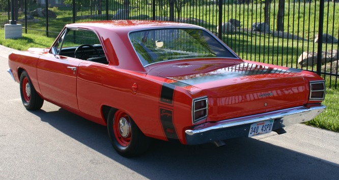

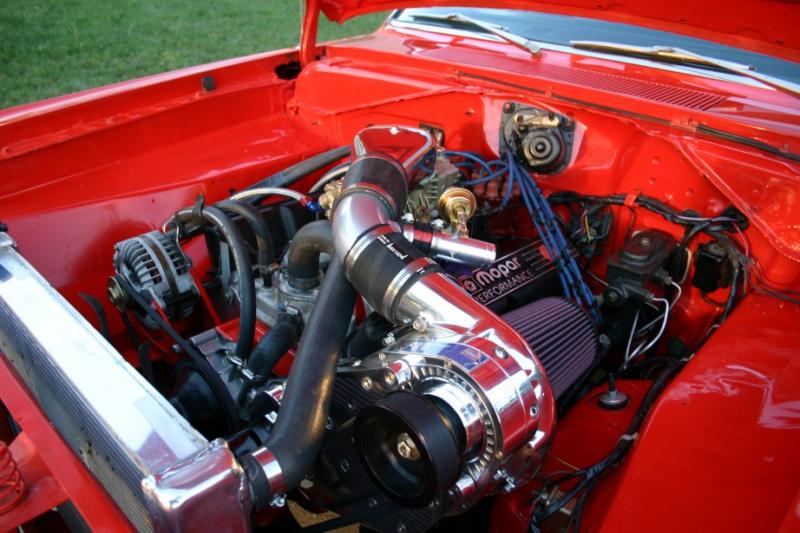

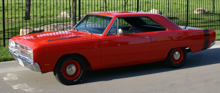

Here's the other toy... 410 smallblock, Procharged.
At The Track... https://www.youtube.com/watch?v=tf7sY6mIz9k
Sweet Dart! Always wanted one of those but am running out of time. Good luck with the GTX project. Judging by the Dart the GTX is in good hands!

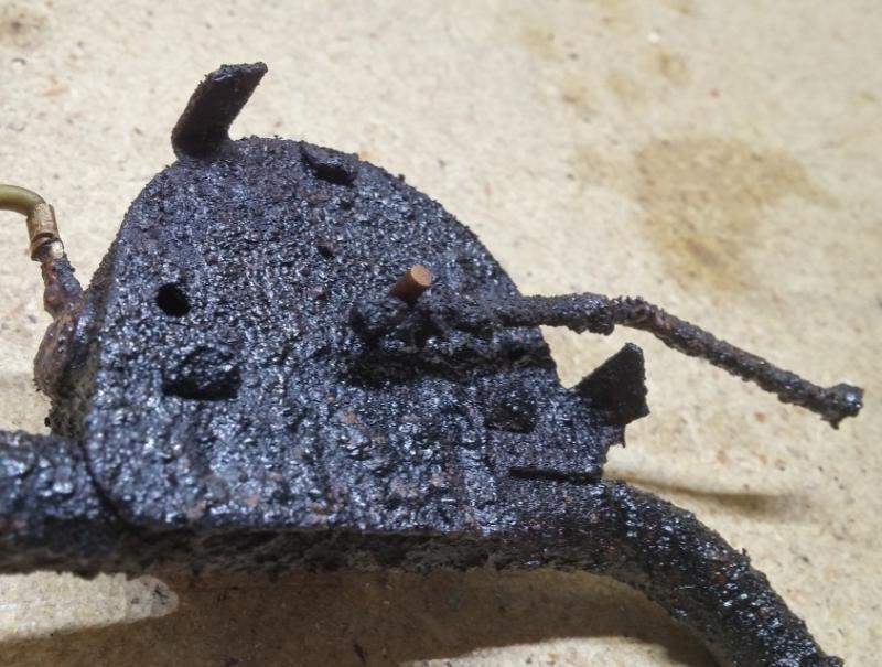

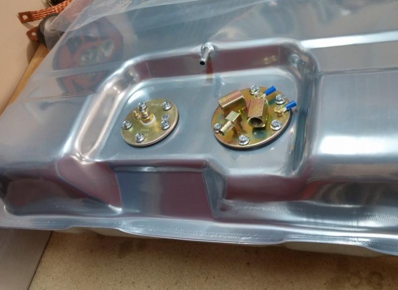

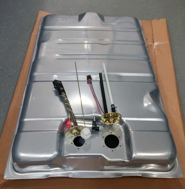

Well the time has come to dive into the project a bit, starting with the fuel system....
The internals of the stock fuel tank had seen better days

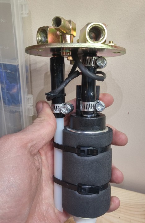

Got some parts in....
Fuel Pump and Tank float cut down to size and ready to drop in..

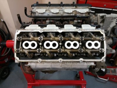

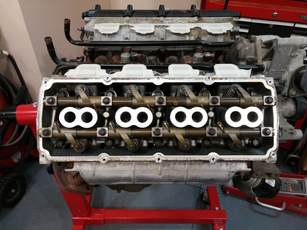

Next the Flex plate to bolt up to a 727....I see a couple of options, the Mopar part number seems to be out of stock everywhere, the ATI Style says will not fit 5.7L Jeep?? The 5.7 I'm dealing with came from a 2007 Jeep....do I need to be worried?
I'll have bunches of more questions, but thanks for now!
If you are using the stock k frame, use the stock style mounts (poly locs from shumacher). You have an lx based 5.7 from the pics, so just use the factory one (balancer) or get the ATI for the car engine.
