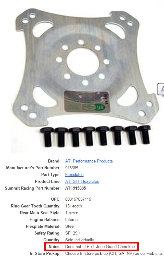

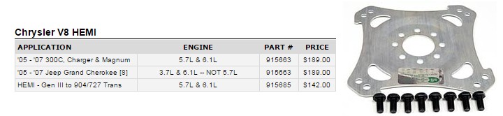

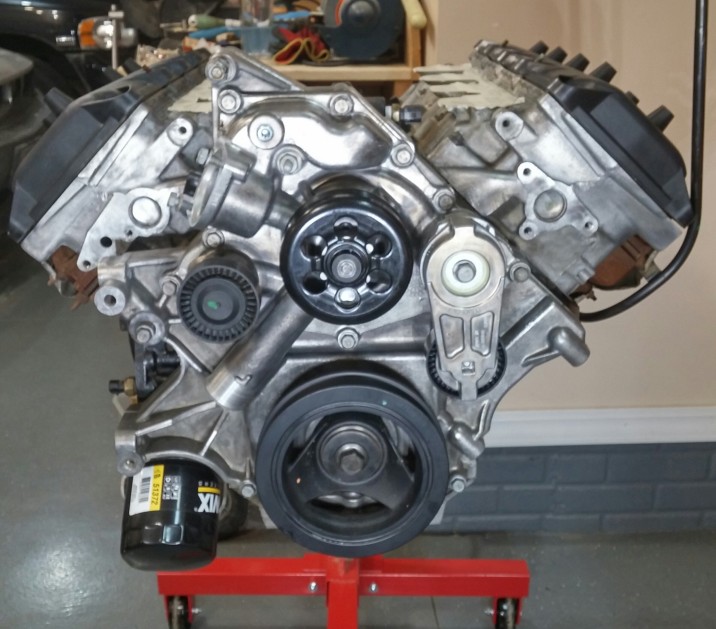

Yes it looks like the accessories mount like the car 5.7's, though this came out of a jeep. I was just curious why the flex plate says is won't work for a Jeep Cherokee?LX is car based vs. the truck based engines.

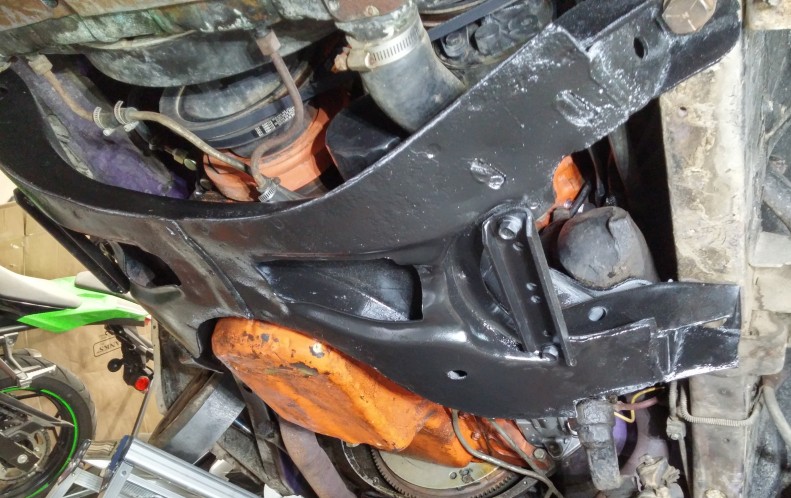

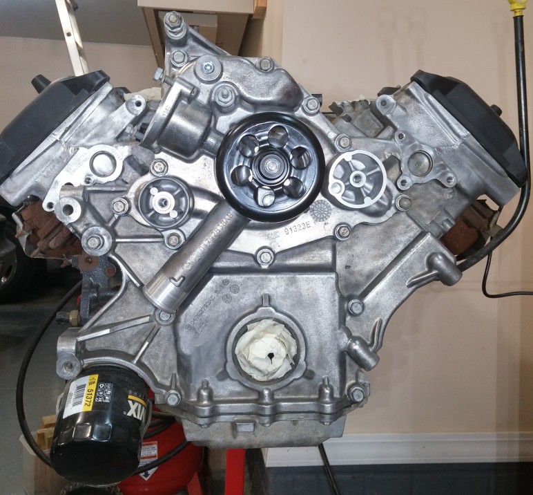

Didn't get much done during the summer but thought I would give an update of where I'm at now.

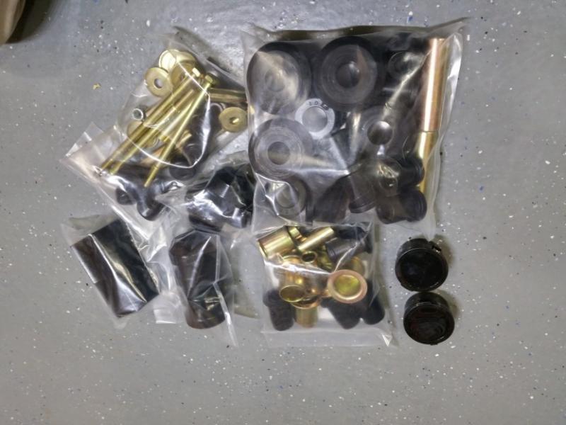

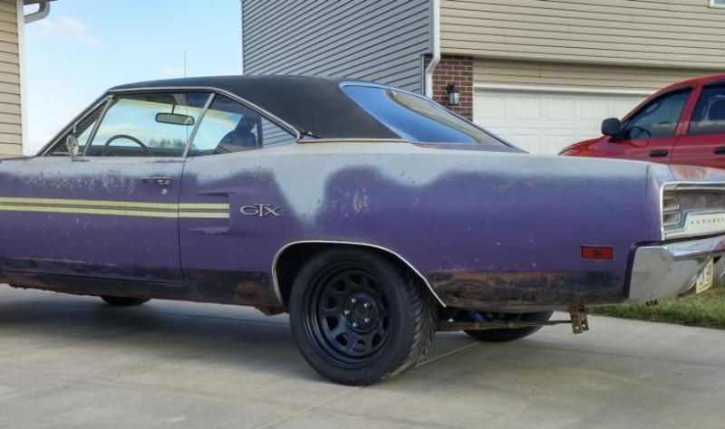

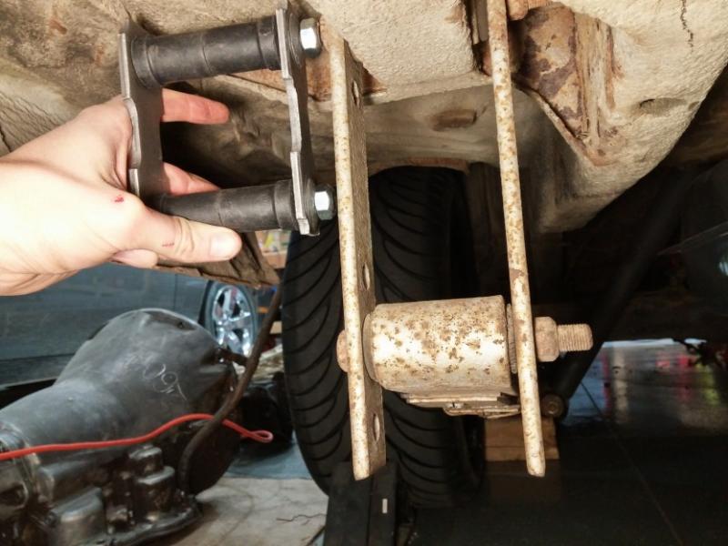

This spring I finished the front suspension, boxed in the lower control arms, all new bushings, sway bar, strut rods, ball joints, tie rods.

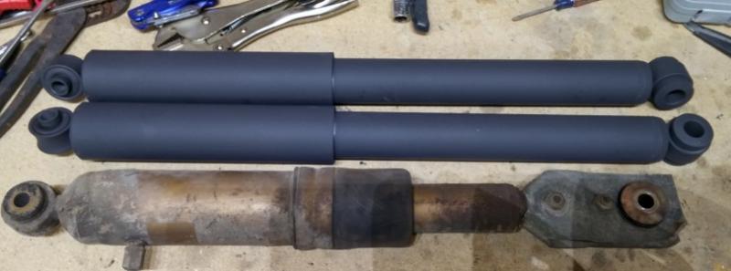

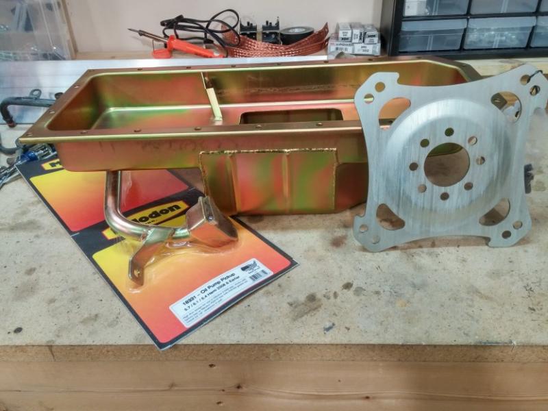

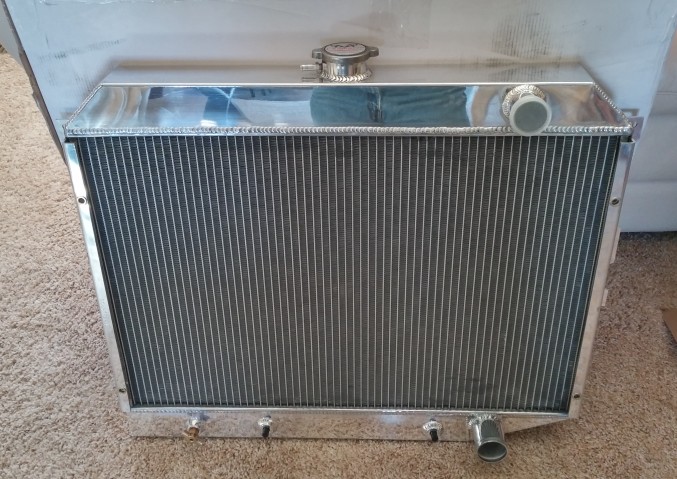

This summer I collected parts for the next phase...which I'm starting now.

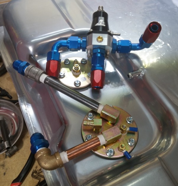

Some more Goodies...

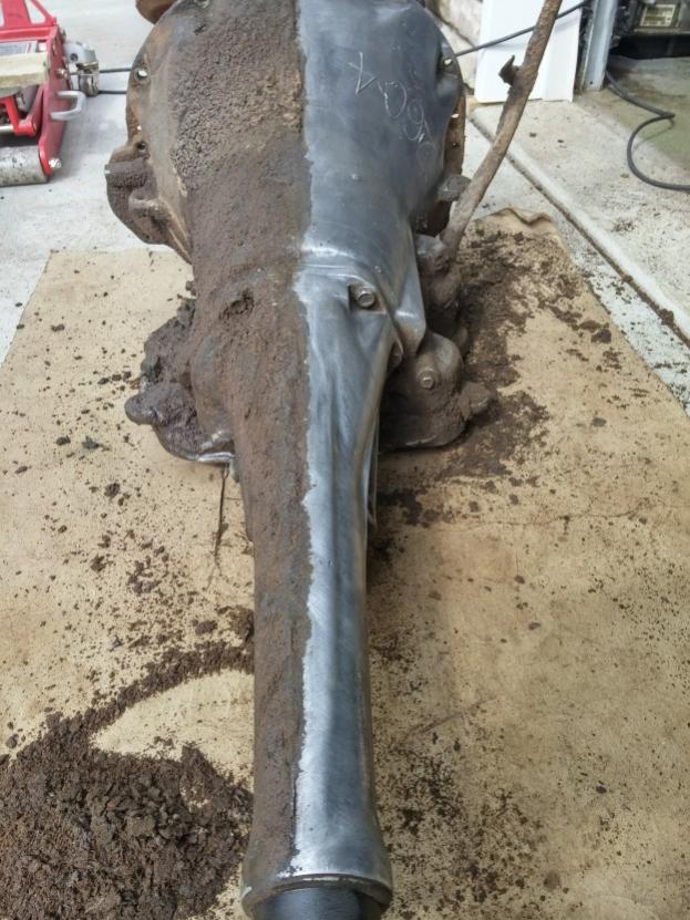

I still have a few more parts I want to get to build up the 727(Bolt in Sprag and Steel 5 pinion planetary gear.) Then I'll try my hand at rebuilding it.

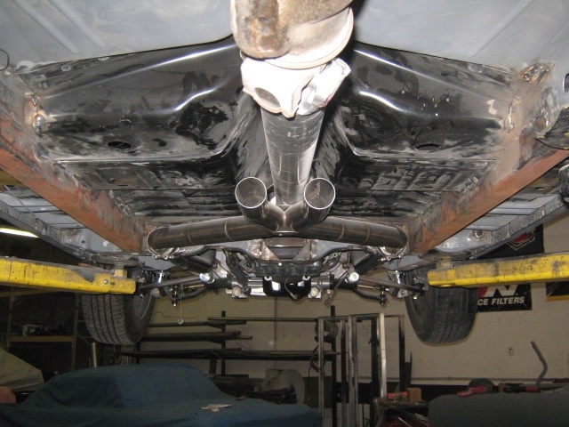

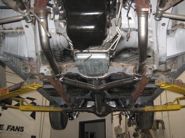

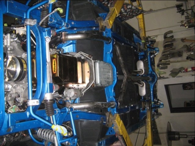

Hi I am going to be putting a 5.7 in my 69 roadrunner what exhaust manifolds did you use? I really don't want to use long tube headers.I have the NAG1 from an 07 Charger. The starter is on the passenger side. I did not bother with headers since the few tenths they may have made in a 1/4 mile don't matter to me. I came straight off the stock exhaust manifolds and straight back to the x.
07 charger manifolds?I came straight off the stock exhaust manifolds and straight back to the x.
