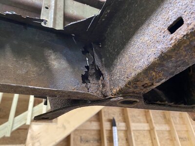

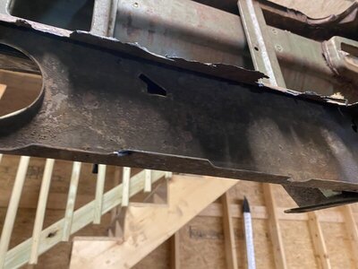

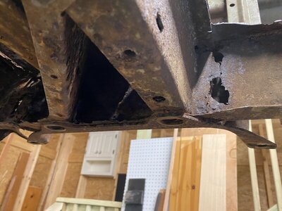

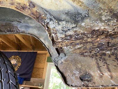

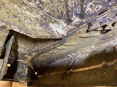

I'm about to do the same thing to my 69 Coronet and was wondering if you had any lessons from your replacing your trunk pan. I think mine trunk is in a bit worse shape; I know you all like pictures, so here are a number I took. Based on what you see, what do you suggest? Thanks! Terry
1-left bumper brace.jpg 2-right bumper brace.jpg 3-tail-1.jpg 4-tail-2.jpg 5-tail-3.jpg 6-tail-4.jpg 7-driver side-1.jpg 8-driver side-2.jpg 9-passenger side-1.jpg 10-passenger side-2.jpg
View attachment 1157049 View attachment 1157050 View attachment 1157051 View attachment 1157052 View attachment 1157053 View attachment 1157054 View attachment 1157055 View attachment 1157056 View attachment 1157057 View attachment 1157058
just a little off the back and sides please | For B Bodies Only Classic Mopar Forum
Thanks, eldubb440! I remember seeing that thread someplace. After looking at what you did -- and did so well -- I am feeling a bit lightheaded. I've got some questions that I'll post on your thread. Thanks! Terry
