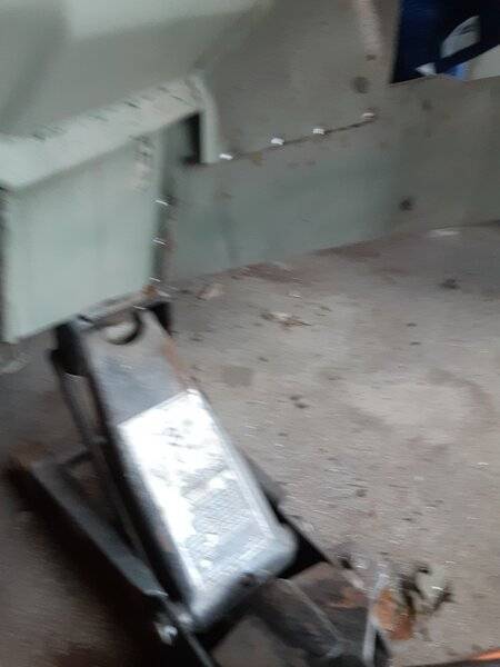

At Steve's request that I stop working on the Dodge, and get my *** back to work on the Road Runner convertible project, I went back out to the garage and got some more rust repairs done on the car. I fixed the front of the torque box on the passenger's side first.

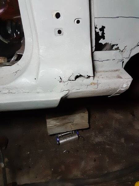

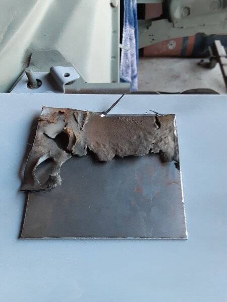

I started the repair on the passenger's side of the cowl area next,these are the before pictures.

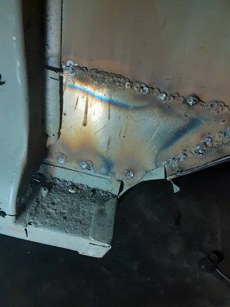

These are the after pictures, everything still needs to be ground down, but the pieces are made fitted and welded in.

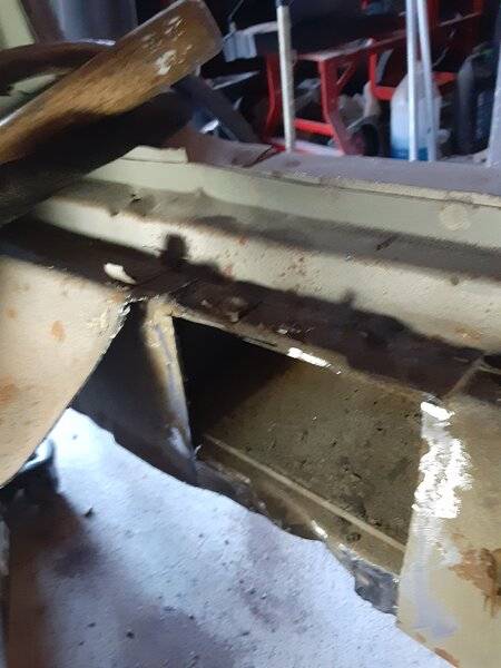

The next thing to tackle is the front bottom of the door jamb. I have the piece to fix it,I just have to cut out the d one,and drill out the spot welds on the new piece going in. It's a double panel piece and has to be welded on the inside and outside to insure that both panels get welded solidly to the car for good structural integrity.
