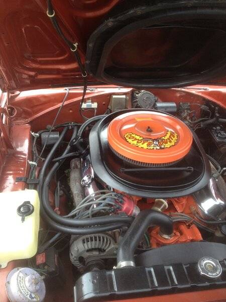

I had thought that the car was an N96 car, but I noticed that it doesn't have the hole in the firewall, so it's not.
Sorry I'm late to the party, but I just wanted to chime in on a small detail. Not all 70 Air Grabber cars had the hole cut out in the firewall for the vacuum hoses. Quite a few early ones, especially from California, did NOT have the holes (my guess is all had the holes drilled by early 1970). Instead, they passed through the firewall behind the voltage regulator. I did a fair amount of research on this and have documented several examples of early cars without the hole. Below is one such example.
Sounds like you now have the fender tag so now you undoubtedly know for sure if it was, but I figured I would chime in just as a FYI.
Cheers,
Hawk
There is a crudely drilled hole above the heater hose holes,that you can see in the firewall photo on page one of this thread. The fender tag does not show N96 on it.

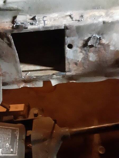

I did have to go plow and shovel about two inches of heavy wet slush last night. I am contemplating getting back to work on the car at some point today,depending on what the wife has planned. I noticed that the seat support brackets have some rust issues that will need to be tended to,and the seat belt mount nut is torn out of the inner rocker panel on the passengers side. I will have to cut the inner rocker panel and weld in a new piece with a hole drilled in it,and the seat belt nut welded into it. I will used some 1/8 inch plate that I have to meke this stronger than it ever was from the factory. If I can get the rest of the floor pan removed and prepped for the new AMD full floor pan,that would be a good day.

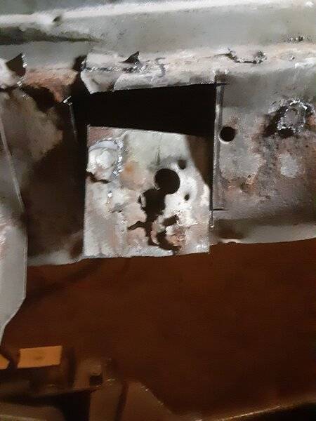

Well I worked my typical 12 hour day today, but I still wanted to try to make some forward progress on the car, even if it is 26 degrees in my garage! So I cut the area out of the passenger's side inner rocker panel, where the welded seat belt nut was rotted and torn halfway out of the rocker panel. Then I got a piece of 1/8 plate steel and cut out a new piece. Tomorrow I will drill the hole into the steel plate and weld the original nut to the backside of the plate in the correct location so it corresponds with the hole in the new floor pan. It's a small job but atleast I feel like I am accomplishing something on the car.
Still related to the rusty northeast mopar family:thumbsup:
I got the piece of 1/8 inch drilled out in the proper location, and welded the factory square nut that receives the seat belt mounting bolt. I had to remove the nut from the rotted and torn rocker sheetmetal, and grind the slag off of it,before I welded it to the new piece of metal. I etch primed the back side of the new piece, and will do the same thing with the face of the piece after I weld it in and dress out the welds. Once it is installed, it should have way more strength than just a nut tack welded to a piece of sheetmetal.
