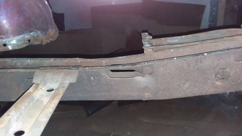

"Spot weld drilling hell" continues, slow progress. Quarters and extensions showed up so I need to keep at it.

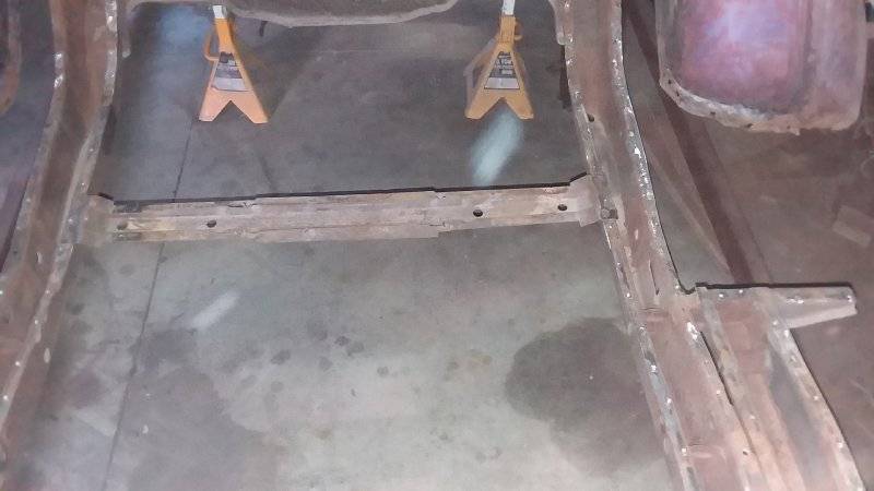

Trunk floor is out! Just need to clean up the rails and I can start fitting the new one.

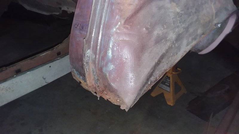

Comparing the AMD panel to some originals I found four obvious differences with the strengthening ribs. A little time with a propane torch, hammer and dolly and a body file fixed it.

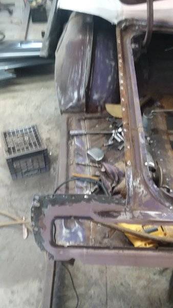

Drilled all the holes in the trunk pan and even remembered to sand and scuff it BEFORE I weld it in which is much easier.

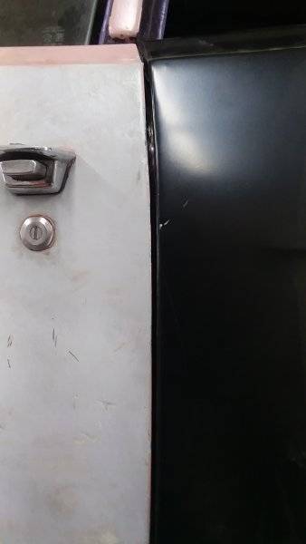

Some more progress, trunk floor is 90% welded and ground so started fitting extensions and quarters. They will need some tweaking in a few areas but not too bad overall.
