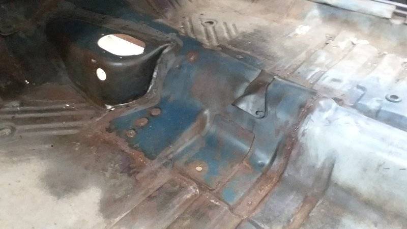

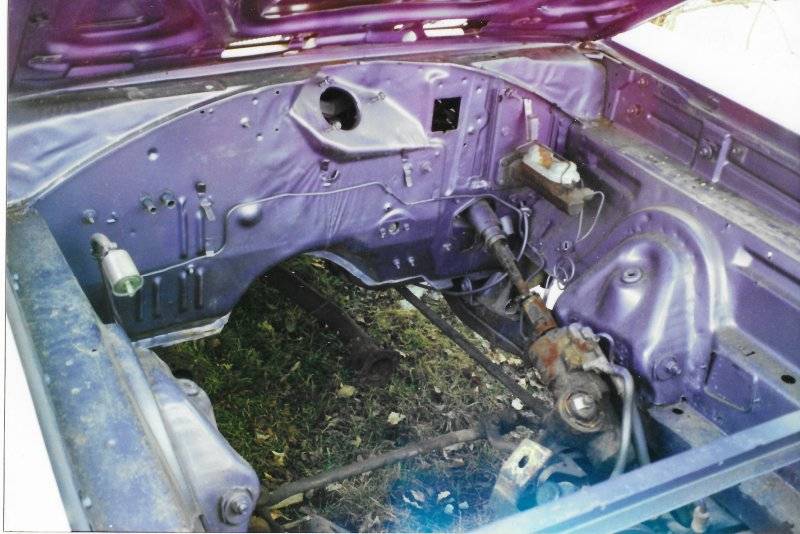

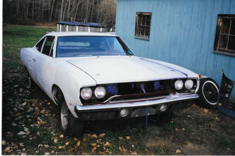

I bought this one back in 2000 out of NJ for $5000, matching numbers 383, FC7, black bench, column auto. I tore it down but it`s been pretty much just sitting awaiting restoration due to other projects that kept pushing this one back. I finally decide I need to get it done so I sold my `76 truck project to free up the time, money and space I need. Overall car is very solid just needs quarters, trunk pan and small patch on drivers floor pan - should be an easy job compared to the total rust buckets I usually work on.
How it is currently - ignore the pepto bismol pink, I wanted to get some paint on it so it didn`t rust thru the laquer gray primer so I threw some leftover red and white paint together and sprayed it on.

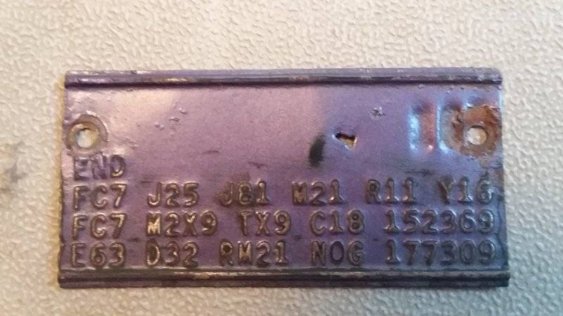

Fender tag is obviuosly a real original one not a fake - don`t care what anyone else thinks. Most of my interior was missing when I bought it so I don`t have a broadcast sheet. It would be nice to have but it`s not going 100% correct concours so not really that big of deal.
*Removed for breaking rules
I wanted a real factory FC7 rr and luckily found this one, I just wish it had white interior instead of black as that really makes the In-Violet pop. Car had quarter skins put on some time before I got it but they were not done very well so I am going to put full quarters on it, hopefully they are available as they were on back order.

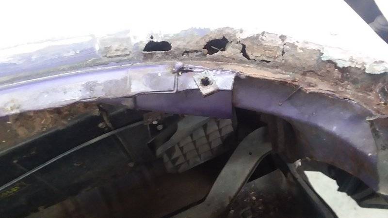

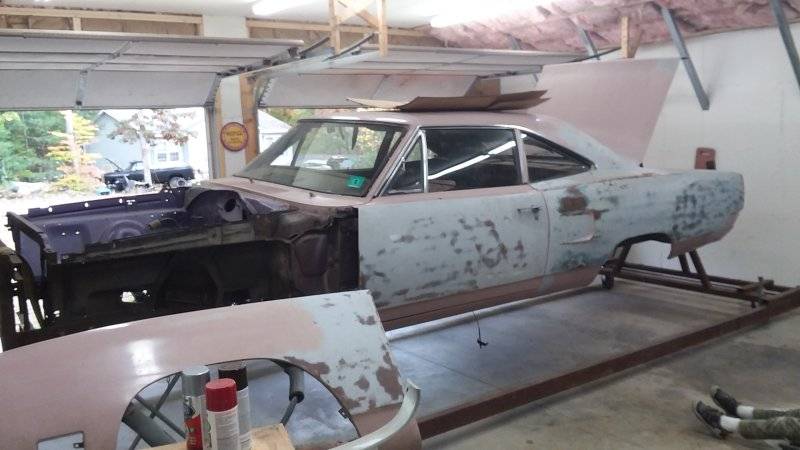

The car had quarter skins done previously but they were hacked, welded right on top of leftover original quarter along the wheel wells. Other than a couple small spots outer wheel wells are solid.

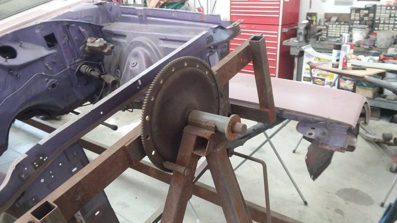

Truck is gone and road runner is in the shop. It's on a homemade rotisserie but it's better than doing it on jack stands like I did my Barracuda.
Nice job on the rotisserie. I do my own fab work and that is awesome. I have a hoist so I do mine overhead. Would love a rotisserie but didn't have a place to store it when its done. yours looks amazing for home made.
I can`t take credit for building the rotisserie as I actually got for free off Craigs List although I did have to lengthen it and add the supports to bolt it to the body.

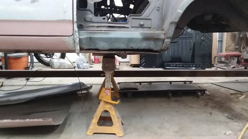

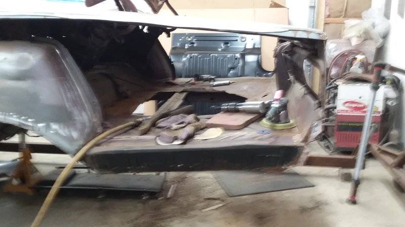

Parts starting to arrive, trunk floor came from Texas, quarters and extensions are on their way but front floor pan is back ordered and not due in till mid December. That's fine as I can get the rear clip going now and floor should be here by the time I need it or maybe before as I'm old and decrepit and don't work as fast as I used to.
Got the rear off the rotisserie and on jack stands before cutting the rest of the quarters and trunk off, lots of spot welds to drill out. New quarters and extensions scheduled for delivery on Monday.
