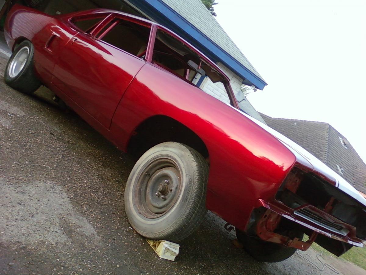

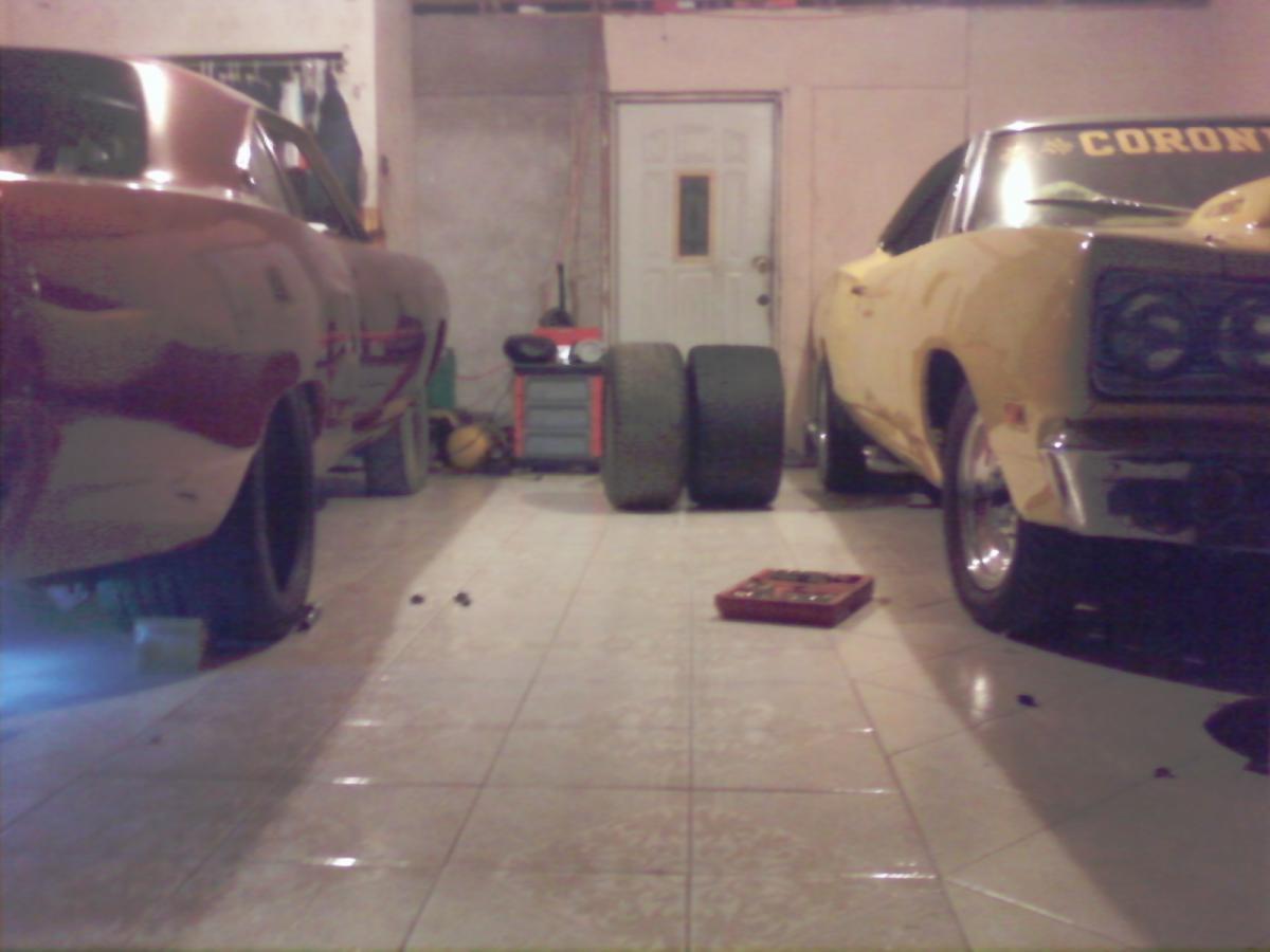

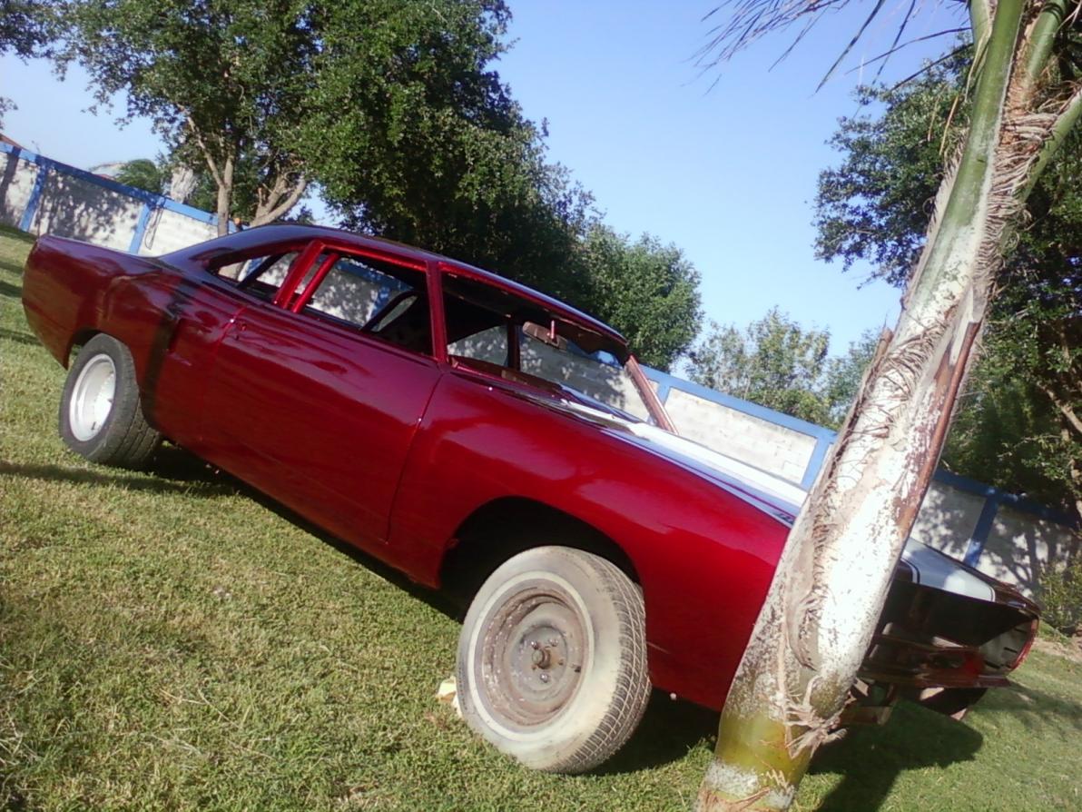

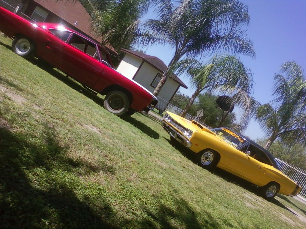

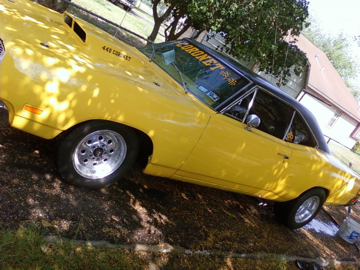

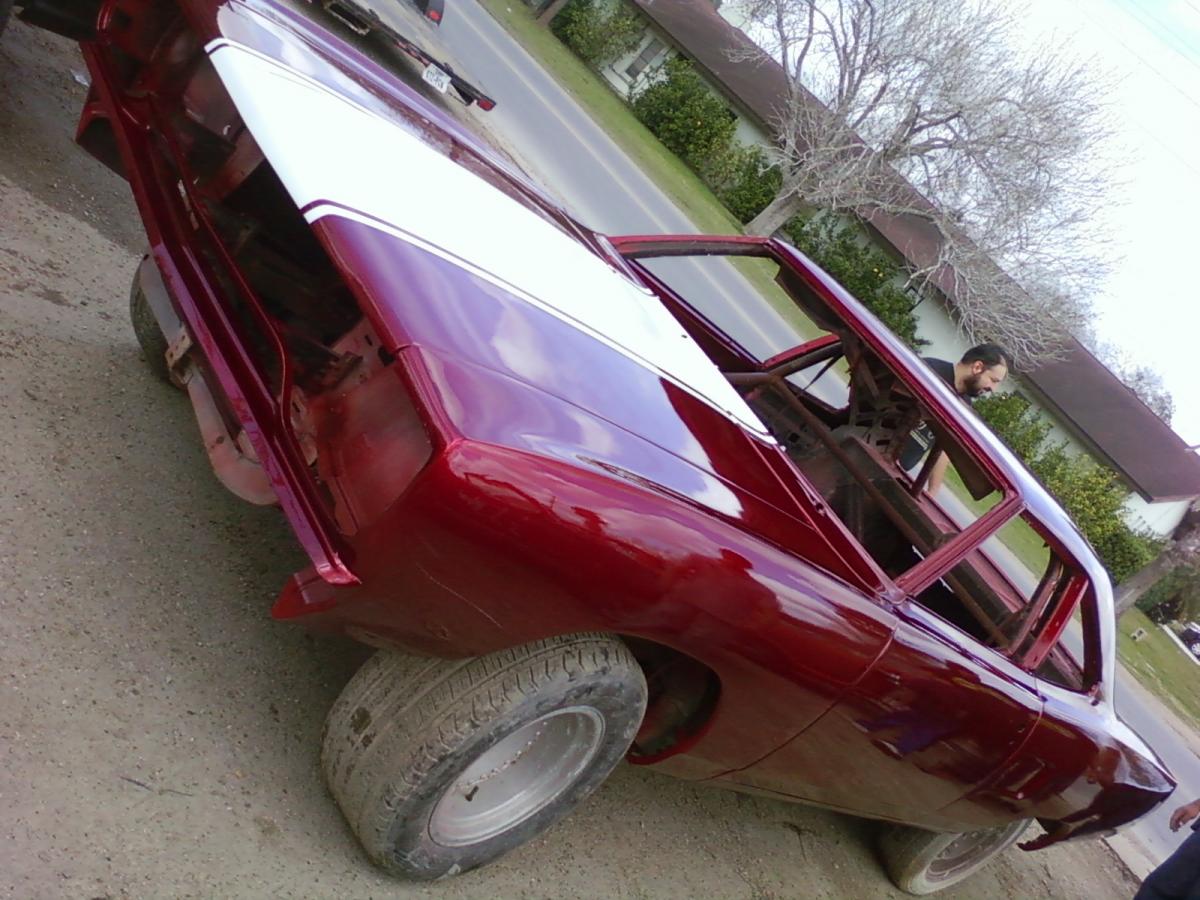

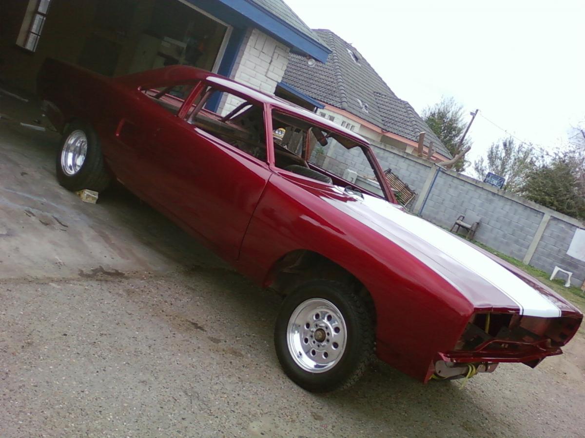

This is my 70 road runner it gotten new qtr panels,trunk floors,floor pans,trunk,fenders,roll cage,shaved firewall and finally got painted looking to try and go for a protouring look on this one, we also have a 69 coronet 440 viper yellow w/black. The car is now painted and waiting to get buffed so it can really shine the candy looks so nice in the sun and in the night it looks like the paint is still wet, right now trying to save to buy the billet rims and start building the 440.
that red looks good,can't wait to see it when you get the chrome on her.That yellow also looks good on the coronet.
Nice, both cars. Thanks, I got a 6 pack hood, and was thinking about painting it the same color as the car instead of the usual black.
Blue is my fav., but damn that color looks tits!!!
Keep da pics comin'...we love car ****!!! :icon_pidu:
Btw love the coronet too!!!
the paint on the rr is house of kolors candy red over gold base instead of the usual silver
Those candies are pretty easy to screw up without the right amount of experience to back it up...Gotta say you did a great job..Looks really good! Dig the Coronet as well!!

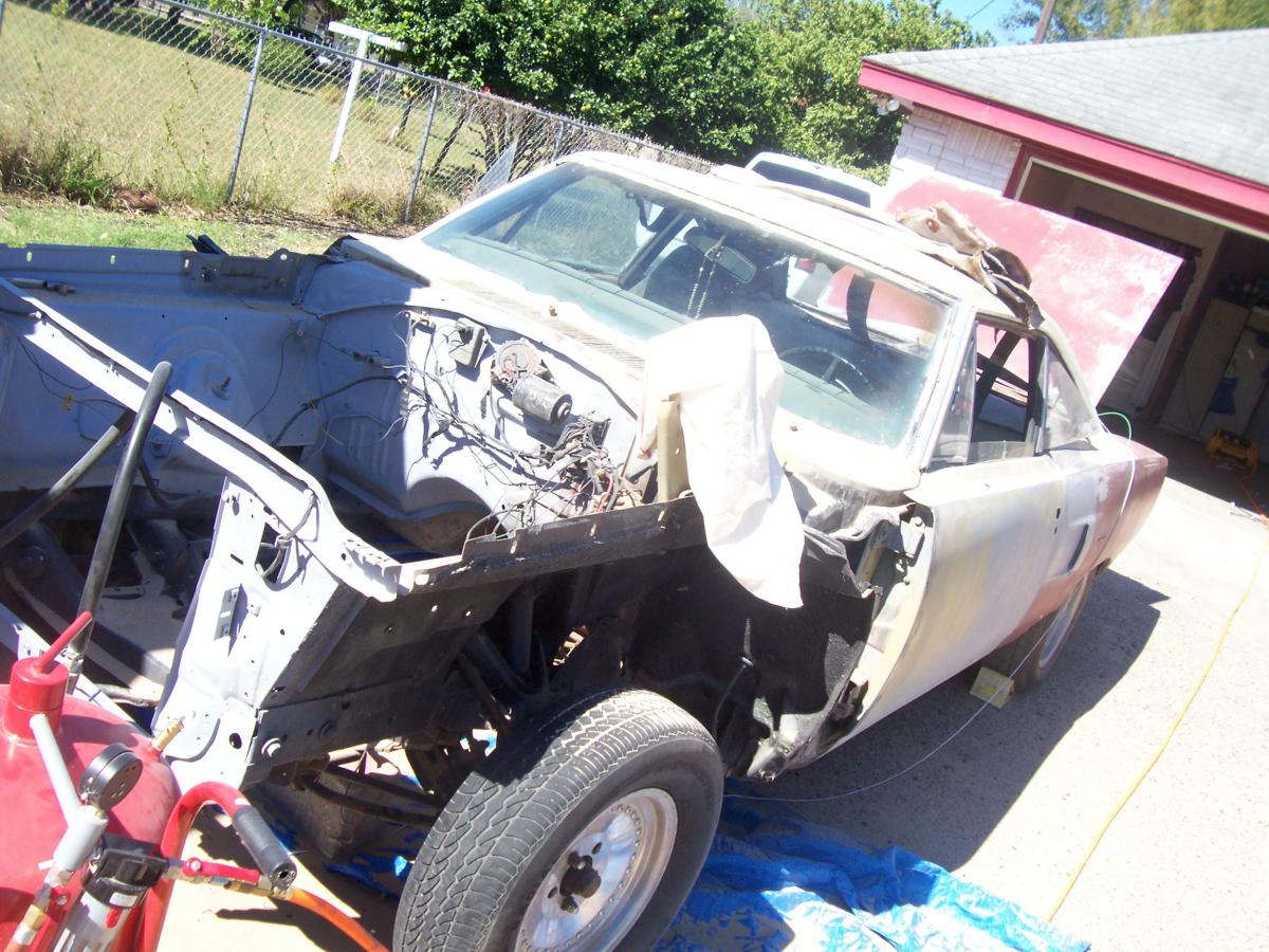

thanks everyone for the comments here some pics of them took them of the garage to wash them//heres some pics of the bird when i was berarly starting to sand blast it maybe 2yrs ago looking for my other sd card from the camera so I can post up pics of what it went thru.

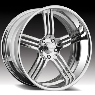

heres the wheels i'm looking at for my rr they're goin to be 18x12 or 19x12 rear w/like an 8in lip tires will either be 335/30/18 or 345/30/19 and 18x9 fronts w/3 1/2 lip just flush w/fender tires will be 275/35/18 or 275/40/18 really liking the first ones or the second ones hopefully will be buying them pretty soon let me know which ones you'll think would look better let me know

Nice paint job! Love your 69 bee as well,if I had 2 pick 4 the rims I would go with the top row #2 kinda reminds me of a nicer srt 8 rim. Just my 2 cents.
The car looks great ! Red, roll-bar, Road Runner. I won't comment on the wheels, being old-school, I don't particularly care for modern style wheels, my opinion on them is worthless. Me, I'm happy with chrome-reverse.
Nice paint job and I'm partial to the 69 cause I have two of them. The rims with red in them would look absolutely smoking hot and yes I think the big rims look awesome on the big B-bodies and I love customs over stock any day of the week. More pics please.

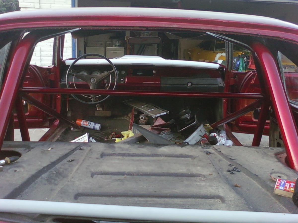

heres some pics of the dash and the cage sanded the all the dash smooth an d layed down some candy paint white gauge also and my dad will be making all the black plastics around the gauges,radio plate, and on top of glove box out of stainless steel he can make anything with metal we bought some and sanded it and buffed it and you'll be amazed the way stainless can polish up dads be a metal man for 20+yrs got most of the parts painted except the glove box had a little crack and had to fiberglass it thats why took a little longer

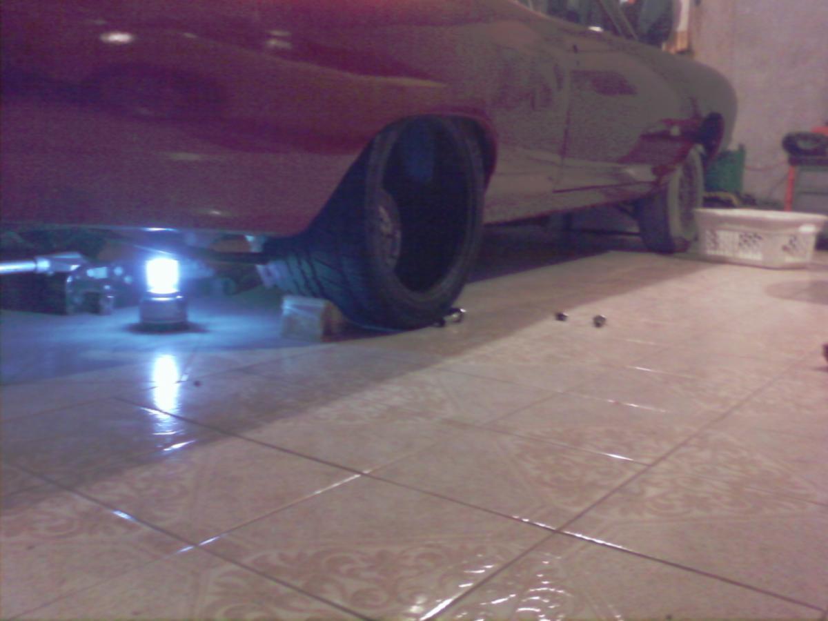

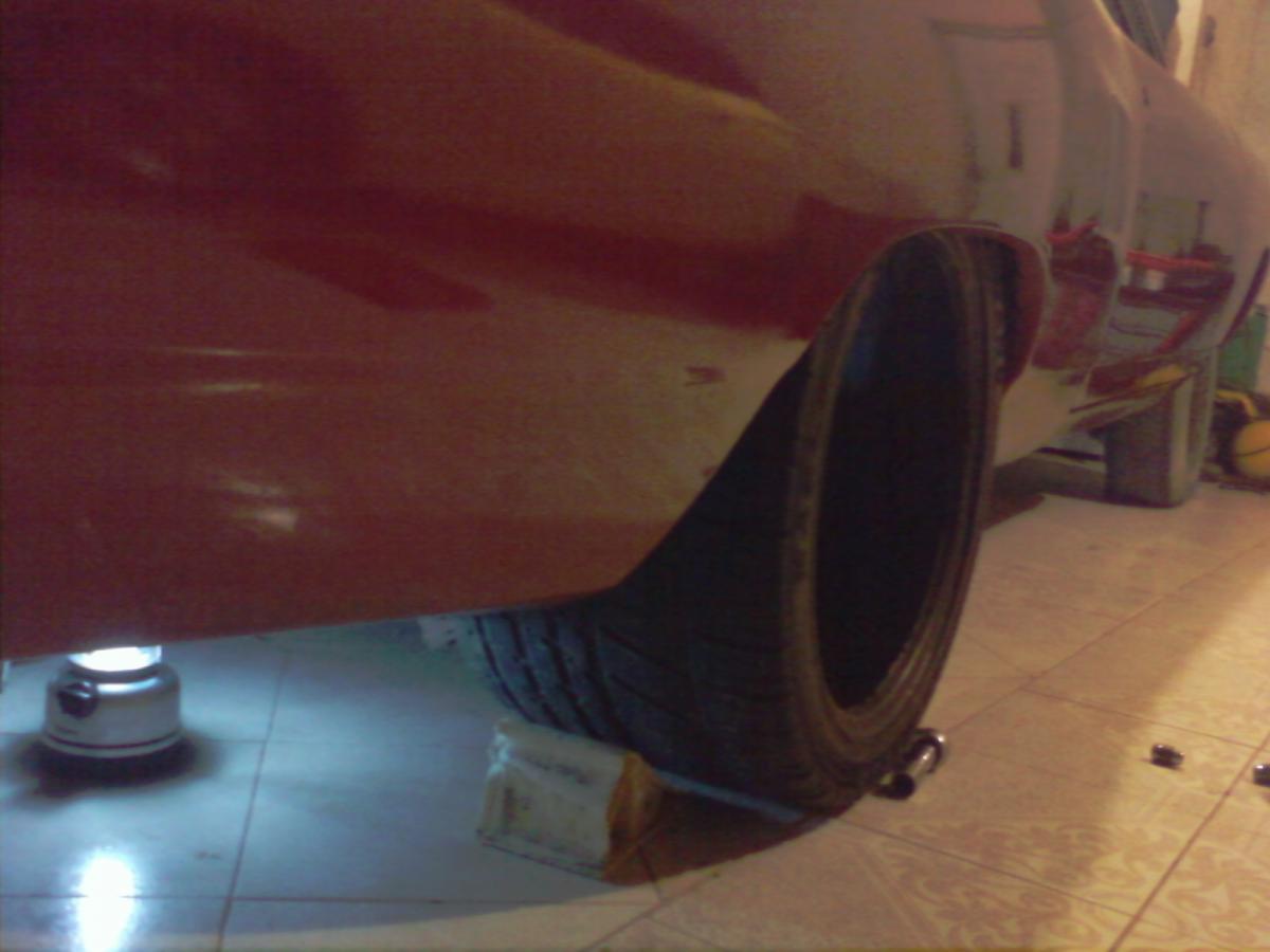

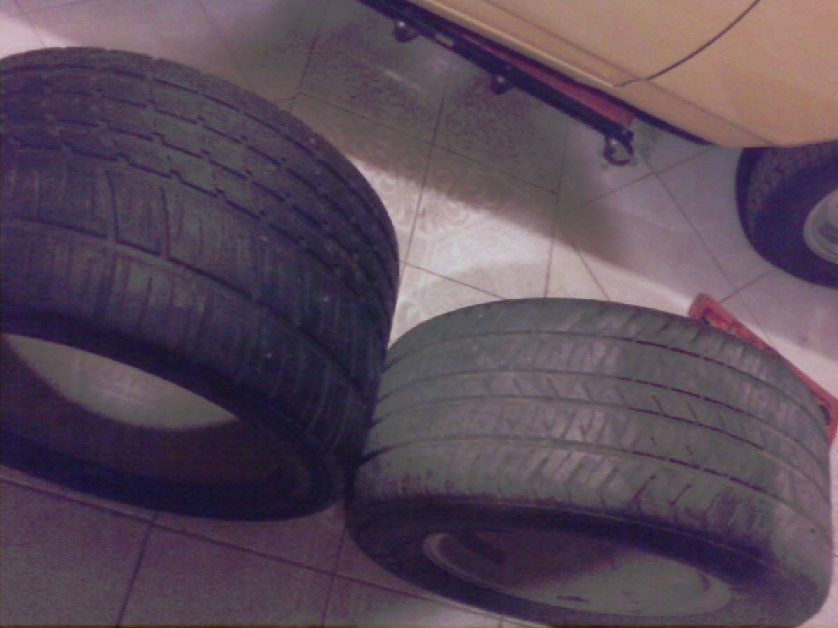

Heres a couple of shots with the 335/30/18 tires on the car still has lots of clearance with the mini tubs just need to relocate the springs in here are some pics i'll post better ones tommorrow, and also my little boys tool box next to his road runner according to him(I dont think so) lol lol
These 335s are huge makes the 295/50/15 looks skinny
Hopefully will order the rims here in a couple months and really set off the look check out the reflection in the candy paint and it still needs to be buffed I love this color more everytime I look at it!!
