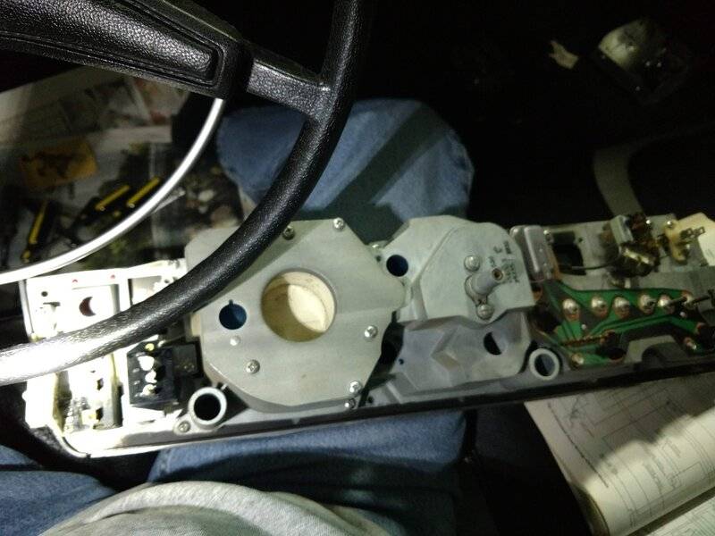

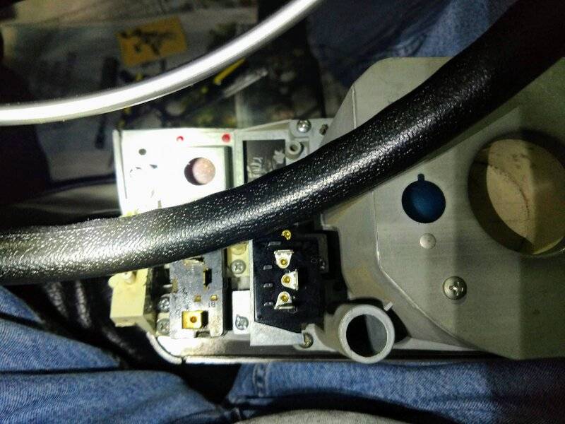

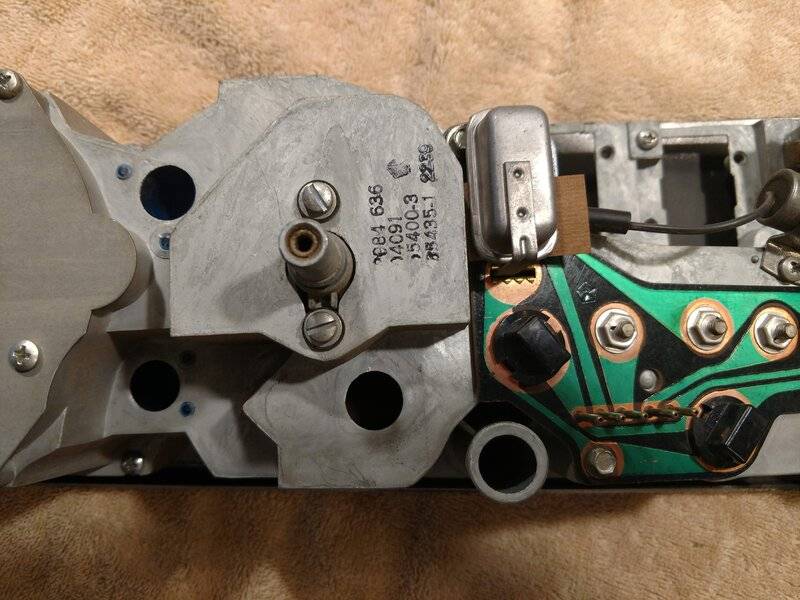

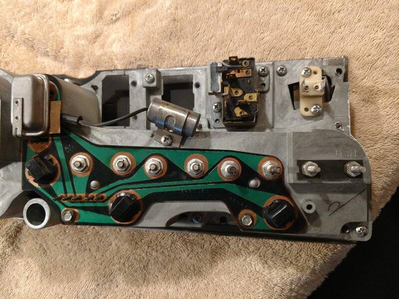

As the previous poster expressed, you can remove the screws showing on the face of the instrument trim and tilt the entire assembly forward to access OR remove the cluster. The radio faceplate may have to be removed AND the nuts backed-off on the steering column mount/support under the dash. (This is on a rallye dash, by the way). It's a tight fit to remove the assembly, but (kind of) easily done. This is probably the easiest to change all the bulbs, although merely tilting the assembly forward may give you enough room. (I can't remember, but you'll figure it out when you tilt it forward.) Reinstalling the bulbs/sockets into the appropriate receptacle in the cluster is a treat, since there's no a lot of extra wire length to help you, or if you have fat fingers! I'll try to upload pictures of the cluster removed in my lap in the car, and out of the car, so you know what you're dealing with ahead of time.

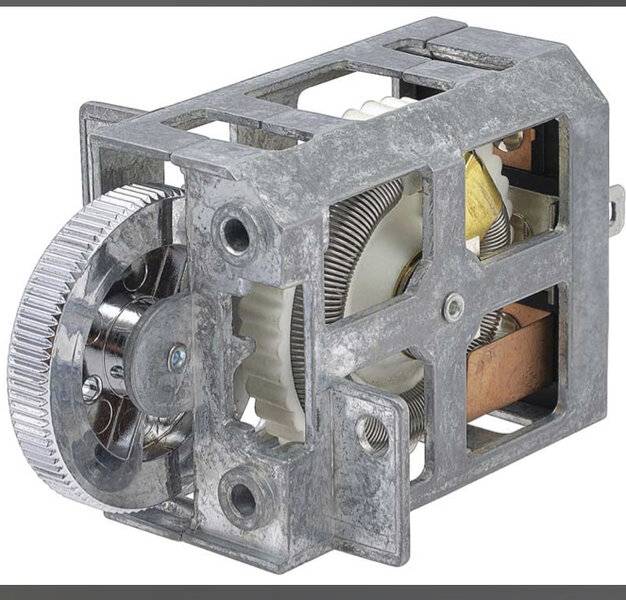

Do any of the lights currently work? It’s common for the rheostat to get gummy or quit working completely on the dimmer switch.

The thumbwheel switch on the dash. To adjust the brightness of the dash lights. Roll that switch around a few times and see if anything happens.
