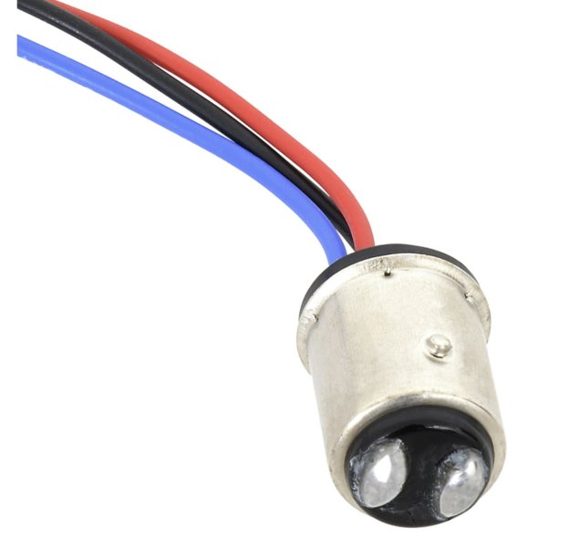

The 69 and 70 Chargers use a 3 bulb arrangement in each side. The left has an 1157 in the 1st and second socket and if I remember this right, a 1059 for the 3rd one. The right side starts with a 1059 then the 2nd and 3rd are 1157s.
The 1059s are single filament. They do not brighten along with the turn signals and brake lights.

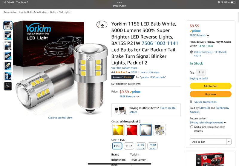

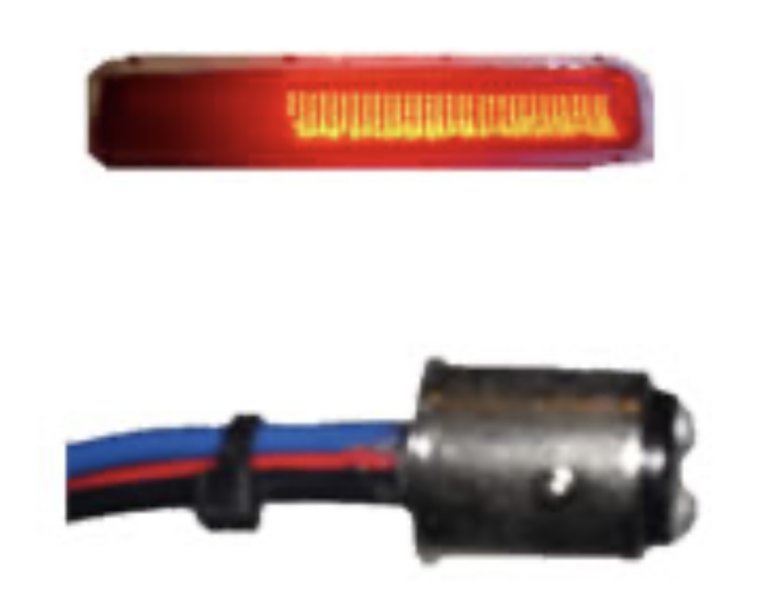

To make these "Yorkim" bulbs work, I'd need a single filament for the inner sockets on both sides.

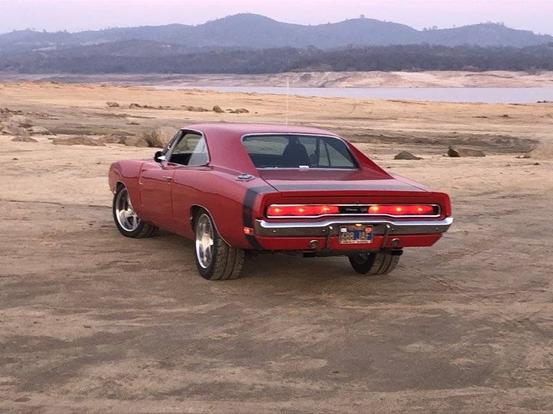

Like a tint/smoke. It’s a big thing on new cars.I wonder if a previous owner tipped some sort of dye into the light housings....making the lights appear darker - like a stealth mode????
Worth taking a look.

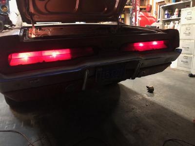

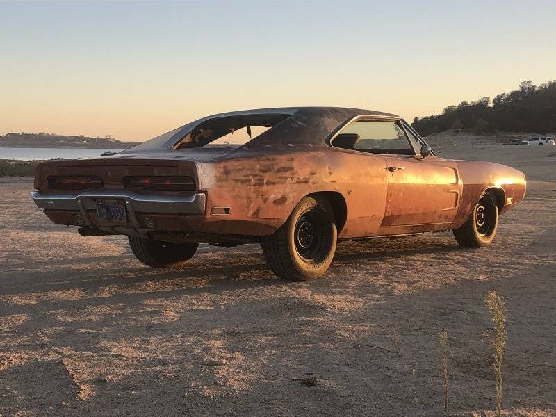

You only did the left side, right ?Daniel Stern popped in a thread at FABO about how to make your lights shine brighter. He wrote about painting the inside of the housings with flat White House paint. I decided to test out his idea on my ratty car.

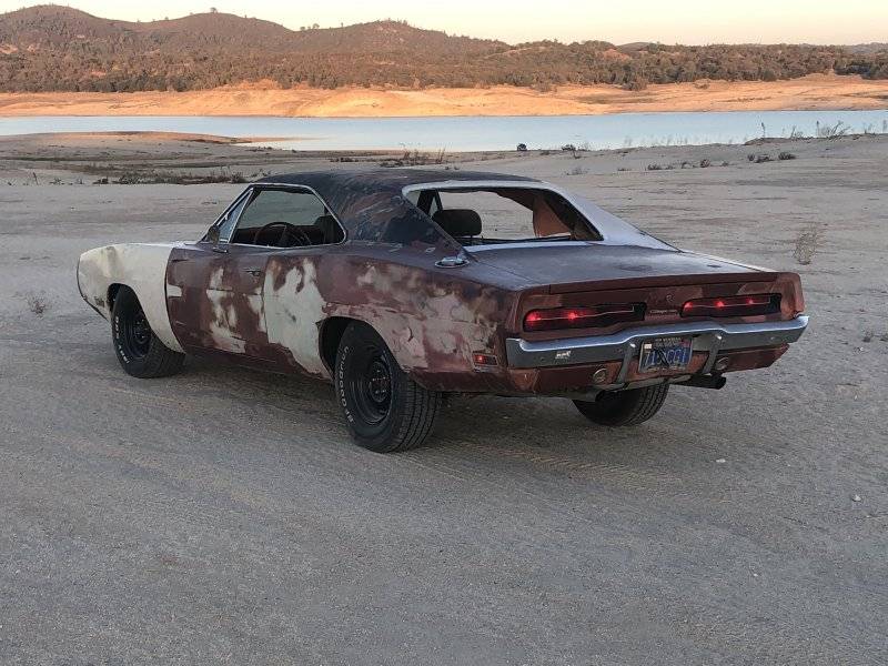

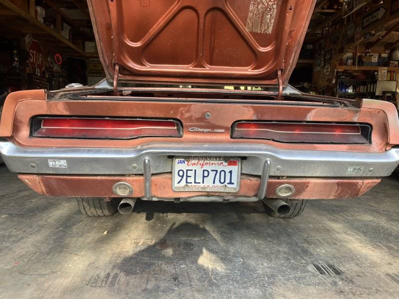

Here is how Jigsaw looked with seasoned and untouched (by me) taillights.
Note how the left side has a sort of even glow while the right is brighter right by the bulbs.

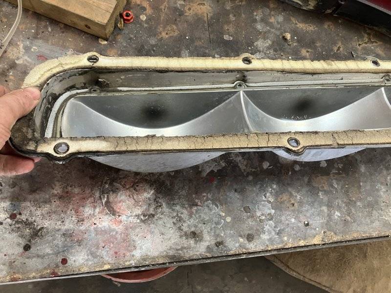

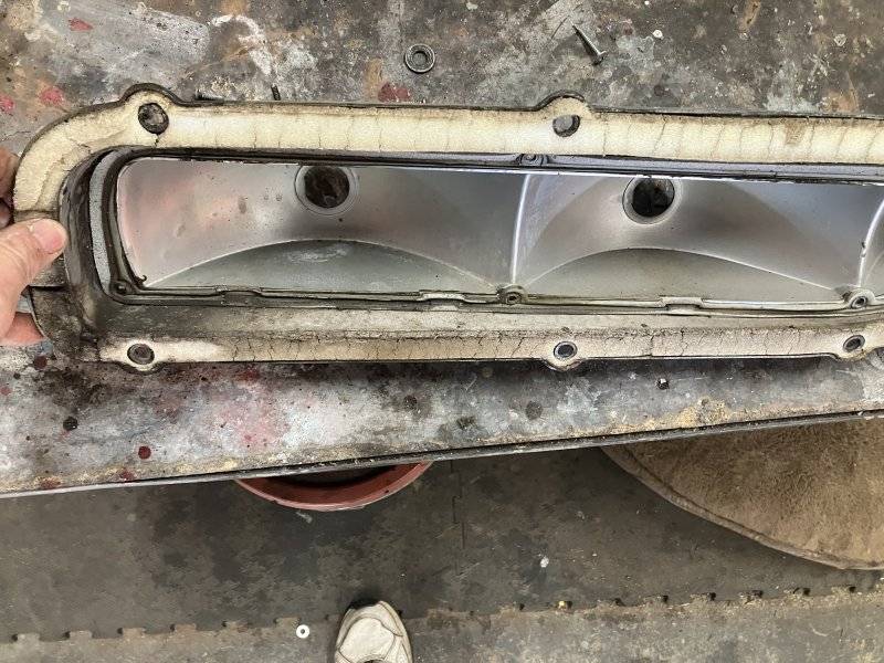

I pulled the left housing to find…
It looks better than I expected.
You can see black spots where the bulbs did heat up and discolor the top section of the housing.
The bottoms looked fine.
I sprayed inside the housing with this:
It is what I had at hand. It is satin

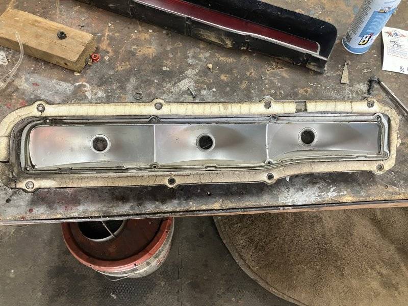

Now a before and after.

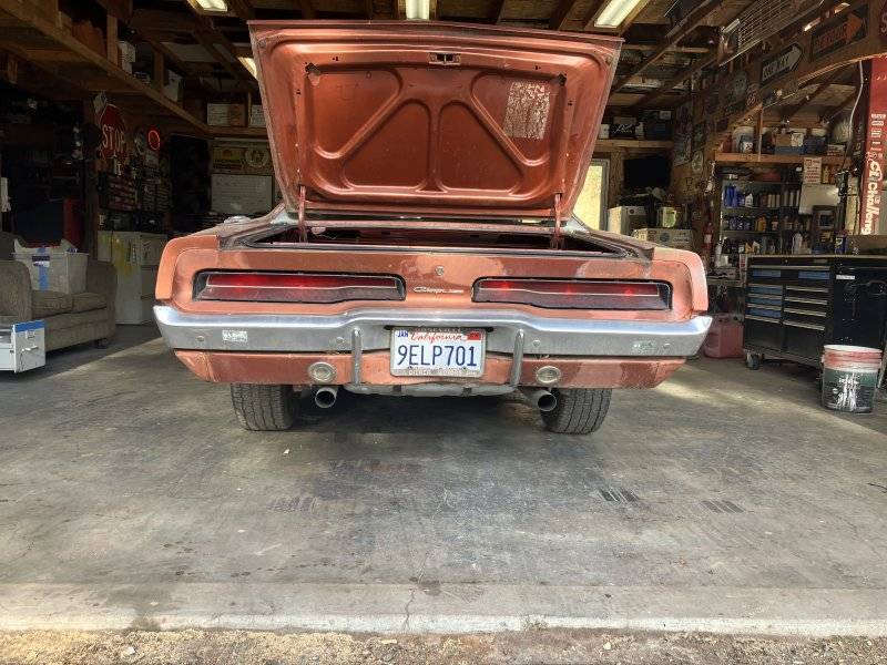

I’m not sure if I can tell much of a difference. Can you ?
Show us when it get's dark.Yeah. I was trying to show a side by side comparison. I didn’t realize at first that the left side already looked better.
