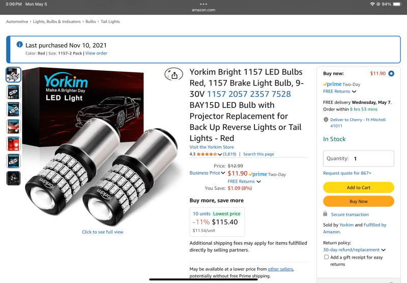

Everyone that followed me complained about my dim brake lights. I tried some red LED’s from Classic Industries, and they didn’t make any difference. Purchased a pair of red Holley Retrobrights LED’s, made a huge improvement in brightness. Glad I did it, Greg.
I put Yorkim brand off Amazon in for my 69 GTX and they are 3x as bright, which is what they claimed they’d be. I was able to see it in my garage in a back to back test. Absolutely tremendous increase in brightness. First trip out I could tell the amp draw was way less too. Has to be the easiest upgrade I’ve ever done to an old car.
They didn’t mess up the flashers either like I’ve seen said about some bulbs. I bought a set to put in the front turn signals too, haven’t done those yet.

Perhaps I am reading it wrong, but the description of this brake light needs a resistor if it is a turn signal bulb like my car has. My car has only two separate lights out back. Both the turn signal and brake functions are in the same bulb. Am I wrong?
No resistor needed. It’s a direct drop in for an 1157.
