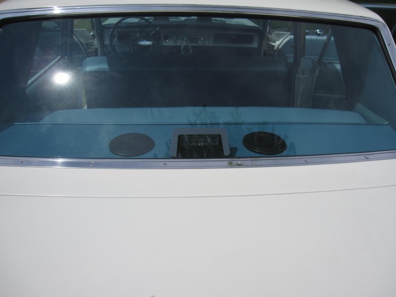

No resistance wire on tail lights.
The only resistance wire used on Mopars as far I know is the low speed for rear blower deffog. And this was up to 69.
The dimming function between parking lights and brake lights is the resistance value of the filaments itself, but still both filaments get 12~14 volts
