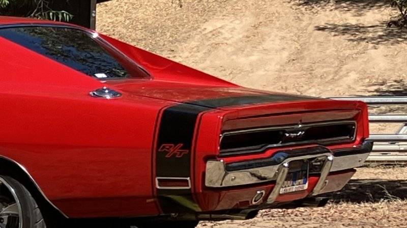

The 1969-70 Chargers had tucked in lenses that look dark until they are lit up. My taillights seem bright enough here:
It seems like the brake lights should be about twice as bright as the taillights but for me, that isn’t the case. Are LEDs the only way to improve this?

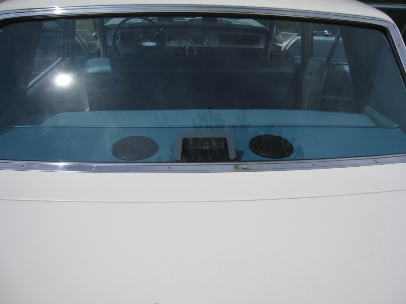

I have added a 3rd brake lamp to both of my 65s. I bought Hella brand (LED). Anything to get cell users to notice! Pay no attention to the tree in the reflection.
